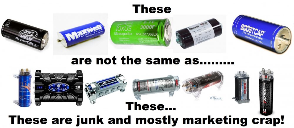

audiofanaticz Posted August 26, 2017 Report Posted August 26, 2017 The caps Steve is using inside a battery case, or the single style of caps people buy and make their own banks of are 2 completely different things..
06RTCharger Posted August 26, 2017 Author Report Posted August 26, 2017 18 minutes ago, audiofanaticz said: The caps Steve is using inside a battery case, or the single style of caps people buy and make their own banks of are 2 completely different things.. Do u think using a xs supercap bank with one regular starting battery is a good setup with my 240 mechman? Considering my amps and my regular fuctions of the car that will draw power. Or does it make more sense to have more batteries per supercapbank?
