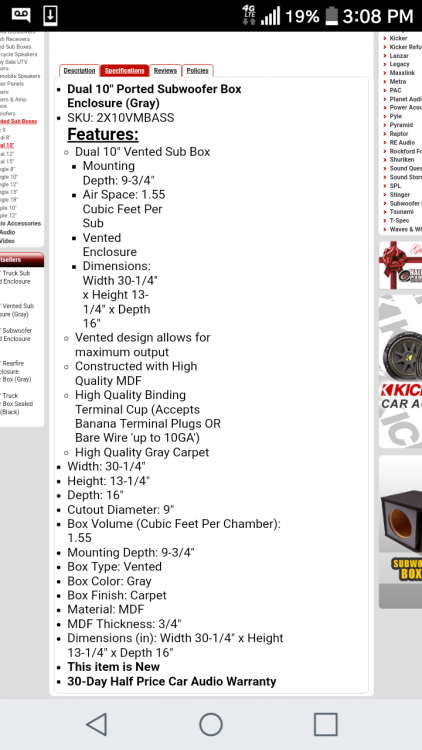

Regardless of what speaker your choose, if you are really determined to to play that low, you are going to need to build your own box or have someone build one for you.  Your tuning needs to be 20 - 25 or we are back to unloading again.
You want tight punchy bass and be able to play 20hz just as loud too? From small subs? How much power are you going to run? This is not easy to do and will take a lot of power (at least several kilowatts). I am willing to bet that you won't get there with a pre fab box. The ports will be too small and tuned too high. Forget the conclusions you have come to about T/S parameters. Winisd will tell you what you need to know about what you are trying to do. Don't get too hung up on punchy bass from the sub, the upper bass should come from the door speakers. With proper sound deadening and enough power, the doors should have plenty of upper bass. I would look into DC, Fi, AA, and Soundqubed. They all have subs that won't bottom out.
