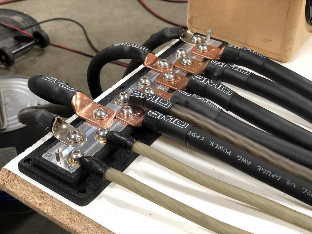

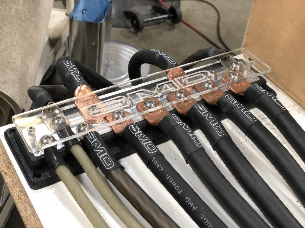

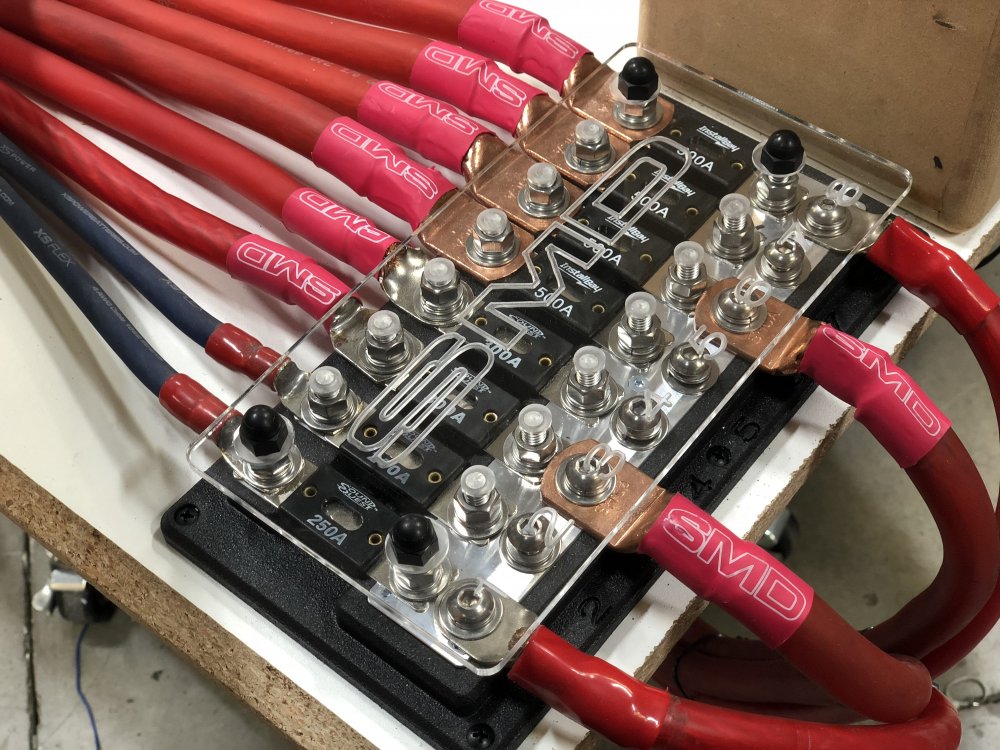

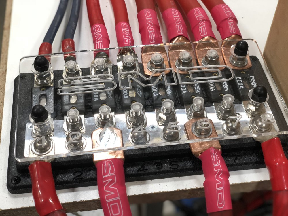

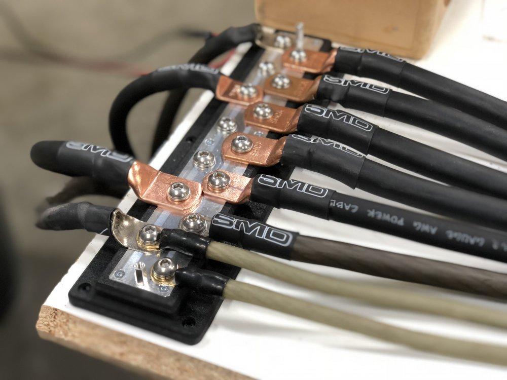

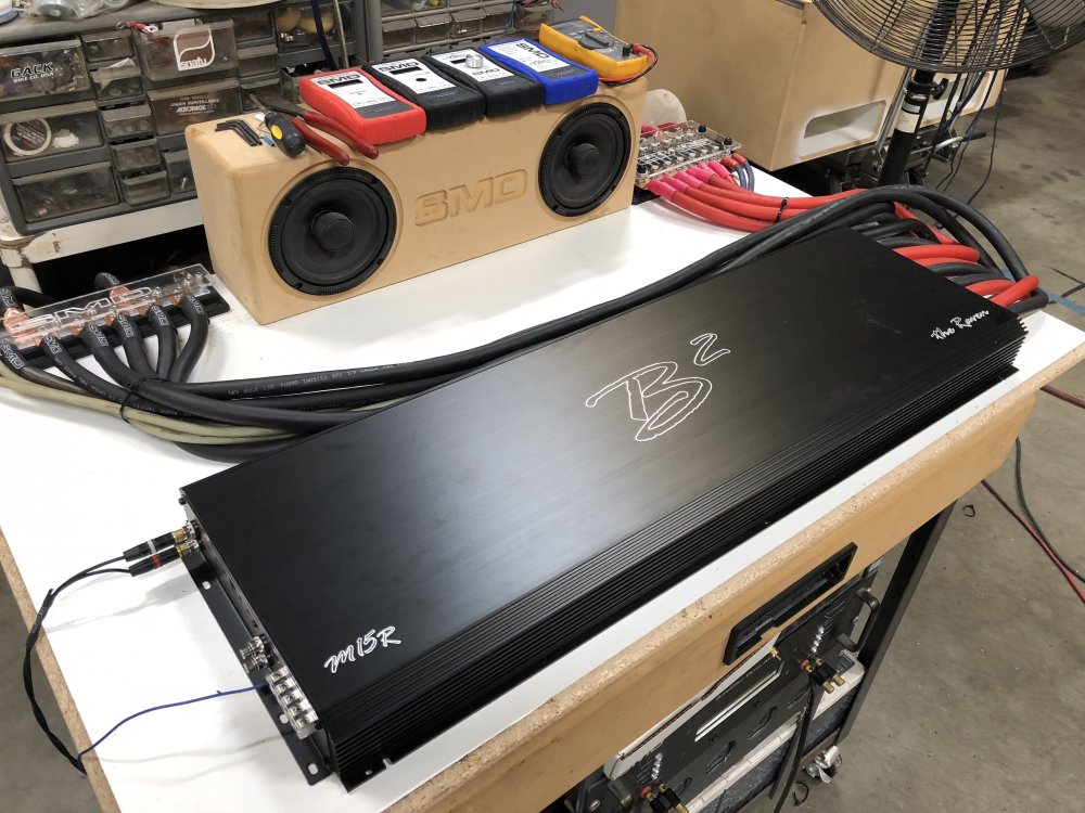

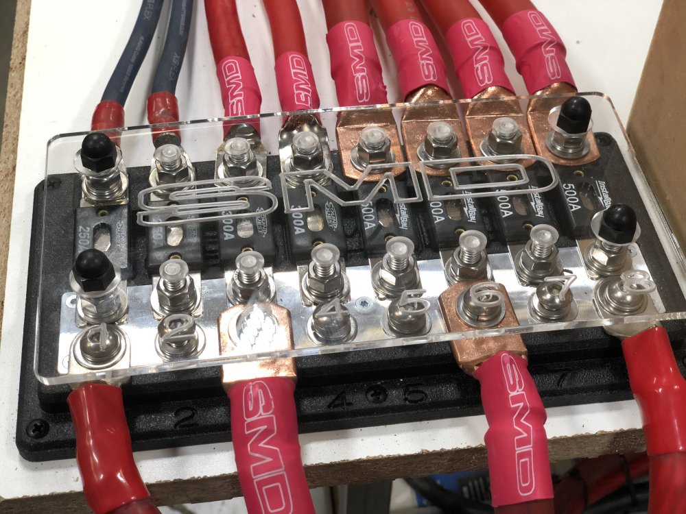

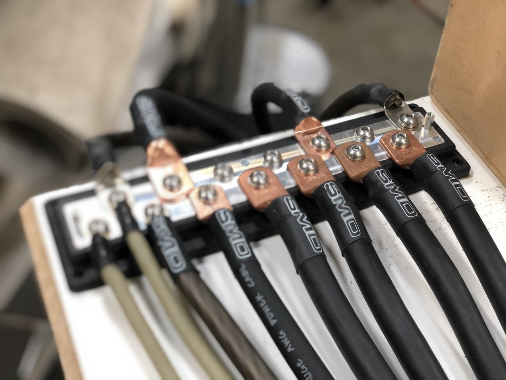

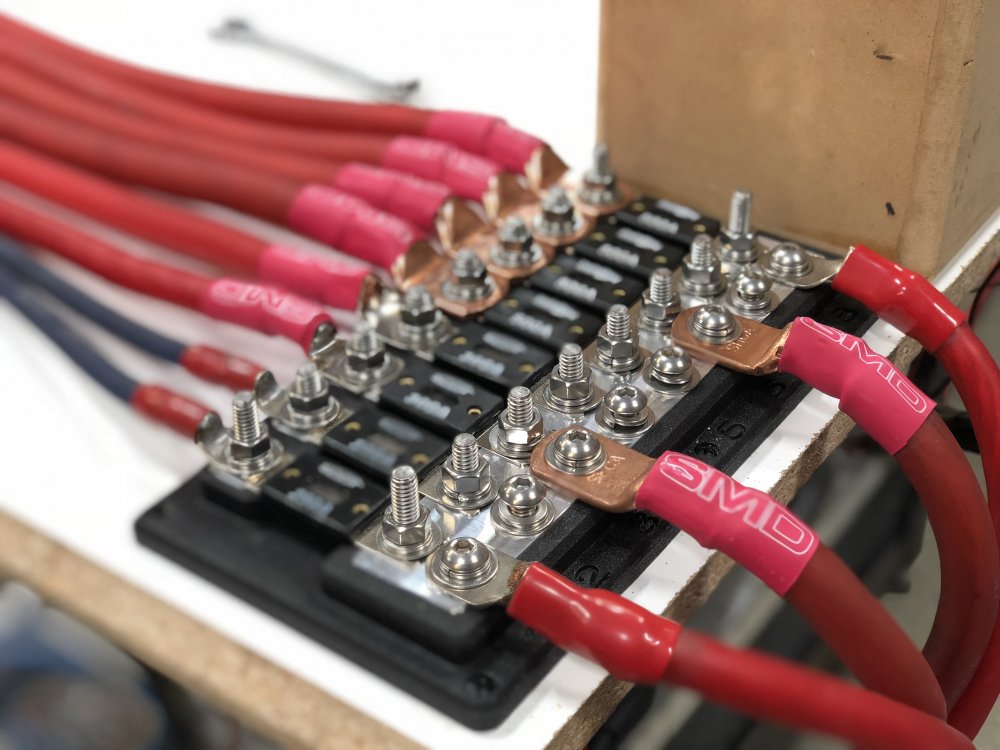

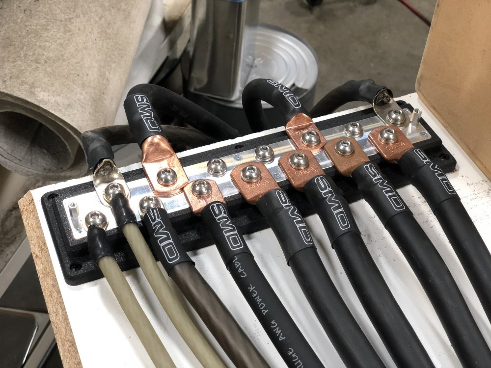

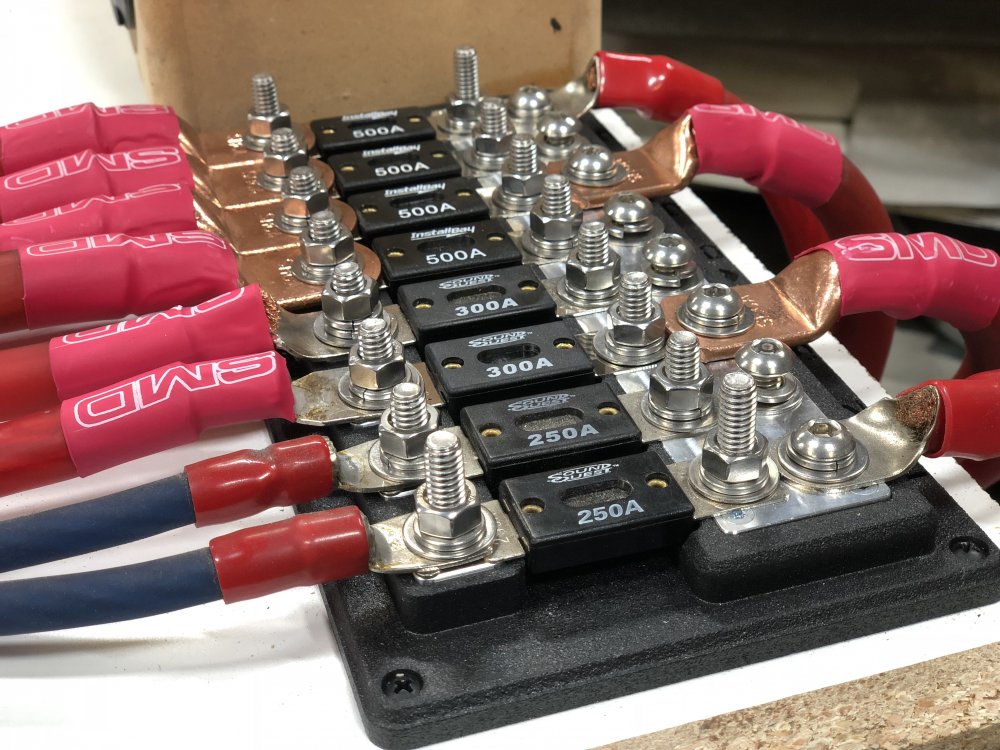

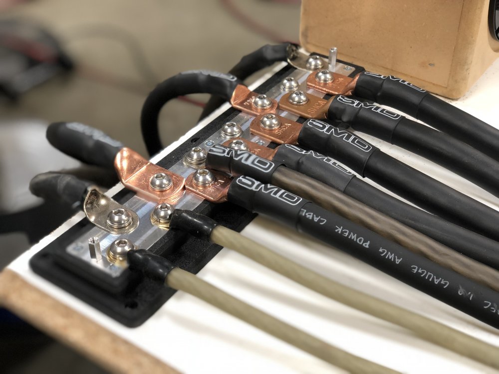

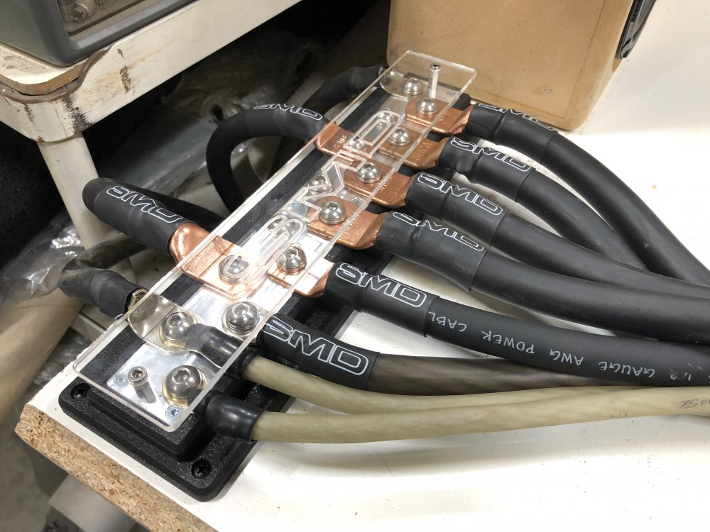

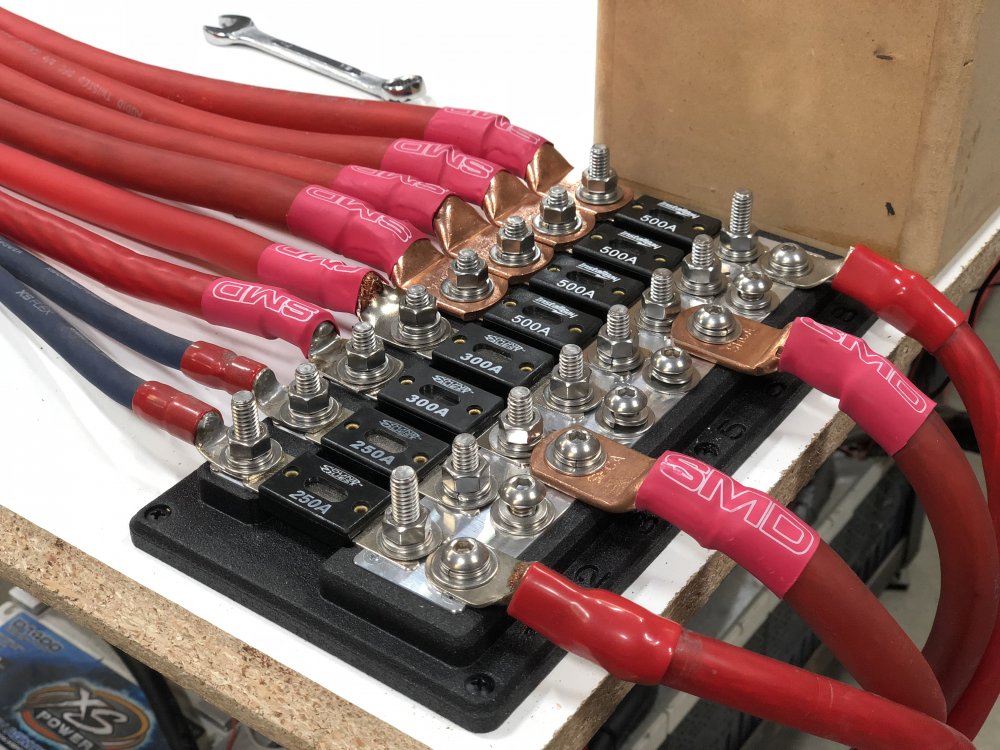

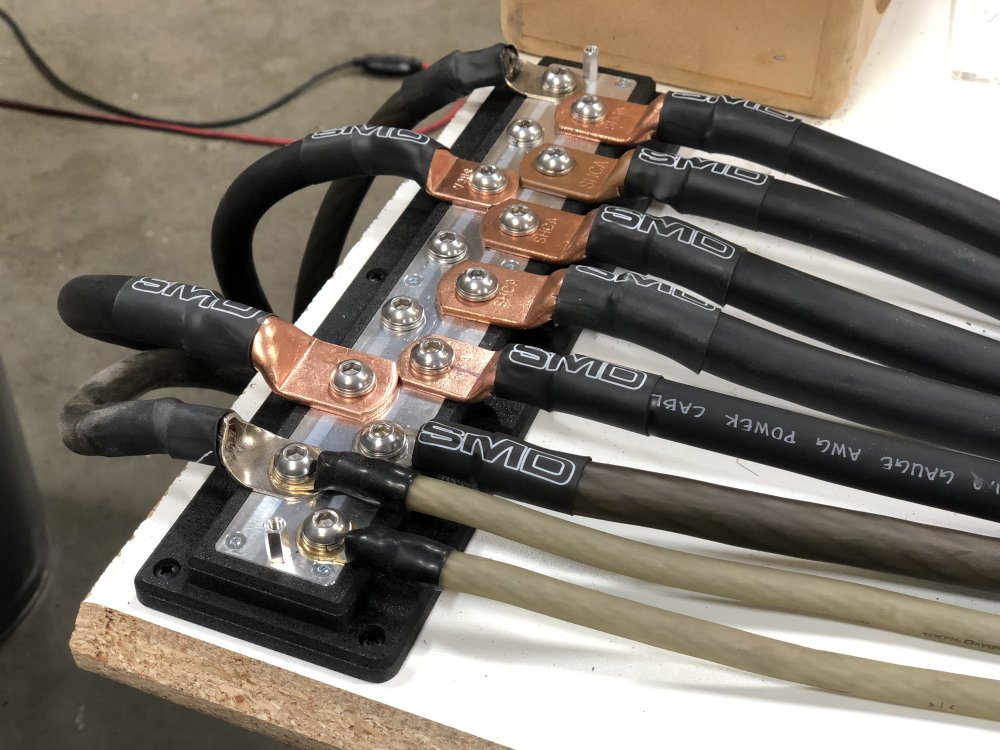

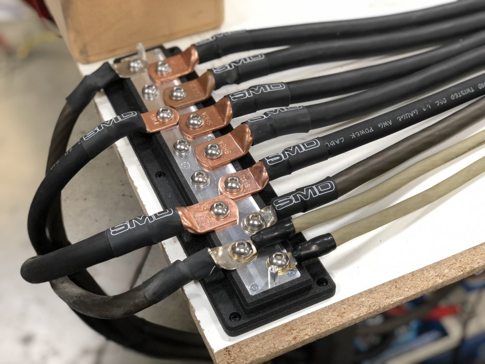

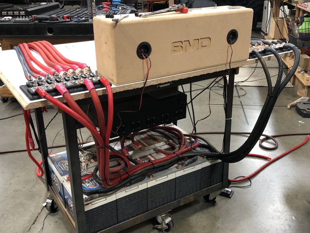

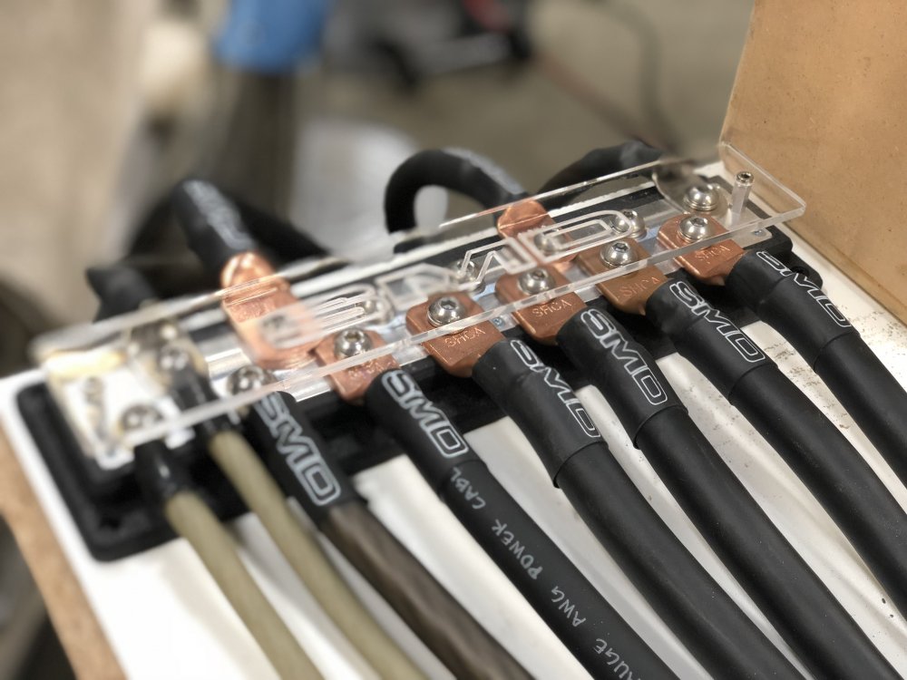

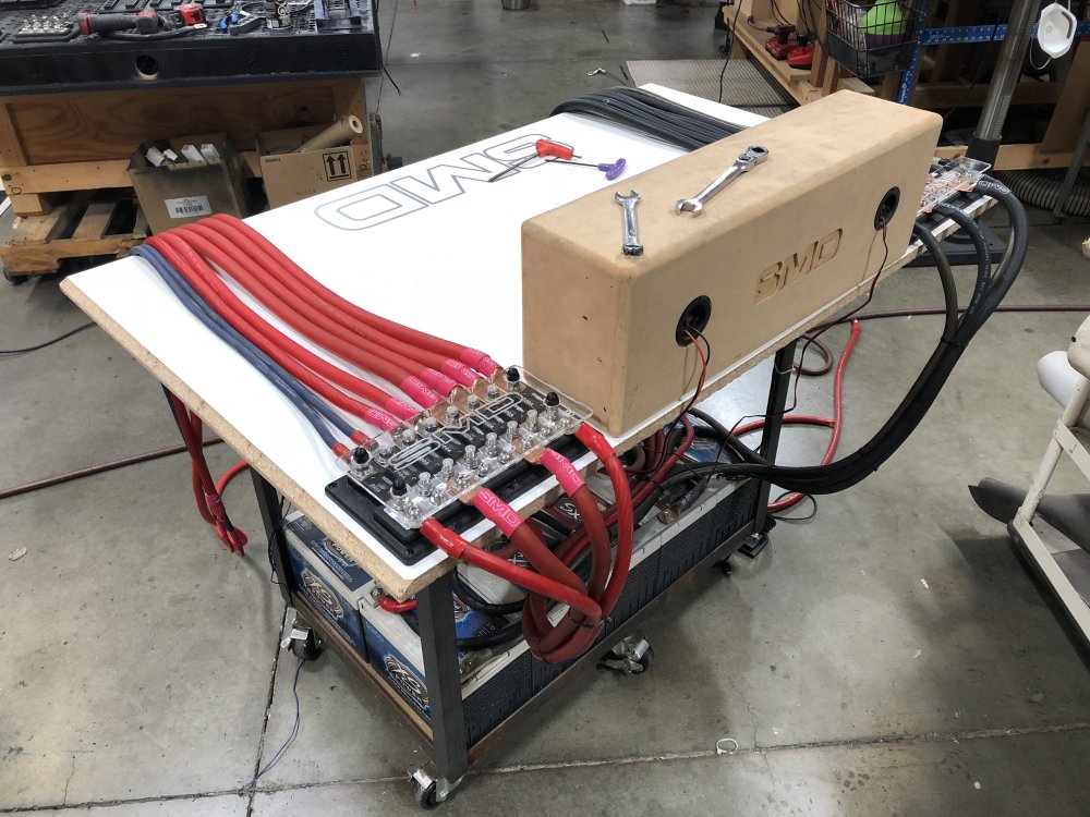

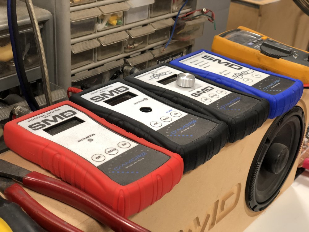

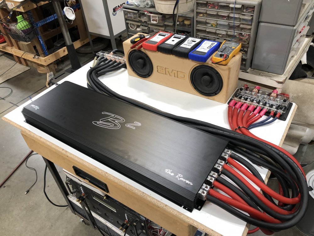

Getting ready to bench test the B2 Audio Raven and it is one of many amps that have shown up at my shop that are way to big for my bench, physically.  So i decided to add a Melamine top with some extra real estate on it.  I also have had a few amps that have multiple 1/0 inputs (power and ground).  This B2 Audio Raven has 4+ and 4-.  I decided one easy way to accommodate that is with an SMD Octo XL fuse holder and matching distro bar.  It gave me all i needed and then some.  Of course i added some 4ga wiring for the smaller amps.  I ended up running 2 additional and GIGANTIC Skyhigh Car Audio wires (on the input side) down to the battery bank for a total of (2) 2/0 and (2) 1/0 Pos and Neg on each side.  I am using 10 XS Power D1400 Batteries and i use an XS Power PCM-60 for a charger in between dyno runs or for a power supply when i am testing a new subwoofer enclosure out in the shop.
Anyhow, here are the pics.  Expect to see more testing soon!  The B2 Audio Raven is just about ready to go!
