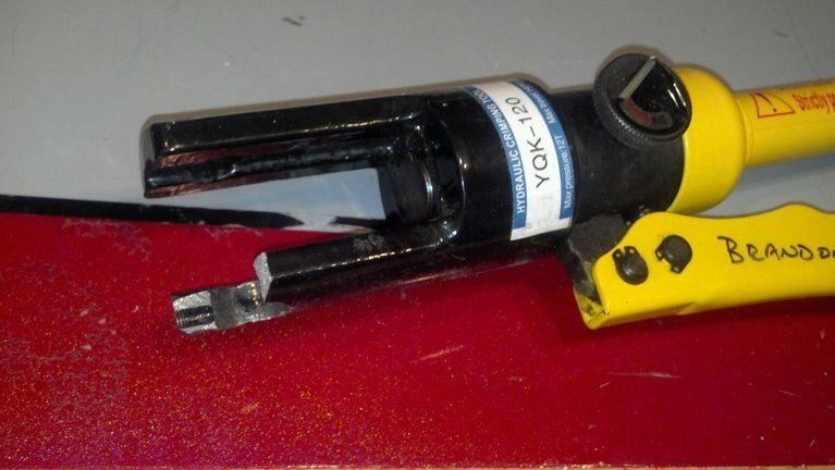

My ebay 8 ton has done me good with the 3-4 dozen crimps i've used it for over the past few years. Definitely paid for itself by now, paid $80 CAD IIRC shipped from China.
The largest die's work (70mm?) with the SHCA 2/0 ring terminals, i do one pass in the horizontal plane just not quite at 100% to avoid the elephant ears extruded look then i flip it 90* and finish the job in the vertical plane.
Just can't over do it though, you can see the deflection in the jaw of mine from pushing a little to hard.

Looks like a decent crimper build wise due to the head where the dies go.
Some of the ebay ones are built poorly and if you use it regularly theres a good chance that it may break someday down the road due to how thin the material is that you are pushing 12 tons of pressure against like this.
For over sized 1/0 car audio wire it is technically 2/0 you should be using the 70mm2 dies.
Sky high 2/0 is over sized buy its not quite 4/0 and you should use 95mm2 die or there about.
Thats why your getting wings on your terminals if you go all the way. Personally id crimp them all the way and just file the wings off.
Or go on the hunt for a die set that offers a larger size, you can sometime buy the dies separately.
