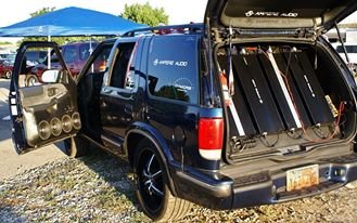

Cock box is mounted bottom left in pic. One chan IN, 4 OUT (sub stage)
11822780_1096110303750816_6093682273493856943_n.jpg.b99871089ea4ae6c61e2cef154233fd7.jpg

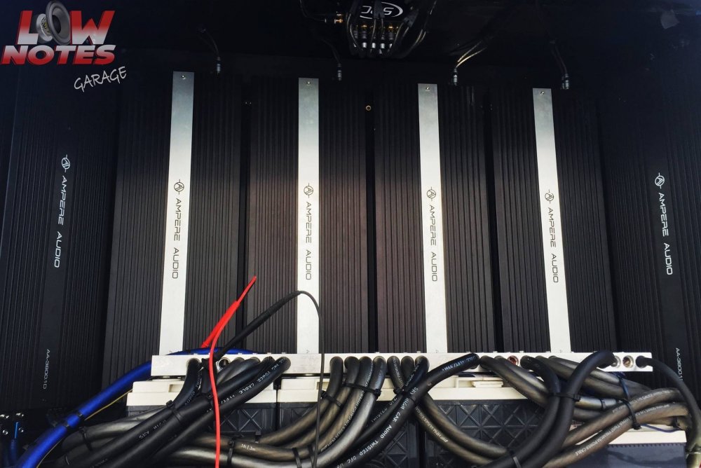

Up top on the roof. One chan IN, 6 OUT (sub stage)
13119818_1258297347532110_6386362647377603307_o.thumb.jpg.c139a0562c4d8671a7e663c34c79fbce.jpg
