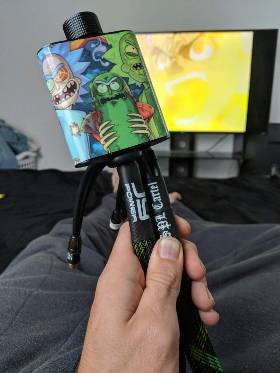

Kyblack76 Posted August 7, 2018 Report Posted August 7, 2018 21 minutes ago, Broke_Audio_Addict said: Pac Lc-1 You're welcome. This. I wouldn't use any knob the board uses, get a rca line in type unit like the PAC broke suggested. There is some high zoot/custom types, like those made from SPL CARTEL and such/others. We have run, and run now the same in all our rigs. Wouldnt be caught dead with out it tbh, in any of my builds. Like that, but they do the same,.. adjust level. That's the direction I do go, and would if I was in your place, for what you want. SMD SUPER SELLER The Burban Build Blazer Build sold Acura trunk build sold
