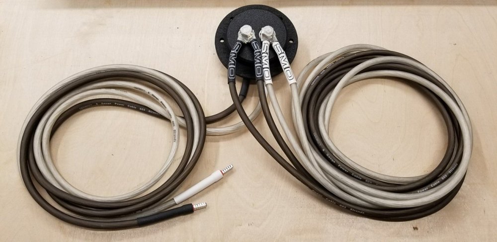

audiofanaticz Posted December 11, 2018 Report Posted December 11, 2018 The chances of most people exceeding the AC voltage/amperage limit of a 8 awg wire is highly unlikely so stepping down to a smaller size is fine. If you must run 8 awg wire then do multiple runs from the terminal cup or amp so you dont have to make wire fit when your trying to daisy chain from 1 speaker terminal to another. Like so then each coil has its own pair of wires:
