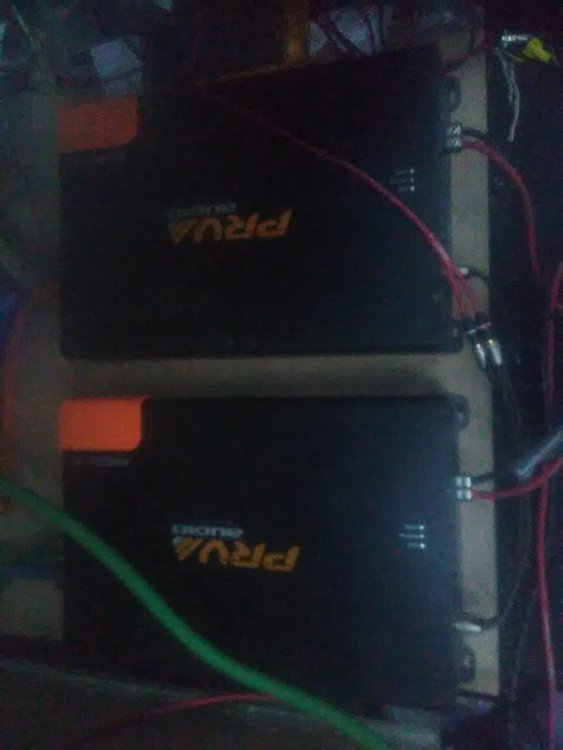

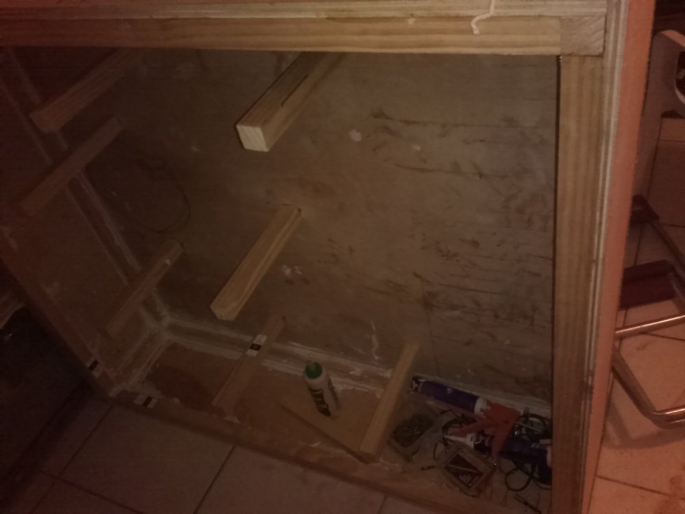

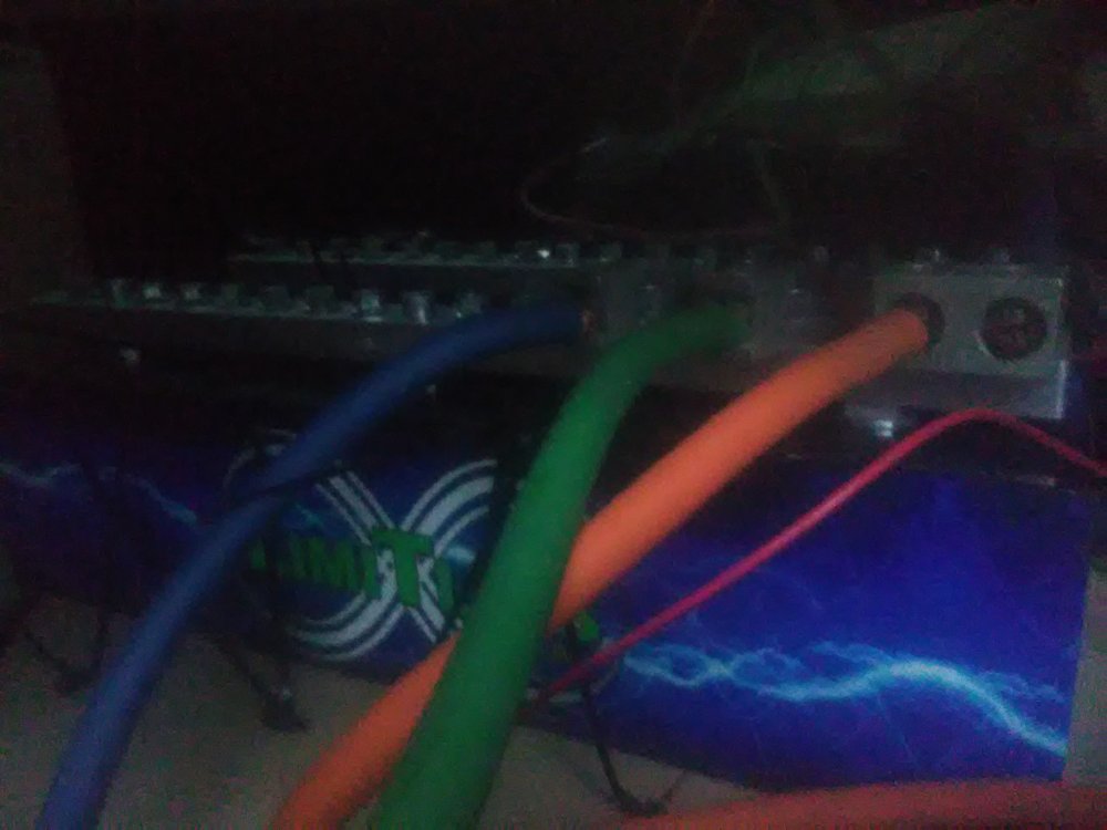

BMS Posted January 20, 2019 Report Posted January 20, 2019 So i have a spl lab mini and i was wondering if my setup is on par? I have 6X pap 2k 12's. and 2X prv ad8000.2's. This is a box not a wall. I have no sound deadener. And i hit a max of 154.7 db at 26 hz. if i stay in the frequency range of 21-34 i can stay in the 150s. if the song is a solid bassline for 3 or so minutes by the end of a song playing at about 153 db ill start to smell the coils of the subs. There is no clipping according to the clip indicator set for 1% thd. Do you feel this is on par? ill give extra details about my system now. 2.5 cu ft. per sub. box tuned to 28 hz port area 260 in^2. 1X 350 amp alternator. 1X limitless lithium 100ah. 1/0 ofc. The subs have a 4'' 8 layer coil rated at a "conservative" 2000 watts rms per sub. port faces front. db ratings are off the windshield.

BMS Posted January 20, 2019 Author Report Posted January 20, 2019 No really i was asking if it is no par because 6 12's is a lot and i dont know what i should meter considering i usually like to play in the 20's i could put some pics but its an ugly install i only care about bass. it's just i hear a lot of scores thrown around that are higher than mine with less but they are usually at higher frequencies and my frequency range and for lack of better words stamina seems low.

BMS Posted January 21, 2019 Author Report Posted January 21, 2019 random pic of my box when it was half built.
