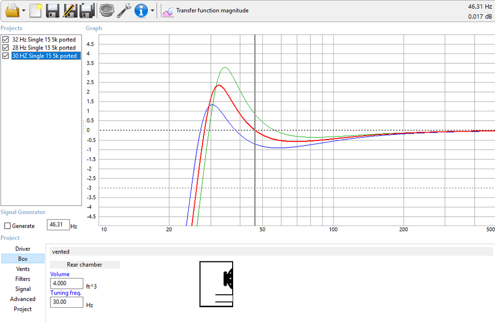

Smoove Posted April 4, 2019 Report Posted April 4, 2019 1 hour ago, Joshdashef said: Sorry misread that! I'll look at it in WinISD with a tune of 28. SSF at 22 won't damage it will it? 22hz is "close enough" to a half octive below tuning. I do like that you're actually looking at SSF settings and not saying you wanna play 16hz while tuned 32. People who do that crack me up when they kill a sub and blame the manufacturer. 2 Team Fi 15's v1 2 DD M5's 970amps of Alt 6th order blowthroughThe truck Blowthrough build : http://www.stevemeadedesigns.com/board/topic/155555-smooves-1996-chevy-ext-cab-c1500-slow-build/The 350z build : http://www.stevemeadedesigns.com/board/topic/170694-smooves-2003-nissan-350z/ My FB page https://www.facebook.com/pages/Smooves-Car-Audio-and-performance/719746144805343 Team Fi Audio http://www.ficaraudio.com/
Joshdashef Posted April 4, 2019 Author Report Posted April 4, 2019 14 minutes ago, Smoove said: 22hz is "close enough" to a half octive below tuning. I do like that you're actually looking at SSF settings and not saying you wanna play 16hz while tuned 32. People who do that crack me up when they kill a sub and blame the manufacturer. haha humans can only hear what 20 Hz anyways? sure you could feel below that I guess but I like to hear my music as a human not a cyborg. I plotted up 28 Hz vs. 32 Hz and it looks like the peaks for 28 Hz has 1.3 db @ 30 Hz. and 32 Hz has 3.28 db @ 34 Hz. 30 Hz looks like it gives the best of both worlds. Peak is inbetween both, f3 of about 26 Hz, and 46 Hz at 0 db. In the real world, how do these numbers effect daily musical listening. I'm not chasing numbers or competing but I do have a meter to test SPL for shits and giggles. Port area is 14.5" x 4.5" (65.25in^2) for all of these, Length of port for tuning is as follows in inches: (Blue) 28Hz - 49.17, (Red) 30 Hz - 41.97, (Green) 32 Hz - 36.08 SMD Tool Map (2024): https://www.stevemeadedesigns.com/board/topic/226545-smd-tool-map-2024/ Great Box Bracing Examples: https://www.stevemeadedesigns.com/board/topic/202148-best-way-to-brace-a-box/?do=findComment&comment=3055002
Smoove Posted April 4, 2019 Report Posted April 4, 2019 chances are, on music you may not hear a difference between 28-32 unless you are digging for low 20's. sound like you'd be happy 30hz with the SSF set at like 24hz. I personally dont use my SSF, I just watch what I play, I usually just try to play 24 and up. 2 Team Fi 15's v1 2 DD M5's 970amps of Alt 6th order blowthroughThe truck Blowthrough build : http://www.stevemeadedesigns.com/board/topic/155555-smooves-1996-chevy-ext-cab-c1500-slow-build/The 350z build : http://www.stevemeadedesigns.com/board/topic/170694-smooves-2003-nissan-350z/ My FB page https://www.facebook.com/pages/Smooves-Car-Audio-and-performance/719746144805343 Team Fi Audio http://www.ficaraudio.com/
