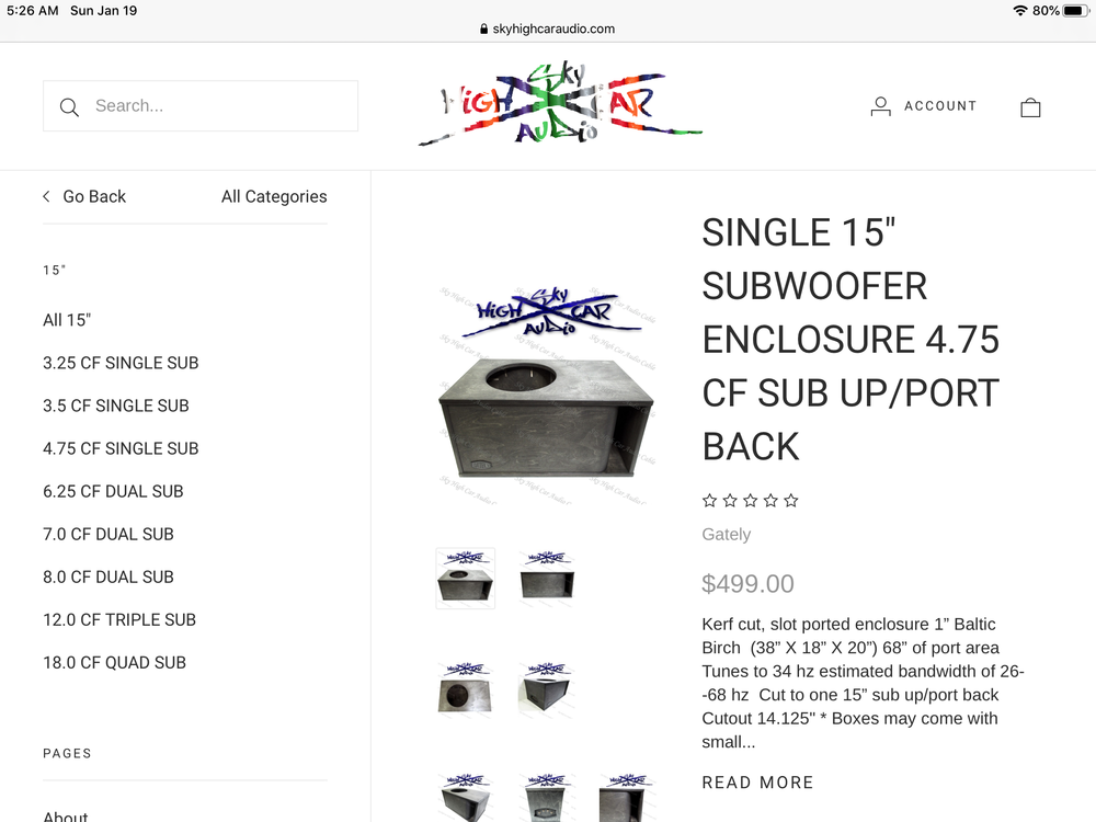

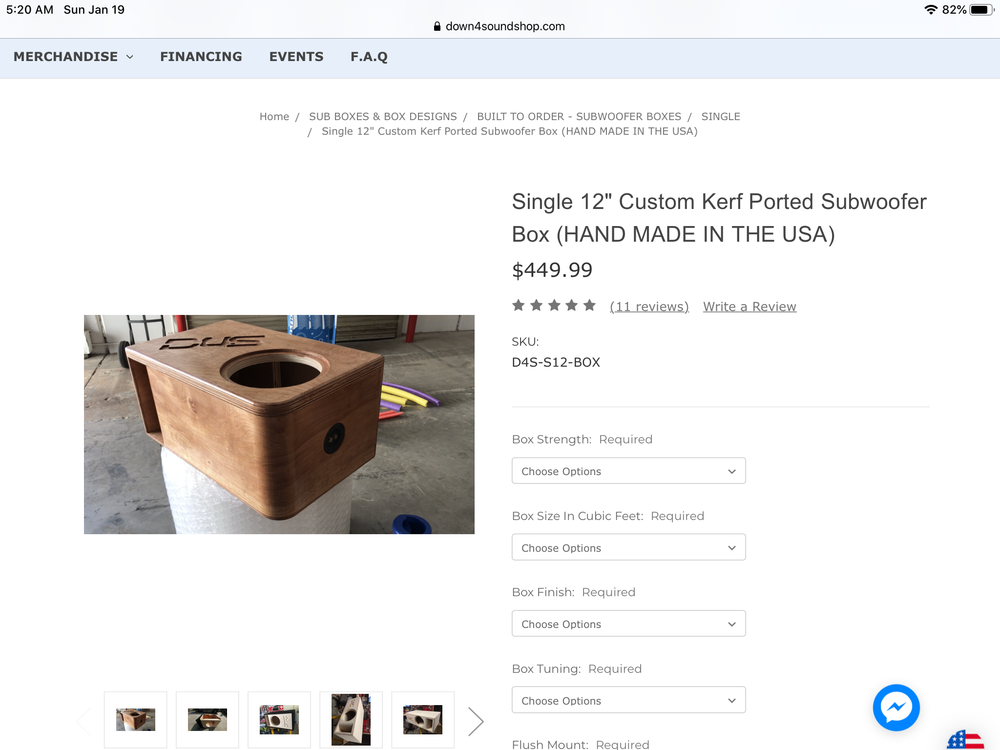

Don’t think that’s all that bad , they could have painted it . It is a custom box here’s some you can buy online granted they are more popular people. And for hair tricks don’t think so maybe if it was in a Smart car. You have to remember a lot of the guys on this site build there own boxes even me and wood , screws and glue is cheap but the tools are expensive and need to be paid for plus experience. I like the bracing and the box looks clean as for sound if it doesn’t sound right bring it back. Those speaker wires do look like 18gauge. Lol

honestly the price you paid is pretty close to what should be charged for what you would have got. however there are things I question about the build as well as the "windy" and "hair trick" promise. the cuts seem to not be from a jigsaw for the sub woofer cut out. the internal bracing doesn't have rounded edges. where the joints are, there is no seal from either wood glue, silicone, or caulk. as for the windy part, they should be able to show you a box design with port velocity. for the hair trick part, that's a promise too far considering it's a single 15. while it's more common to see a hair trick on 5k, it's not so common to do a hair trick on a single 15. also a hair trick is what in this promise?, i'm thinking making a chic look like Medusa not the tips of a girls hair raise up a little.

In my opinion you paid a fair price for what you got but the builder should have never promised hair tricks. No one really knows what it'll do until its built and playing.
