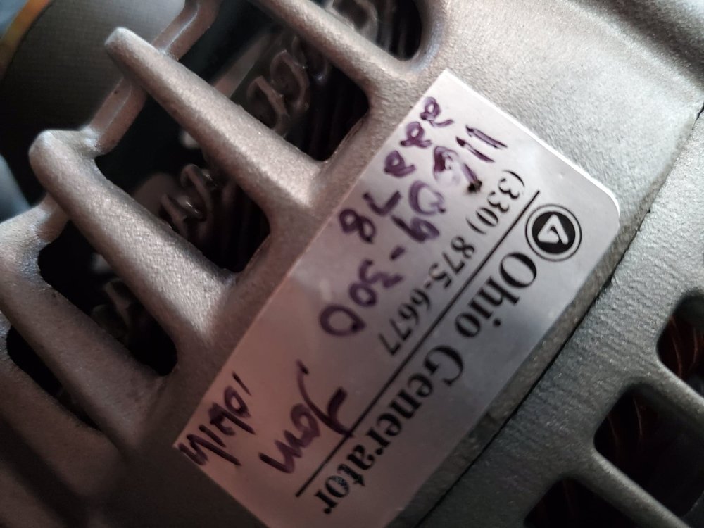

Kyblack76 Posted February 2, 2020 Report Posted February 2, 2020 What alt maker ?? Looks like its spiking. My old ass singer use to do that. It would also protect my RF amps. SMD SUPER SELLER The Burban Build Blazer Build sold Acura trunk build sold
