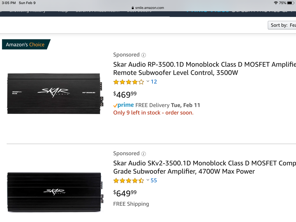

Yeah the Skar 3500 is over 5 so I think I rather get something else or a better name brand. Nothing wronf with that Skar but I would go with something better in that price range
