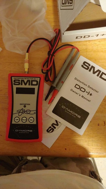

AaronT Posted May 18, 2020 Report Posted May 18, 2020 On 4/27/2020 at 3:50 PM, MrSkippyJ said: agreed, I would still use a DD-1 for everything upstream of the amps though. Definitely Just upgraded to dd1+
