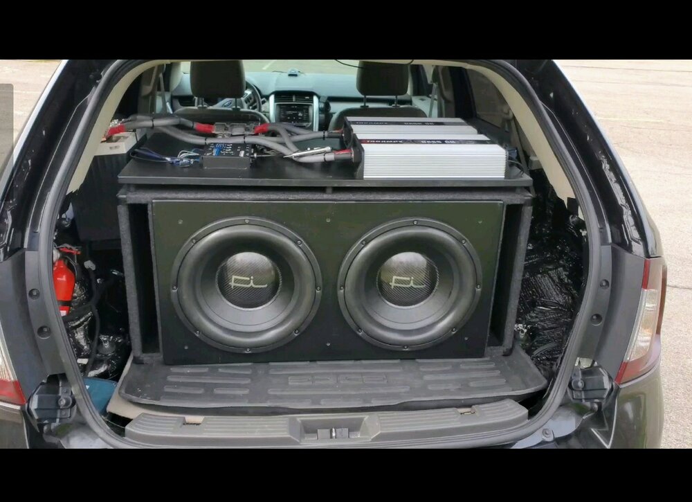

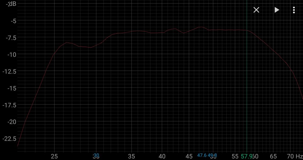

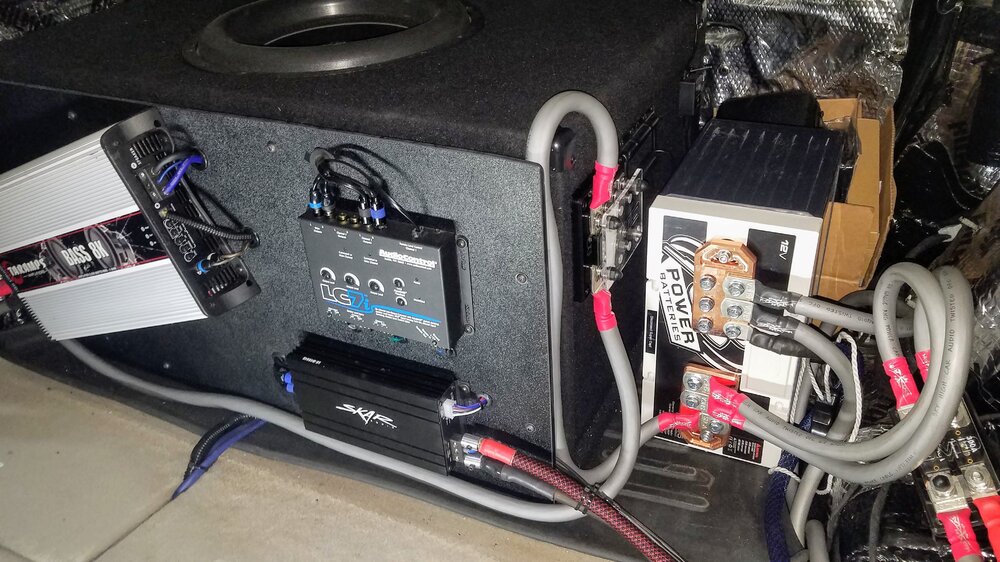

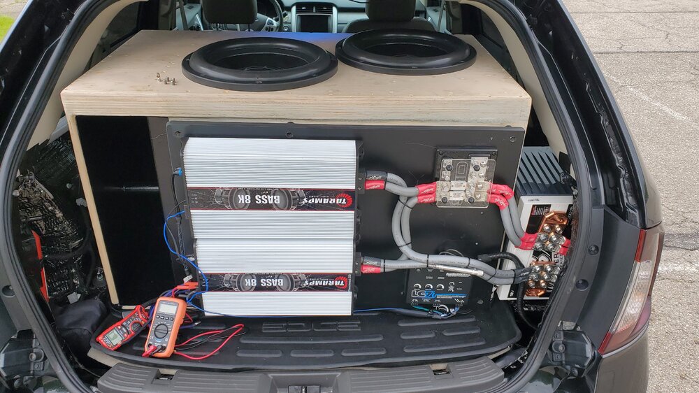

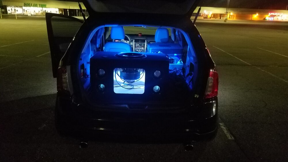

I agree with the original statement, something about why the [big/pro manufacturers like SunDown, Deaf Bonce, Fi, PSI, Crossfire, DC, etc] don't use average clamp numbers as their rated power for pairing amps with subs. My Taramps Bass 8K 1-ohm @ 1-ohm clamps 4K, 50% of it's rated power. Typical is somewhere around 40% of rated power. However, I have my amp to output only 5K and yet clamps 4K (actually just shy of 4K, like 100 watts shy) I used -5dB tone of it's peak freq of 43 Hz. One D2 DVC sub 5K RMS. My amp is set to put out 100V which equals 5K at volume notch 3 (3 out of 8 notches because beyond 3 is slight clipping on my factory 8" t/s head unit). (currently is a Skar DNR 15" D2) My box is tuned to clearly play music freqs between 27Hz and 55Hz well. I'm about to sell this set-up because I bought a new set-up I'm prepping to install. 2 15" D2 Fi Neo 4.11 released Nov 2020, each powered by it's own Taramps Bass 8K at 0.7 ohm which equals 20,000 RMS watts. Therefore I'm aiming to clamp 6K each sub if I can design this box to be as efficient as the last one (current one which has 4 aero ports and large plexiglass window). If it matters, 390a JS alt, 4 runs of 2/0 SHCA OFC, 3 SMD fuse blocks all with 500 a fuses, XS Power D3400 which is being replaced with XS Power's newest Bluetooth Managed Lithium Direct Fit Titan8+ 6500, and I my current set-ups newest addition is the $1,300 Super Bank of caps: SB1500-75 also by XS Power. Also use LC7i by Audio Control and some other stuff like 4 small coaxial door speakers and a 400.4 amp to push them, 8" factory touchscreen in my Ford Edge. Lmk if anyone is interested in knowing the exact numbers I had in order to come up with what I clamped. If in doubt, ask. Don't assume.
