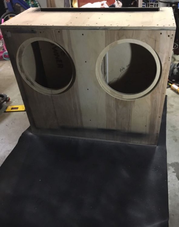

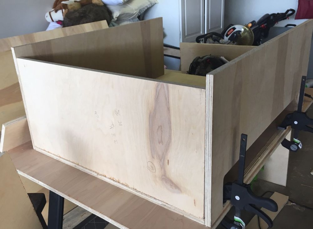

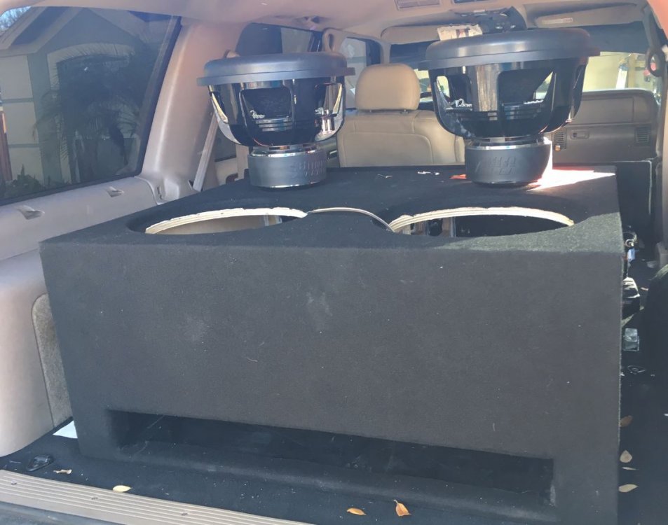

The port is 4 inches tall by 34 inches wide.
Here are some pics of the box it was designed by caraudiofabrication and set to be 32hz and 8.5 cubes.
btw i sanded and rounded pretty much every edge possible. So the crappy edges you see weren't that crappy when I carpeted it.
This is my first build so it was trick but I didn't have any friends available or interested in helping so it got a little heavy to move around lol.
