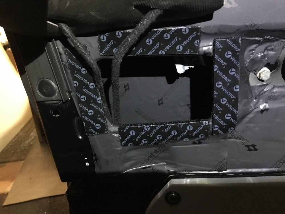

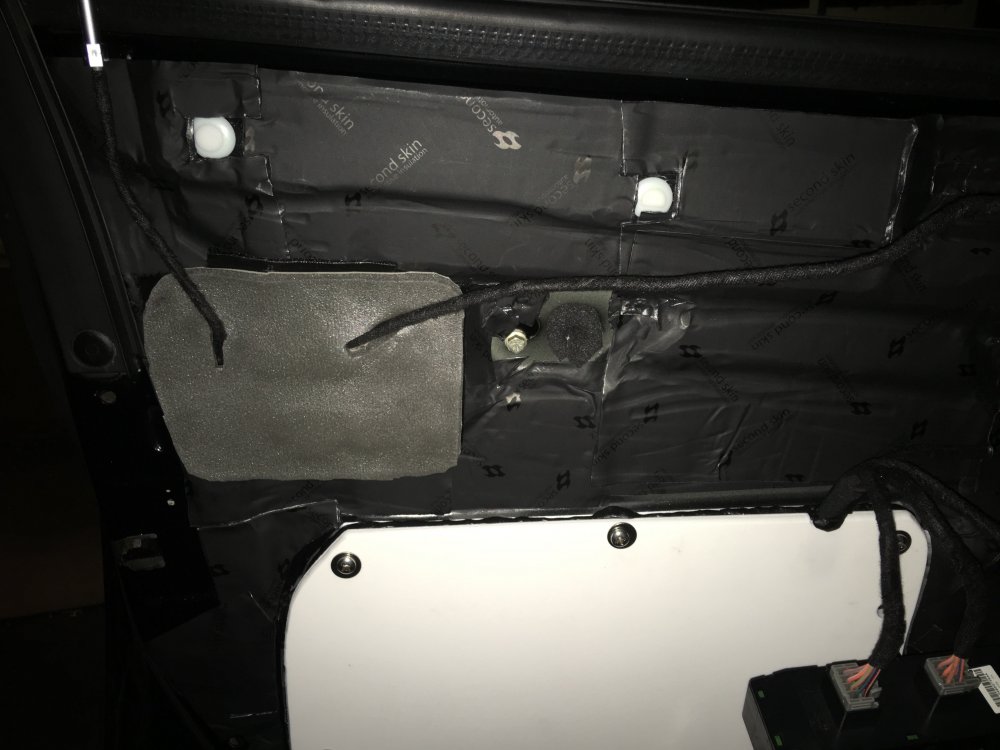

Made a better cover for the doors rods, the butyl rope was holding like i wanted so im trying some heavyduty velcro.
Stuck both sides of the velcro together. Then applied the strips in place. Then removed the other plastic backings and stuck down my luxpro cover i remade.
Everything was done, just reassembling the doors. Then this happened....

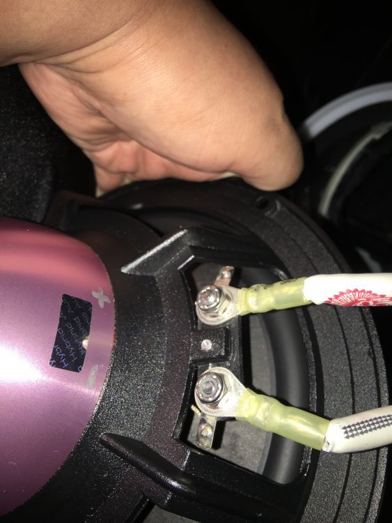

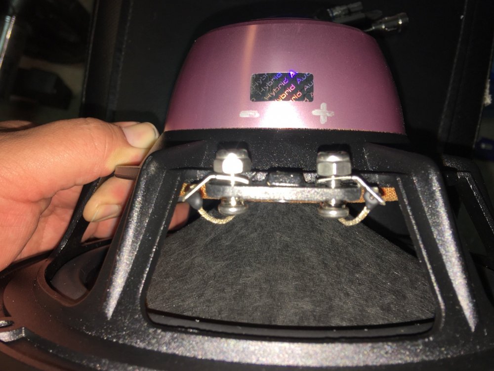

SMFH i wanted to turn the push terminals so that the holes are toward the sides instead of straight back. Loosened them and put them the direction i wanted, last one i tighten down and SNAP the fkn bolt on the push terminal snaps. Reminded me of breaking the bolt on my radiator hose lmao FK some shit always has to go wrong,

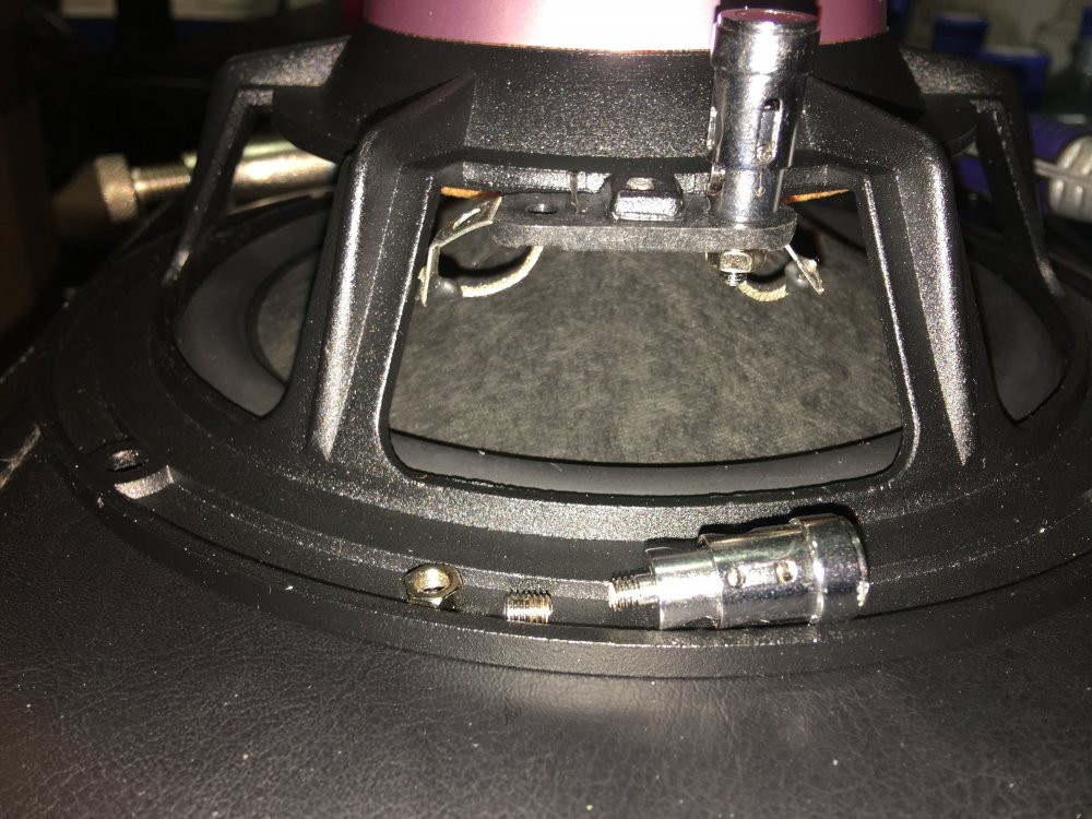

didnt piss and moan too long, got to thinking how i can make it work right now. Too scared to solder directly to the leads. This is what i came up with.
Luckily i had bolts thin enough to fit the same hole. Also i just bought nylon locking nuts for those bolts earlier today so that worked out.
Pulled my wire ferrules off with pliers and crimped on some ring terminals i had already.

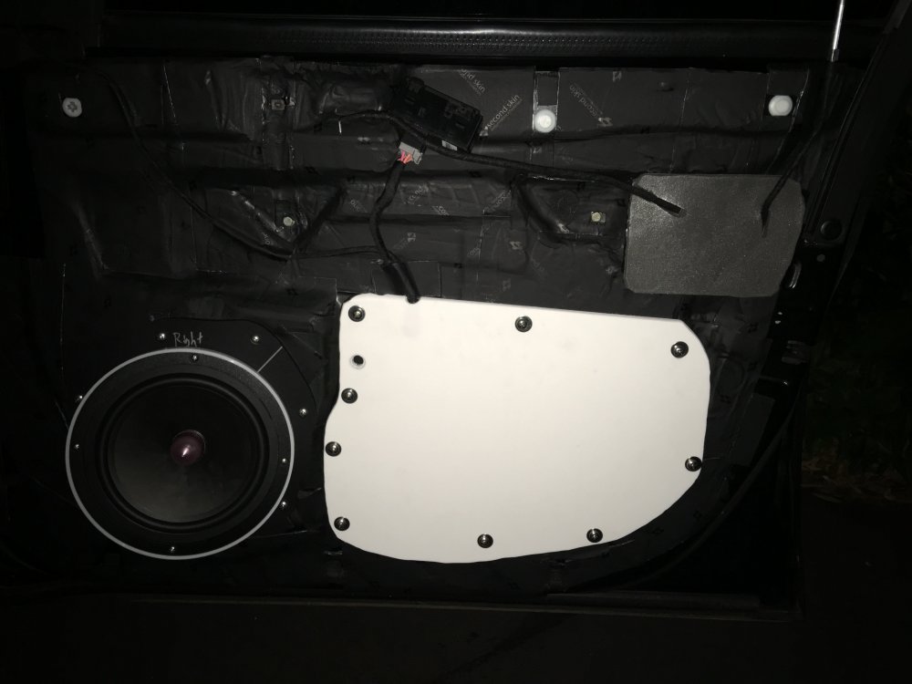

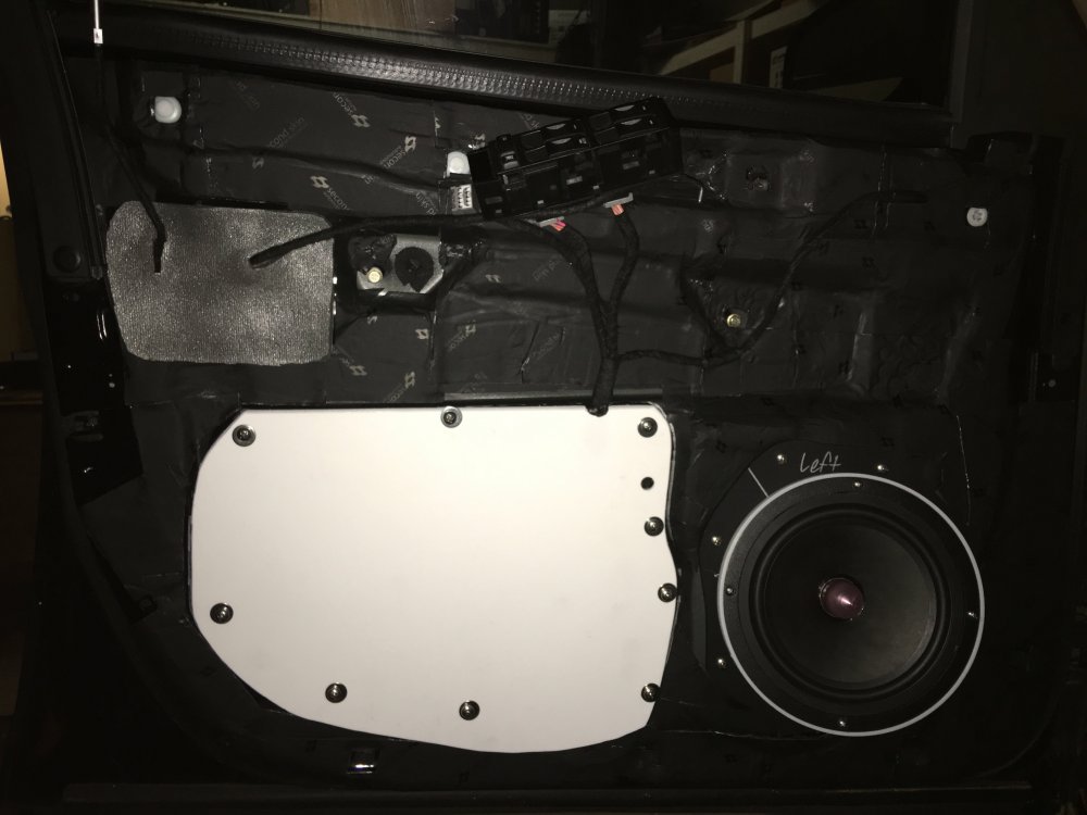

DONE completly sealing and deadening as much as possible.
Passenger door.
Driver door.
sounds way better now. Just did some tuning and messing around with settings. Now the L8SE is starting to get impressive lol just need to tinker with it more and figure out how to go about creating an EQ.

You can buy those spring terminals like that on ebay pretty cheap but it looks like wat u did is solid. I like the look of it more than the spring terminals anyways.  Doors look solid af bro. Nice work.
Thanks man. Ill probably redo the terminals some how, just didnt wanna deal with it for too long. Just wanted it all back together and get to fully hear it play.
