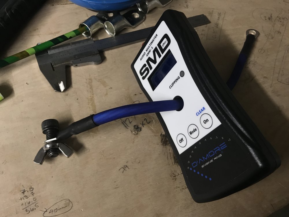

My speaker lugs couldnt fit thru the AMM-1, so i made a 4 AWG jumper that just stays in the AMM-1. Threw a M8 bolt in one end with a wingnut. Now i just need to find a place where i can play full tilt for a good 30min or so to take a bunch of data and get familiarized with it.
This one has version 3.8 software, but Tony D recommends 3.93.  After the first round of testing im sending it in for an update and then i'll redo the same tests to see if it made a difference.

AMM-1 is for sure one tool I wish I had.
