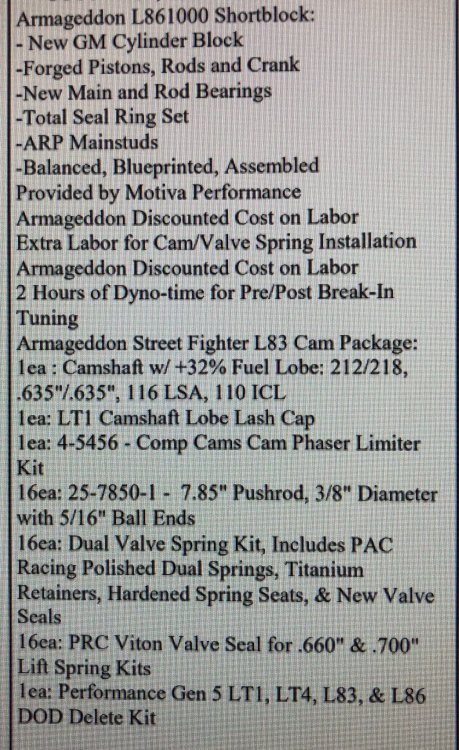

Most of the parts are listed here...although there is some stuff that we added on after this. Oh and it is on all 4's and FINISHED! Waiting to find out when is a good time to fly out for dyno testing :D
