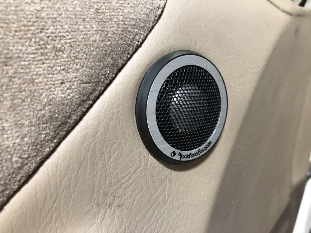

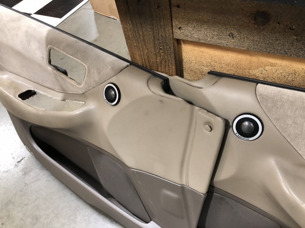

Ive always wanted to try these.  I wonder if they will make a difference :D

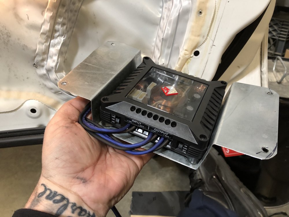

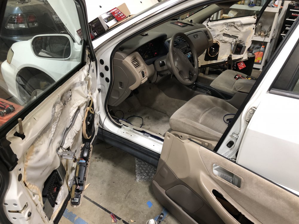

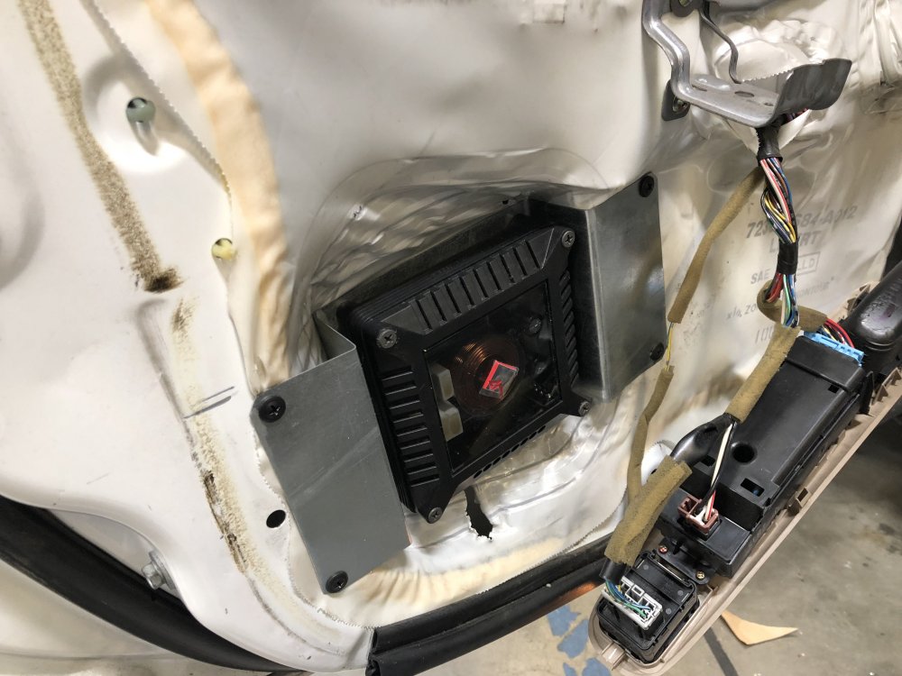

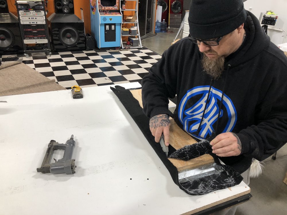

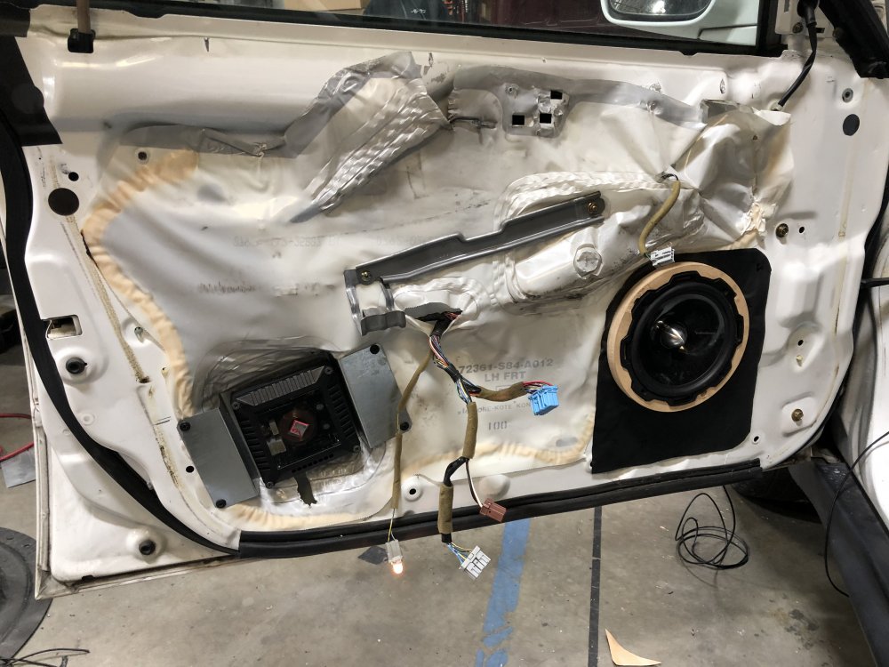

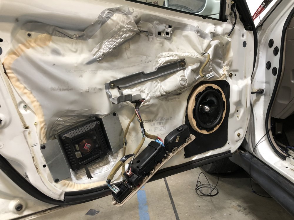

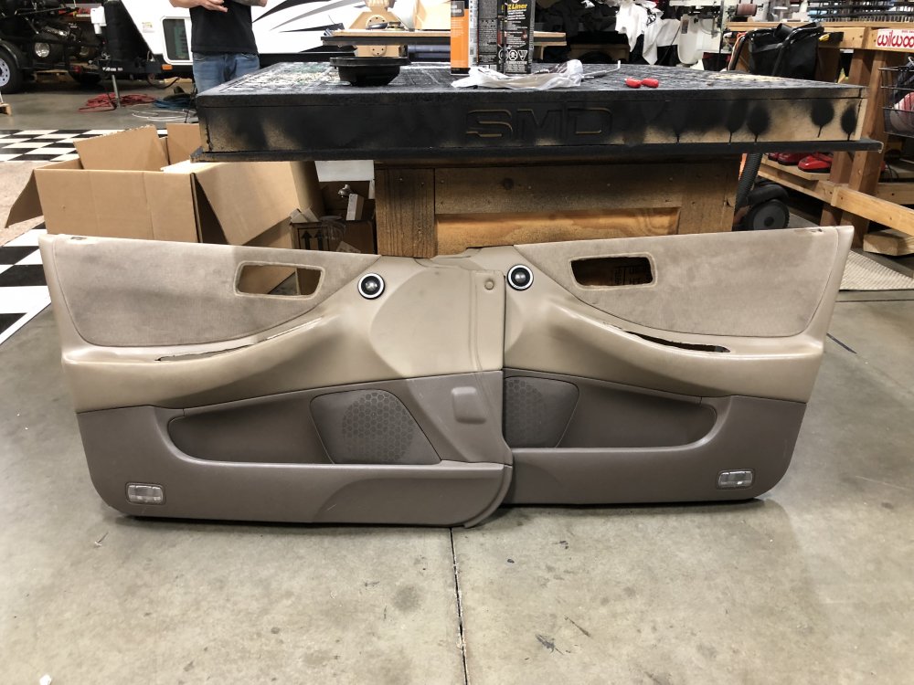

there really isn't a good spot for the passive crossover and i am not a fan of just dropping it inside the door cavity.  I like to at least mount them when i can.  I found a little pocket in the door and decided to make a little sunk-in platform for it to sit on. It actually worked great! Super sturdy and out of the way.  It is also on TOP of the moisture barrier so it shouldn't see much water.

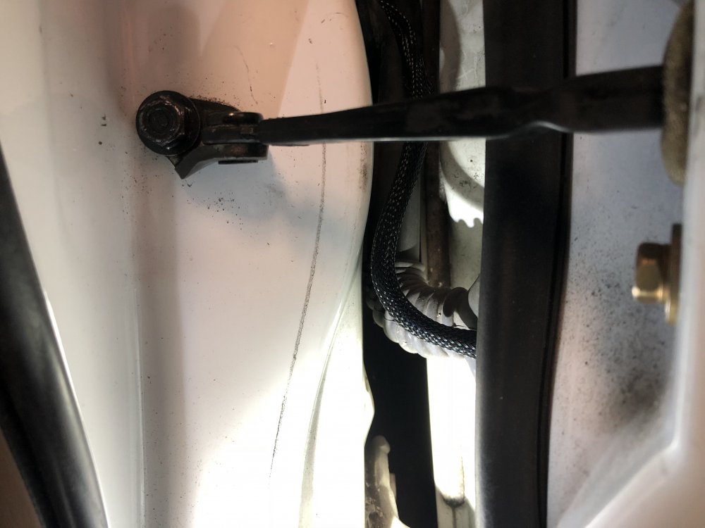

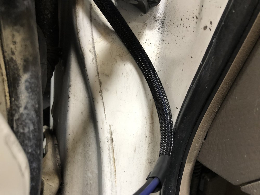

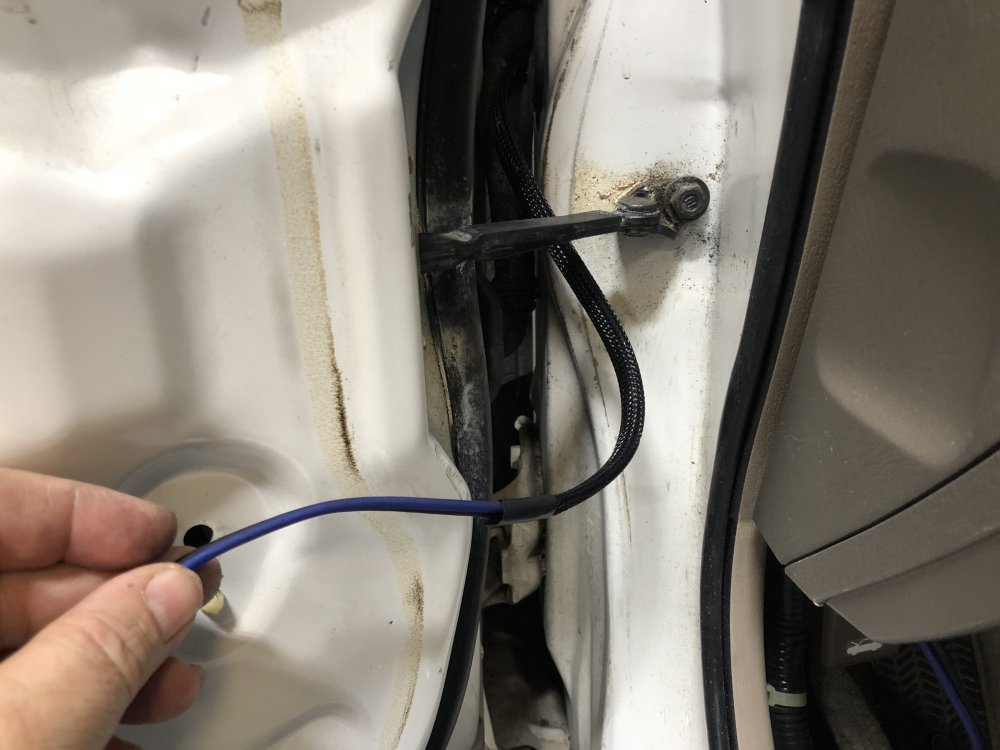

it was a bitch to try to fish this wire through the factory boot so i just went next to it and used tech-flex to keep it clean and durable.

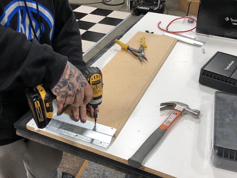

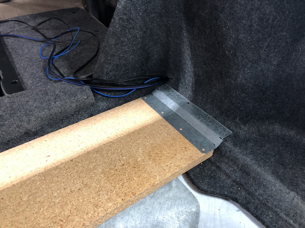

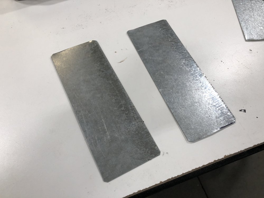

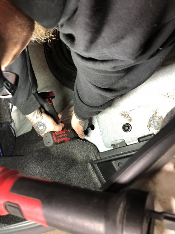

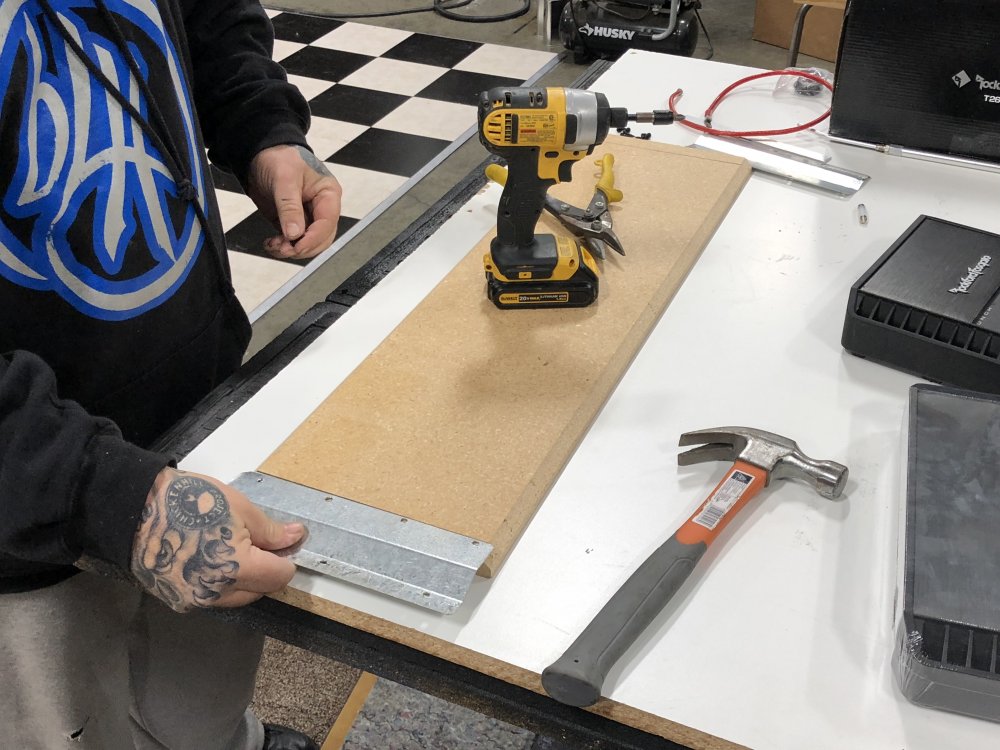

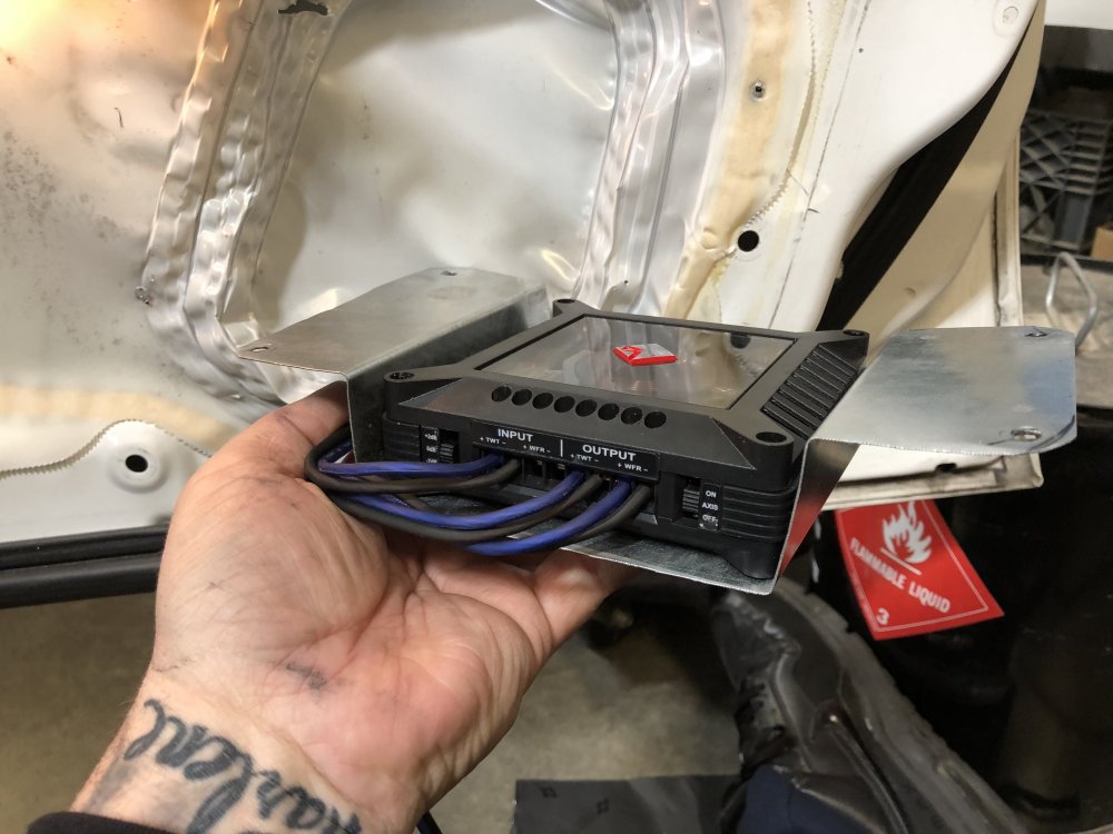

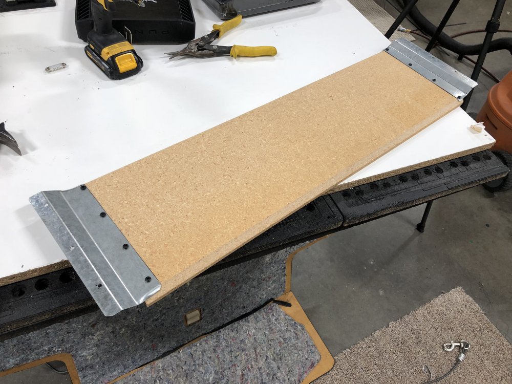

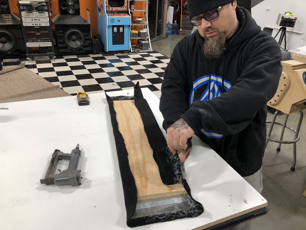

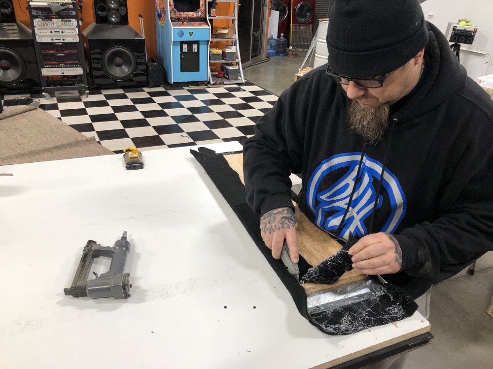

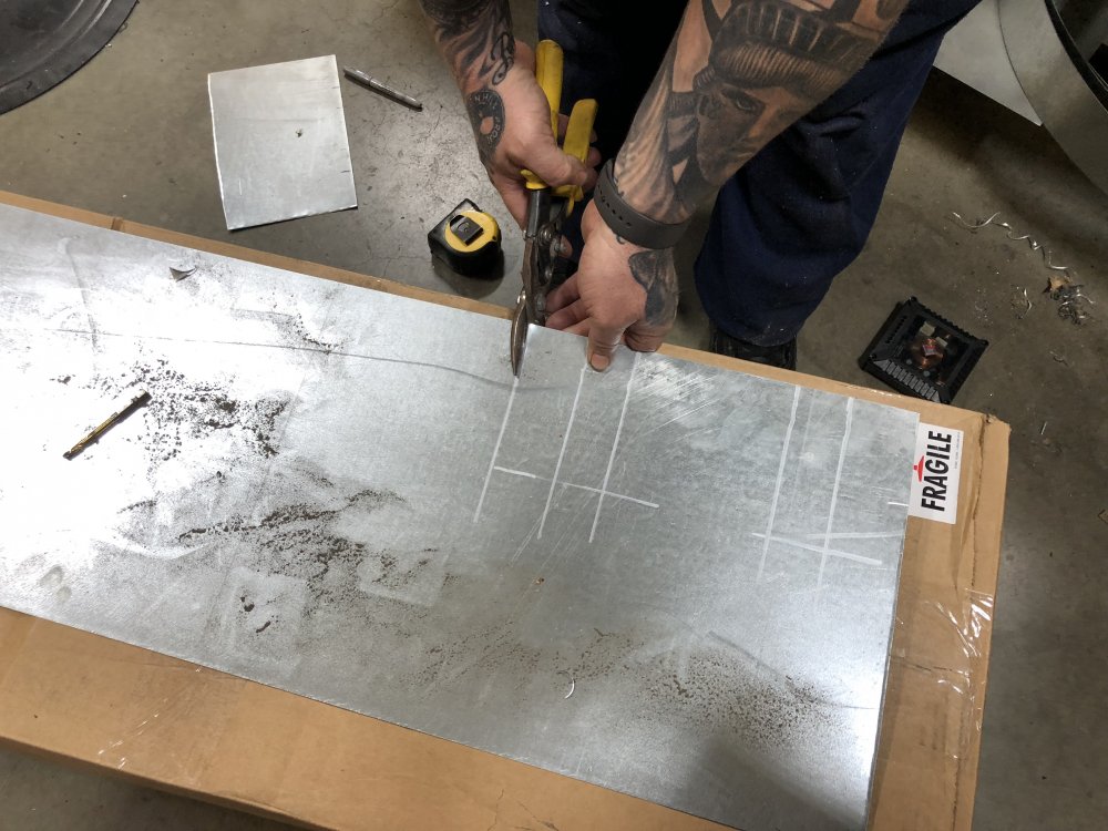

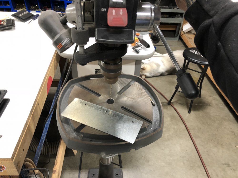

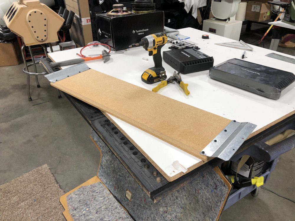

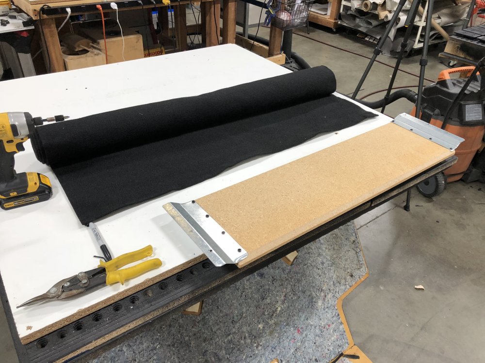

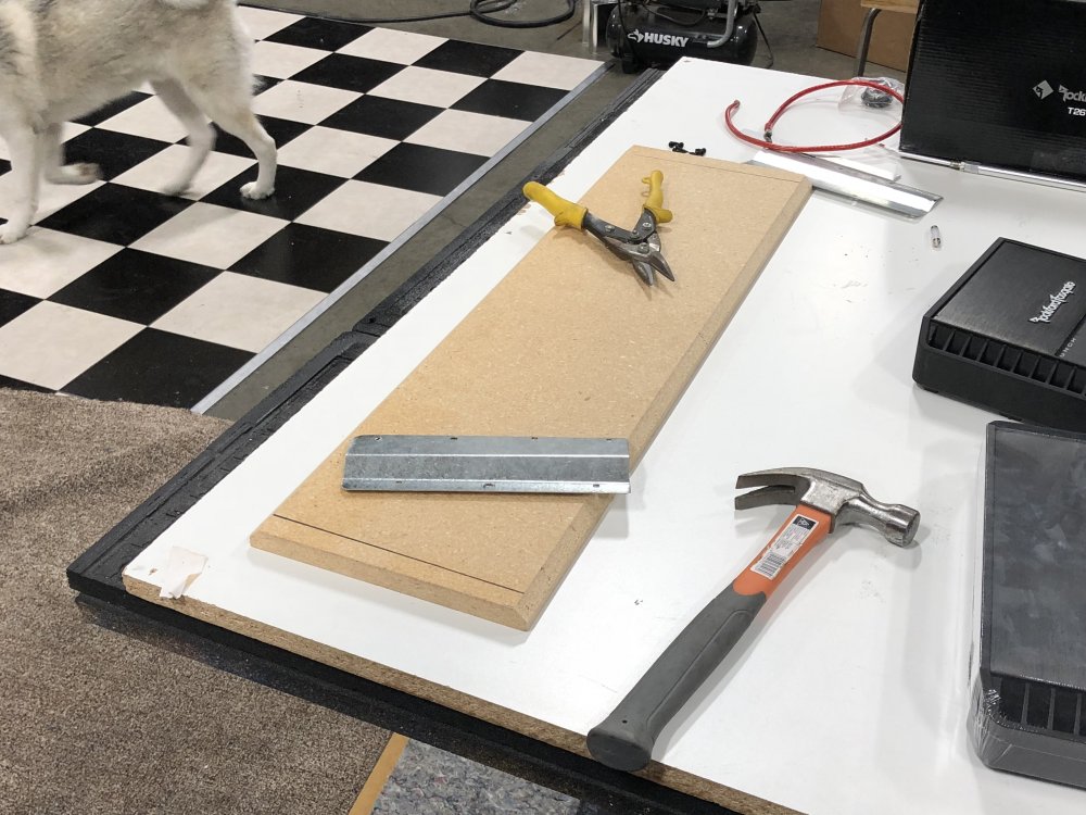

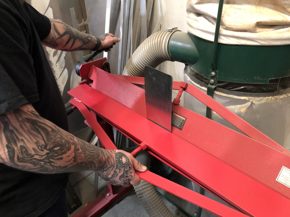

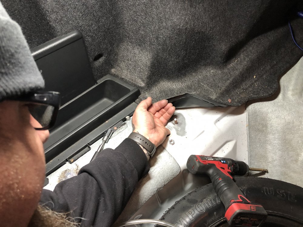

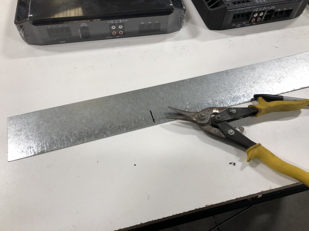

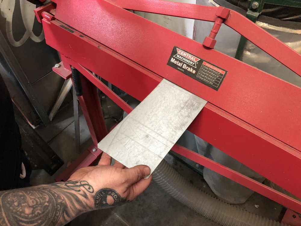

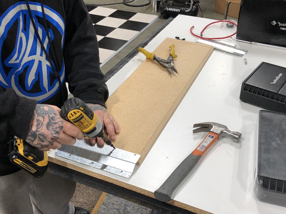

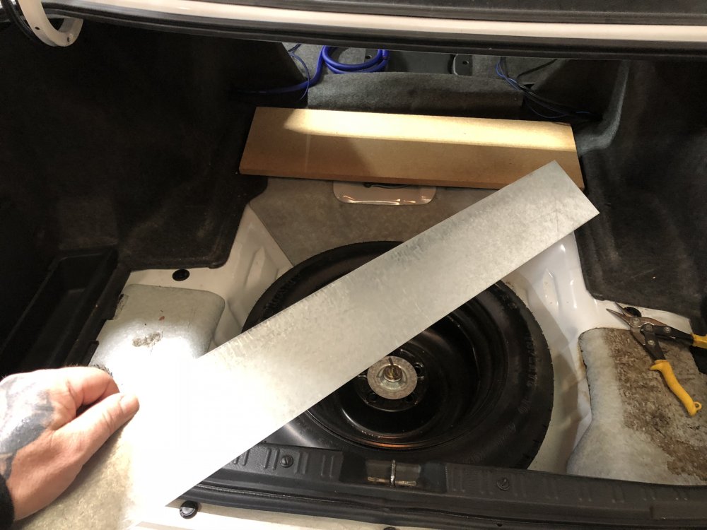

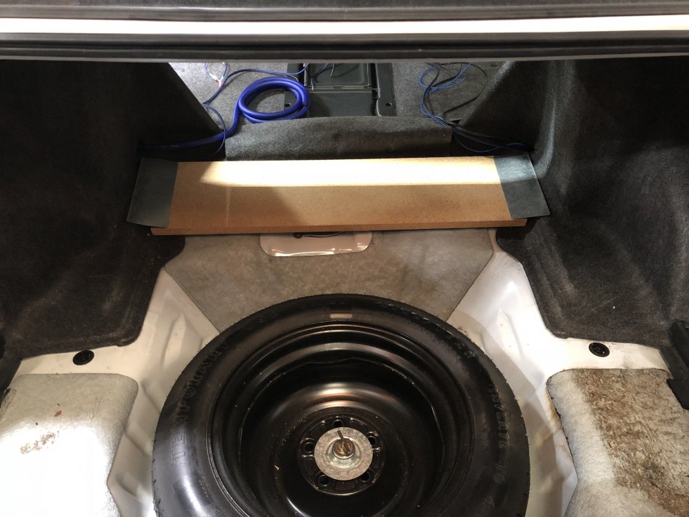

Started the amp rack today.  I didn't want to put any screws straight down because the fuel tank is right below the amp rack. So i built some metal brackets so it can reach out to some metal that is up higher than the trunk floor.
