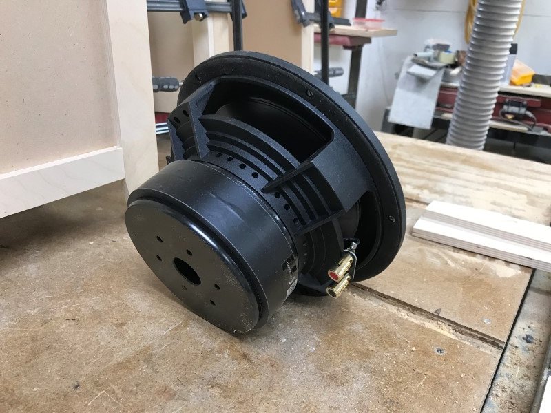

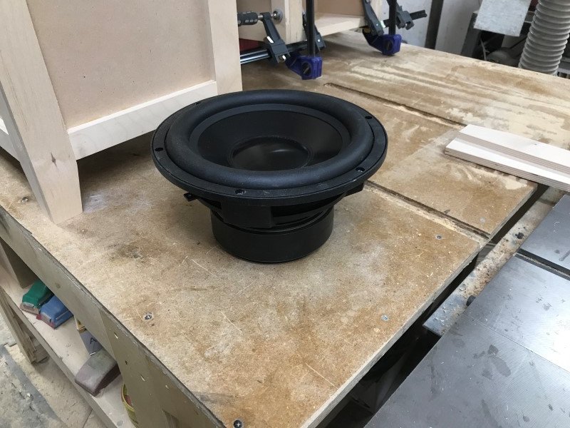

Here are some shots of the subs I'll be using,  Dayton RSS265HO-4s.
5a959c27a1e1d_2018-02-2511_52_29.jpg.92617308b87653f11b21762d622554b4.jpg5a959c2bca4dc_2018-02-2511_52_49.jpg.89e908e41dc7230126c567103bc90479.jpg
For the money I really like these subs, they have aluminum cones, cast baskets, and 600 watt RMS power handling.  They should work well for what I want to do with them.

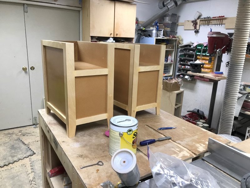

I got out in the spray booth and started putting some shellac on the enclosures to seal up the MDF.5a959c33d639b_2018-02-2621_21_53.jpg.ef0ab856c4e617ddcabe465988c45a44.jpg
Here is one with a coat of shellac and one still bare:
I kinda dig the way the MDF and baltic birch look together with just some shellac on them.  I have to paint these white to keep my wife happy, but I may just go with the shellaced baltic birch and MDF on some future project.
