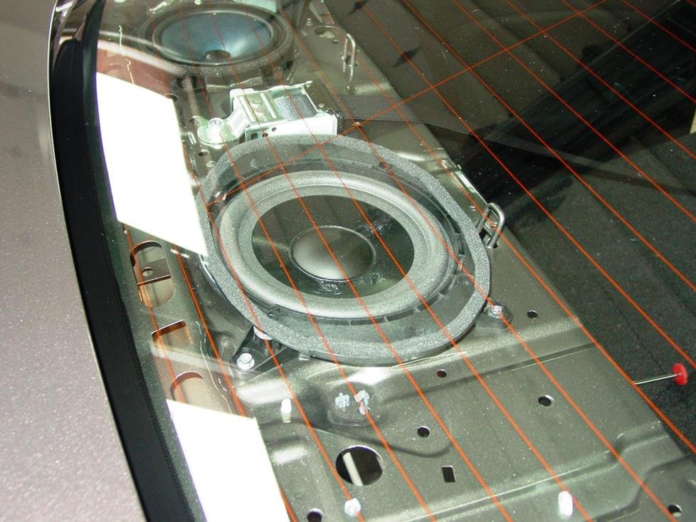

Joshdashef Posted May 3, 2018 Report Posted May 3, 2018 So would this sound terrible? My current idea is to upgrade my coaxial front stage into a component set and power it off either a 2 channel or 4 channel amp. But if I were to buy a 4 channel could I use 2 channels for the components and bridge the last one for a midbass driver (8 inch) that would go where the factory one goes on the parcel tray just above my dedicated 2x 12 subwoofer box in the trunk. Here is a picture of the factory sub placement I'm talking about. [08 Civic Coupe] Let me know your thoughts on this, and if it would be a waste or sound terrible Cheers SMD Tool Map (2024): https://www.stevemeadedesigns.com/board/topic/226545-smd-tool-map-2024/ Great Box Bracing Examples: https://www.stevemeadedesigns.com/board/topic/202148-best-way-to-brace-a-box/?do=findComment&comment=3055002
PaCiFiKbAllA Posted May 3, 2018 Report Posted May 3, 2018 The 12’s would most likely drown out the 8” driver. I would just get a 2 channel and power the front components. 1 x Fi Audio SP4 V2 12" D2 Fully Loaded 1 x Wolfram W-4500.1 2 x XS Power D5100's 250A Singer Alternator 2.67 Cubes @ 29hz
Kraken Posted May 3, 2018 Report Posted May 3, 2018 I agree, the subs will mostly drown the 8. Although if you seal it off below if it isnt already, you can get some extra high bass/mid notes out of it (85hz-500hz). Which can help a little, espically if your subs are tuned low. but make sure if you do put an 8 there, that it is powered properly and that you seal off below it,create almost a box beneath it. which can sometimes be hard, if youre good with fiberglass it should be easy, if not, you might be able to find something online or somehow build your own enclosure. Alpine cde143bt/ Alpine ktp445u (4x45 amp) 2 Crescendo STS 1 (on alpine 4x45 on 2 channel mode) 4 Crescendo pwx 6.5's in front doors (Skar RP150.4) 1 Sundown zv3 12, SAE1500D. Box is 2.5 cubes tuned to 30hz.
WalledSonic Posted May 3, 2018 Report Posted May 3, 2018 @Joshdashef, make sure you set your 8s to a frequency range higher than your subs and YES you will have midbass. Your subs shouldn't play above 80ish Hz anyway, so they wont be drowning out any of your *properly crossed over* midbass. Chevy Sonic Wall (4) 15's on 10k Build Log https://www.stevemeadedesigns.com/board/topic/209412-2015-chevy-sonicwall4-15s10klithiumlarge-case-hairpin-us-alts/ (4) Fi SP4 15's | (2) Ampere 5Ks | Active! | Arc KS600.2 & KS125.2mini | CDT Silk Domes | Silver Flute 8s | 240Ah JY | US Alts Jeep Wrangler JK (4) 8's in a 4th Order Build Log https://www.stevemeadedesigns.com/board/topic/209841-shadow-2016-jeep-wrangler-jk4th-order4-8sdc-35klarge-case-hairpin-us-alts/ IG @walledsonic
Liquid Arthur Posted May 3, 2018 Report Posted May 3, 2018 My personal preference on this, (it's all preference after all) is I would leave anything above about 100 hz in the front and let a nice set of components handle it. I don't like anything above about 100 hz coming from behind. Sounds like listening to concert backwards. My e46 is terrible about this, but I'm going to work on it some. In addition the midbass in the rear could cause phasing issues with your front stage. Also, as have others mentioned, you would need to have the midbass sealed off from your subs, which is A. a PITA, and B. sealing your subs off even further from the rest of your car.

PaCiFiKbAllA Posted May 3, 2018 Report Posted May 3, 2018 I applaud the OP to do what he wants to do whether it be an ambitious project or something simple. Having the 8” sealed off would benefit him also if he were to ever remove the 12’s. He could then cross them lower at that point. 1 x Fi Audio SP4 V2 12" D2 Fully Loaded 1 x Wolfram W-4500.1 2 x XS Power D5100's 250A Singer Alternator 2.67 Cubes @ 29hz
Kraken Posted May 3, 2018 Report Posted May 3, 2018 Thinking more about this, I do think the 8 would help. But, like I said, and a few others, it would need to be sealed. Having it crossed over to handle only midbass would be nice (70-300ish hz). It would also help to make sure you do have a solid front stage though. Alpine cde143bt/ Alpine ktp445u (4x45 amp) 2 Crescendo STS 1 (on alpine 4x45 on 2 channel mode) 4 Crescendo pwx 6.5's in front doors (Skar RP150.4) 1 Sundown zv3 12, SAE1500D. Box is 2.5 cubes tuned to 30hz.
Crazy 8s Drums Posted May 3, 2018 Report Posted May 3, 2018 Maybe? https://www.amazon.com/Rockville-RVL69W-Competition-Aluminum-Subwoofer/dp/B019Z3QJGQ/ref=sr_1_3?ie=UTF8&qid=1525375690&sr=8-3&keywords=6x9+subwoofer Not trying to pimp the Rockville, but since you have a 6x9 hole in there this may be a good use of the space. Orion XTR amplifiers Skar subs
bcbrassard Posted May 3, 2018 Report Posted May 3, 2018 7 minutes ago, Crazy 8s Drums said: Maybe? https://www.amazon.com/Rockville-RVL69W-Competition-Aluminum-Subwoofer/dp/B019Z3QJGQ/ref=sr_1_3?ie=UTF8&qid=1525375690&sr=8-3&keywords=6x9+subwoofer Not trying to pimp the Rockville, but since you have a 6x9 hole in there this may be a good use of the space. OP would still need to seal them off. So if doing the 8" is a issue than 2 6x9's might be to much. That factory set up has potential with some work.
