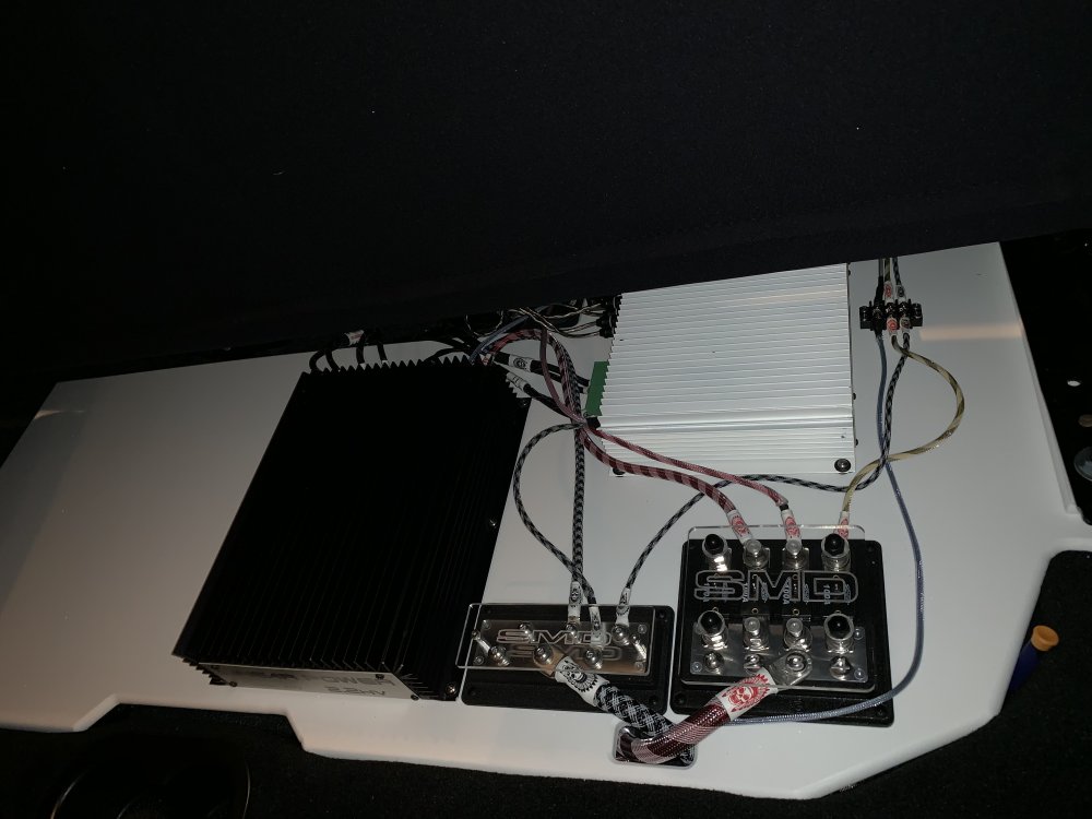

Thanks man, youre gonna like to see what amp the subs will have lol. 4.1
2 minutes ago, 06RTCharger said:
Ill have to do more electrical upgrades before that amp goes in tho. Ill throw the 2.2 on it first.
Are you telling me that you have a LP 2.2hv and a LP 4.1hvs ???
That would be correct Sir. ?
the 2.2 is on my mids right now.

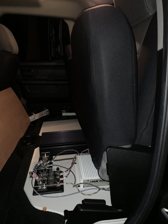

4253IQ is the lil white Lp. I have that bridged for more power to feed my 2in widerange drivers in the dash stock location. Ive been meaning to get a dash cover but havent yet. Got the tip from reading ur posts. Planning on swapping out the 4253 later because i dont wanna have a bridged channel pushing my high frequencies. Find a nice lil 2 channel LP  for them later.
That empty space on my amp panel is reserved for the 4.1

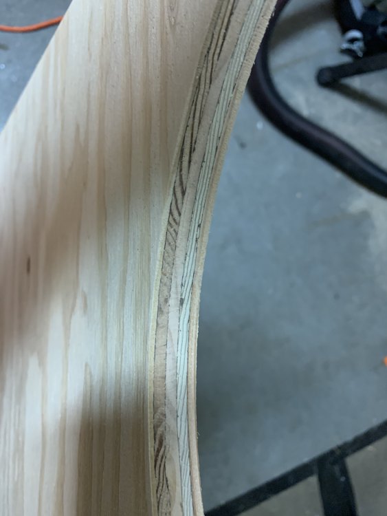

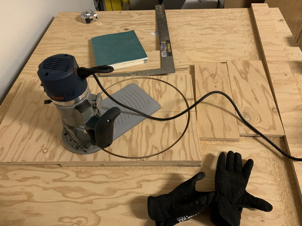

Cut both sub holes. Fastening the sub is gonna be tricky with this shitty plywood, not sure what ill do yet. Figure it out when i get there.

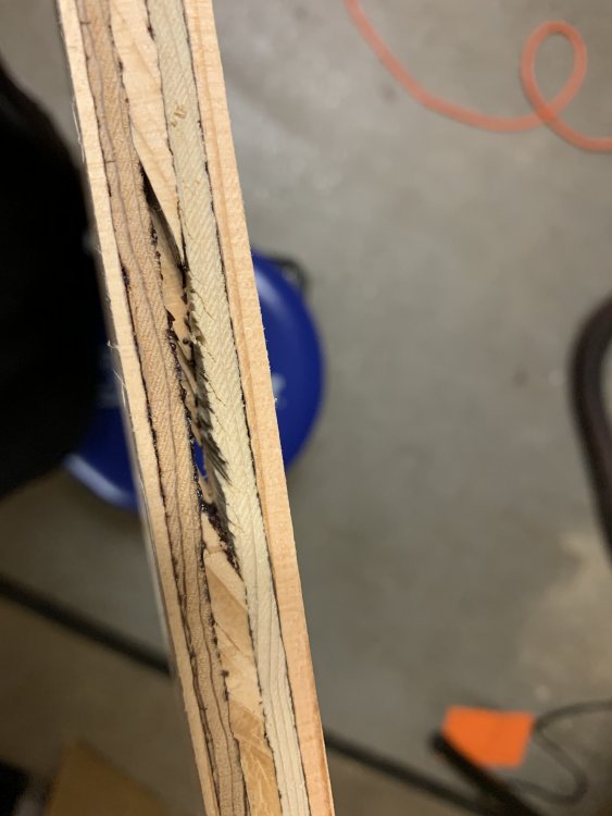

the cuts pretty clean but some spot got huge voids in the wood. The voids arent from my cutting either its just shitty layers within the plywood.

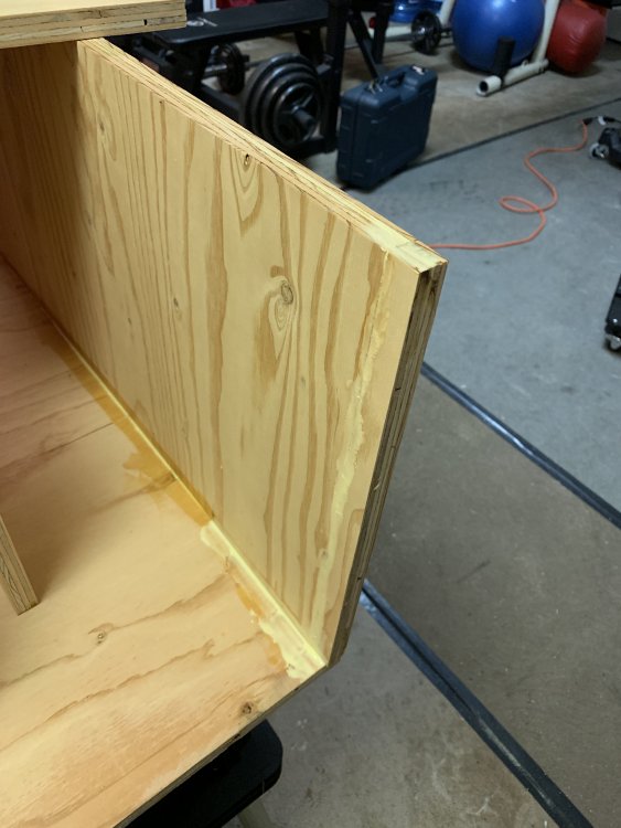

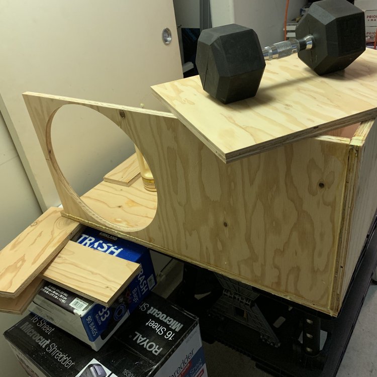

Anyone ever had to do this? Lmao smh fuck. I glued the bottom board, thinking the back sub panel would come all the way down. But the bottom panel was supposed to go all the way back. Damn. Hope this lil filler peice works.
Also tryna put this together with no clamps and no bradnails or anything SUCKS lol
See my lil 3/4x3/4 filler peice? Lol smh
Needed pressure coming from the bottom to make it a flush seal on top area of the sub panel so i stack a bunch of random things to push it up.
Nice !!!
Please tell me that you have talked to Ray about the “feed back” circuit on the 4.1 and you know that you will need to run that amplifier as close to 8 ohms as possible.
Very nice Amplifiers !!!
1 hour ago, White Lightning said:
Nice !!!
is this on the 4.1 only or all the HV series?
IG @walledsonic
Just the 4.1hv
