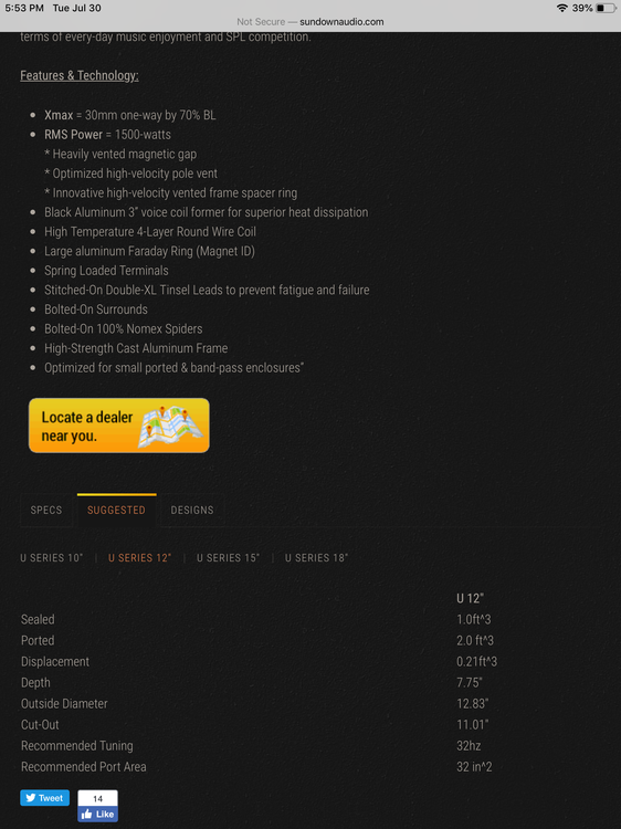

Thanks might be looking at the American Bass XR 12. Regarding enclosures...most manufacturers recommend around 2cft ported enclosures....I understand slightly bigger helps with output but how much bigger until it's too big? Mainly after a lower 28-30hz tune and having a relatively flat response.....
If you like the skar you could just upgrade to the evl 12. Ik it says 1250 rms but with impedence rise and all that youll be perfect on a 1500 rms amp. Or an american bass xfl 12 would work.
Are you going to have enough port area stepping up to that power level?
Sub looks pretty good , I’m a Skar fan to but there subs love big boxes
Is port velocity the main thing I should be worried about regarding port area? I know it's a pretty broad question, but how does say a 2.0cft 28hz tuned box vs a larger 2.5cft but tuned higher around 32hz differ? Is a bigger box generally more output but more peakier and the opposite for a smaller box in this example?
Yup, that's pretty much it.  The larger you make an enclosure, the more output you get around the tuning frequency.
