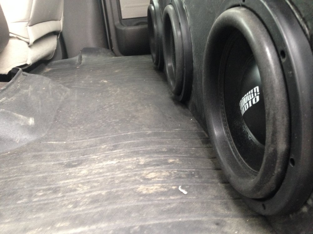

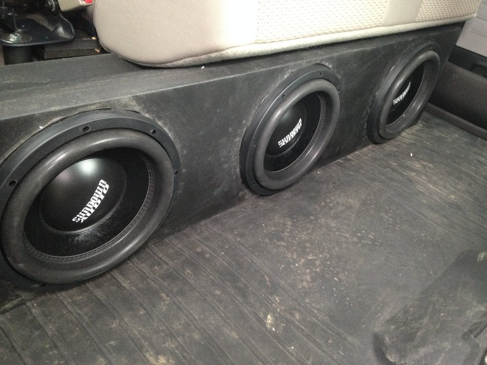

Pick of my old under seat setup 3 Sundown SA-10’s , would definitely go with 10’s . U always go with 10’s over 8’s if U can fit it they just handle lows better and can always take more power. I’ve tried it all and 10’s win every time. I don’t think you can fit those 10’s though but would love to see it and be wrong , those subs are deep 10.5 inches deep.
Nice!! Was it ported? What did you have powering it?  3 subs are just difficult to match up to amps and get all the power they are rated for.

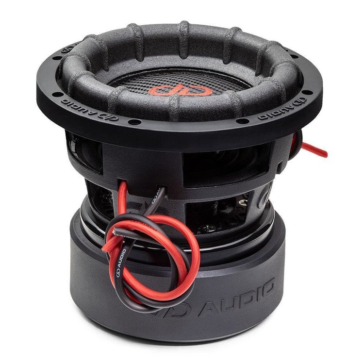

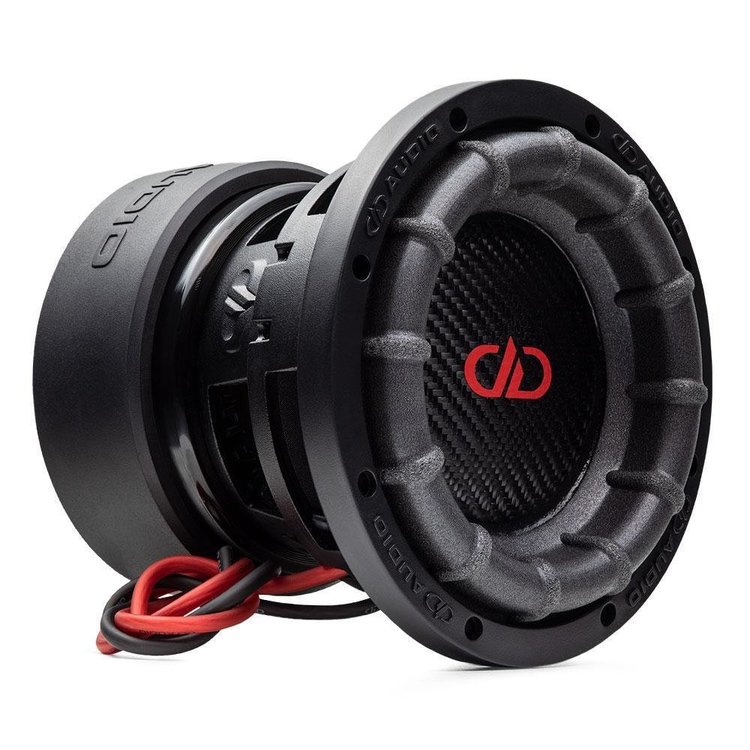

Have you seen the DD 1506s? I think 4-6 of them properly powered would be insane under a truck seat. Cost a pretty penny too, for 6.5" subs they are high $$. I know a couple guys locally that are always saying sundown is expensive... They never even heard of DD... Crazy. I show them a few DD subs and their prices and their jaws drop. To me sundown is CHEAP. 2K amps and 1K rms subs both under 300 is awesome.
Hell these little 6.5"  fellas are 370 a piece...
American Bass VFL 120.1 at .6 ohms so around 3k on bass , box was sealed I also built one ported for 2 of the subs pretty much sounded the same. I got a build log somewhere on here for both.
I’ve been looking at those 1506’s for awhile now , Love DD but the dealer thinks I won’t notice a difference.
