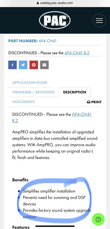

Pep_594 Posted August 8, 2020 Report Posted August 8, 2020 I am installing a system in a 2019 ram 1500. I am using the factory (12”) radio. I am adding the PAC-AP4-CH41 to the radio, Hifonics 2200.1D mono amp, 2 Sundown Audio SA-12’s in a Fox Acoustics box, and a Soundstream 4.0 farad capacitor. The truck has the Harmon Kardon system and I am planning to keep the stock door, dash speakers for now. I might upgrade in the future but for now I am on a tight budget. I am very much a noob. Ive searches several forums but I haven’t found any help. Do I need to add a digital sound processor, crossover, or equalizer to my system? Any help will be appreciated. Thanks

1point21gigawatts Posted August 8, 2020 Report Posted August 8, 2020 3 hours ago, Pep_594 said: What would I benefit more from? I’ve never used a DSP, active crossover, or a equalizer. The only equalizer I’ve ever used came on aftermarket radios. Neither if you don’t know how to use them. Even if you did know how to use, you don’t have an extensive enough car audio setup to need either. Just use some component sets that come with passive crossovers and keep the head unit EQs flat and set the crossovers on the amps accordingly. That’s it. That’s what a lot of people do. That’s what I do. Instead of spending money on a dsp or an active crossover or an equalizer, buy a cc1 to set the amps crossovers correctly and buy a dd1 to set the amps gains and find a clipping point on the head unit, if there is a clipping point, so you know how much you can turn your head unit up before distortion is detected so you know the point to tune the amps at. And that capacitor isn’t gonna do anything. It’s no where near big enough. Capacitors are useless unless they are about 100 farads or more. Just get an extra agm battery and do a big 3 upgrade. “How can we help you?” “And don’t forget to tell them that the customer isn’t always right.”

1point21gigawatts Posted August 9, 2020 Report Posted August 9, 2020 48 minutes ago, Joseph Chambers said: I *think* you need a line converter to take your factory signal, to have rcas. I don't know much about it because I don't have a newer vehicle. Though I think this will help you. He has an aftermarket interface to make a signal. Does the same thing as an loc and makes it where he doesn’t need a dsp. “How can we help you?” “And don’t forget to tell them that the customer isn’t always right.”
slowfkncar Posted August 9, 2020 Report Posted August 9, 2020 What you have will work, just as 1 giga mentioned. The factory head unit only has line-out, which means the volume,fading & balance is digitally controlled by the amp or an integration module such as your pac ap4, a regular line driver or loc won't work without a volume knob so you made the right choice. If you want/need an EQ, you'll have to add one but i bet your factory one will work fine for what you got.
