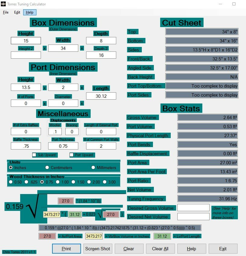

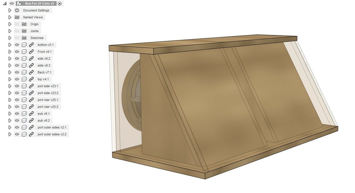

Hey all, I just acquired a new civic hatch and of course, want to add some subs. I've been playing with the torres calc and lurking through old posts, but I haven't come across any designs like the one I'm planning. I'm wondering if there's any reason not to build this way? the port length is correct, measured at the center height line. Only thing I guess I'd be worried about is my port ratio, as it's over 4:1, or should this be a non-issue? The subs going in will be the demon 10", run at 1ohm to an old hifonics brutus 1200.1D amp that claims 1200w at that resistance.

The bends probably aren’t too bad. What I would be worried about is the top and bottom of your port are different lengths.
This really doesn't matter much.
When dealing with an angled port wall as such all you do is calculate the port length by measuring down the middle of the height.
So if the top of the port is 20 inches long and the bottom of the port is 30 inches long that would make the middle of the port length 25 inches long and that is the length you use.

Thanks for all the replies guys, guess I'm gunna go ahead an build it and see what happens. Will update with progress as the build comes along!

I'm also going to be building an enclosure exactly like this. Only item I ran into while designing the port was the width/height ratio on the portion of the port along the back wall. The steeper the angle, the taller the height became. It took quite a bit of trial and error to finally get a design that didn't cause that portion of the port to have a ratio close to 1:8.
