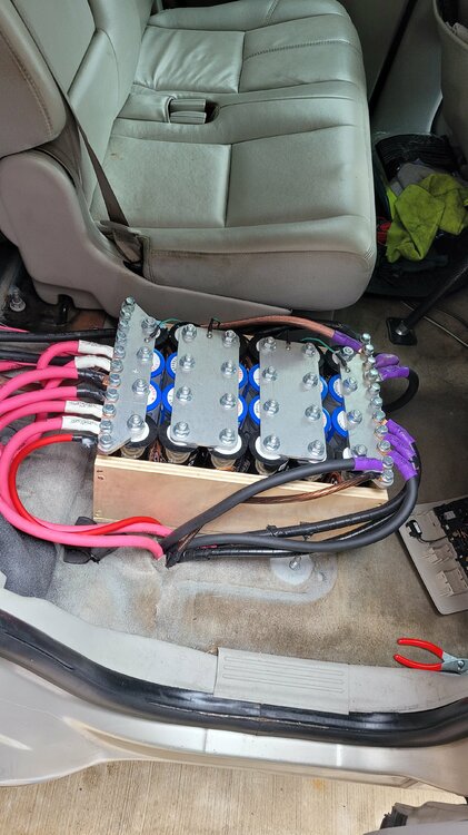

Cruz18s420 Posted June 9, 2022 Author Report Posted June 9, 2022 Here's the 140 ah LTO bank , finally got everything up and running not the nicest as far as the setup goes but that is on the list of what to do/accomplish. Still working on the voltage was able to get it up to 15v one night after work . Having it close to full tilt on my way to work then sat around 14.6 but yet the fluctuation happened dropping down around 14v when I was on my way home. So got home turned the truck off turned it back on let idle around 1-2k rpm got it to charge to 15v and the alt read 15.2v but the battery light came on and i assumed the truck was telling the cpu it was to high of voltage so it went down to 14.6. I've read its normal but can I get past this by not using the VRC ring? I have tried with a pwm frequency regulator but I don't think it has much affect on my alt/system any insight?
