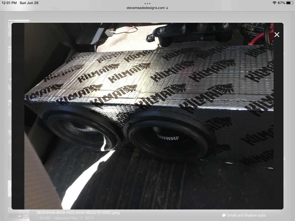

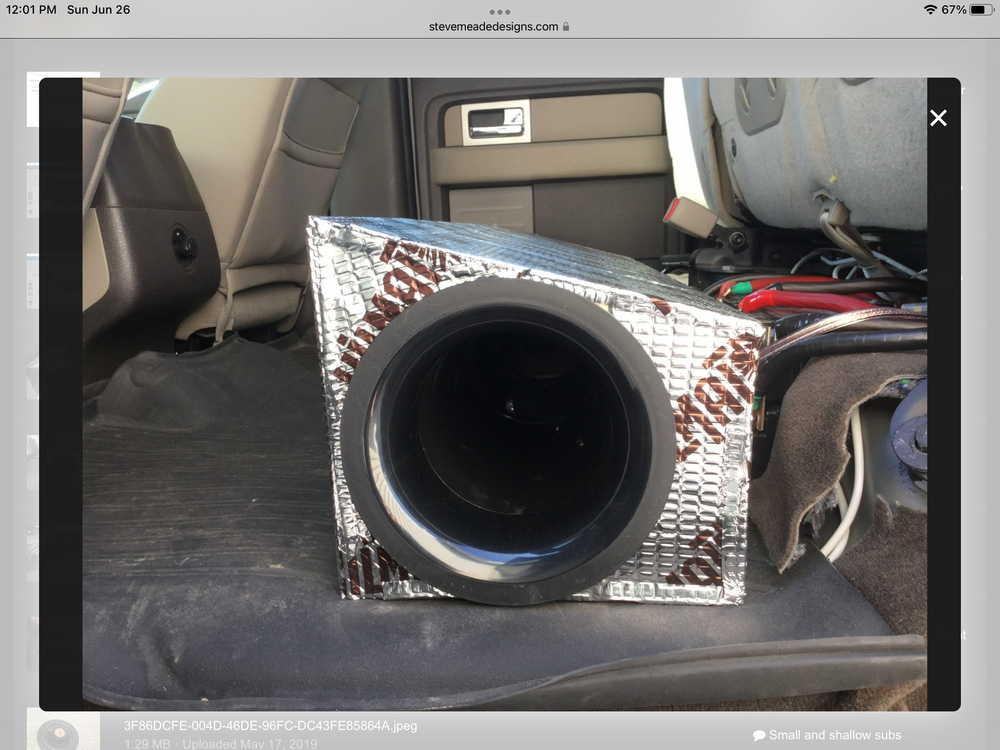

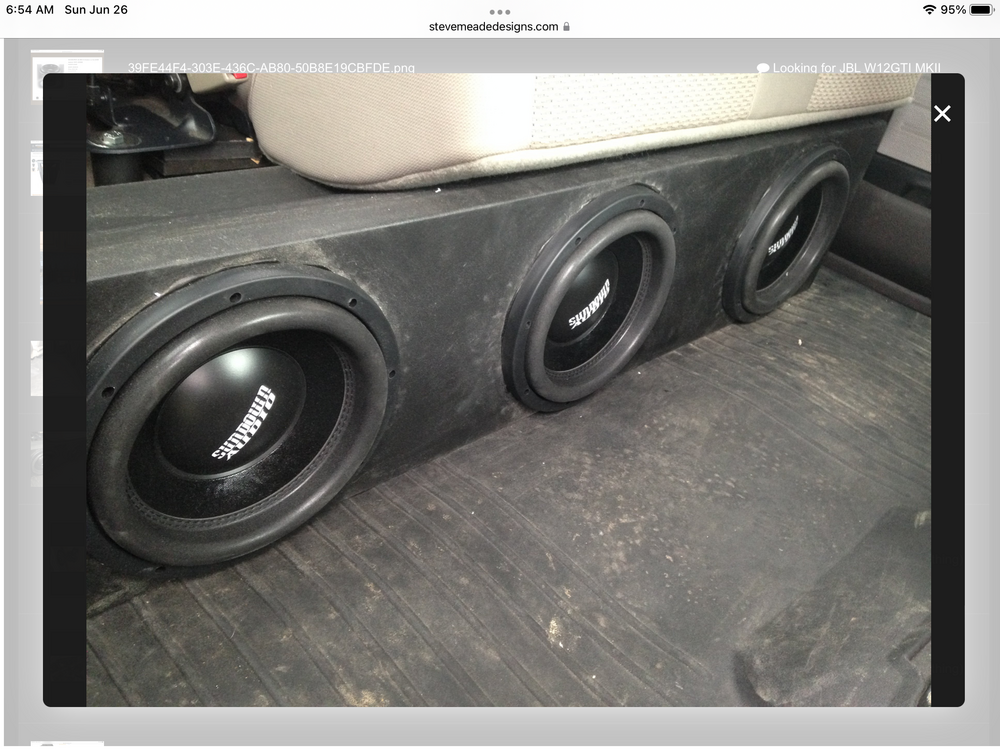

I did 3 -10’s under seat build , shit slammed, I don’t think your electrical is good enough. 3,300 watts on stock ALT plus whatever is running your mids . I don’t see anything about batteries not battery. I ran about 4500watts with mids and had 250amp ALT and 6 batteries to hold voltage.
Damn! I don't think I've ever seen 3 10's under a back seat. Nice!
Ported? Sealed?
Had to go sealed but did build one for 2 -10’s ported.
