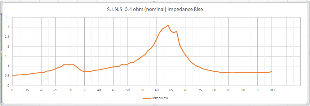

WalledSonic Posted September 18, 2017 Author Report Posted September 18, 2017 4th Order Bandpass with (4) 8's for my buddy's JK Wrangler. Wired down to 0.4ohmDC. Almost 8 times rise at 63ish Hz, but only 3 times rise at 30Hz. The amp will never see lower then 0.55ohm. You can see the tuning frequency is at 35Hz with the dip 'pulled' a bit to the left. The subs would like to have the box tuning a little bit higher, but we're gonna break them in like this. After break in, we'll re-evaluate the tuning and cut the port shorter if we dont like the low tuning (doubt it though). In about a month or so I'll post an overlayed impedance curve to show the difference between fresh and broken in. Will also post some free air resonance numbers. Chevy Sonic Wall (4) 15's on 10k Build Log https://www.stevemeadedesigns.com/board/topic/209412-2015-chevy-sonicwall4-15s10klithiumlarge-case-hairpin-us-alts/ (4) Fi SP4 15's | (2) Ampere 5Ks | Active! | Arc KS600.2 & KS125.2mini | CDT Silk Domes | Silver Flute 8s | 240Ah JY | US Alts Jeep Wrangler JK (4) 8's in a 4th Order Build Log https://www.stevemeadedesigns.com/board/topic/209841-shadow-2016-jeep-wrangler-jk4th-order4-8sdc-35klarge-case-hairpin-us-alts/ IG @walledsonic
