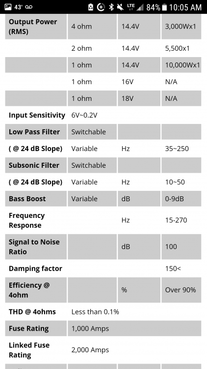

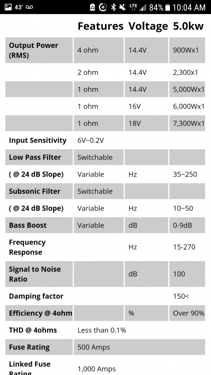

the_garynator Posted October 23, 2017 Report Posted October 23, 2017 I approve these updates!!!! So much JY Pwwwwwwrrrrr! On 10/20/2017 at 5:52 AM, WalledSonic said: Gonna put the K2 battery in my buddy's JK. So now I'm working with 3 banks of new JY lithium. Running two 5Ks at 0.5 ohm each is equivalent on the electrical system to one 10K at 0.25 ohm. Thats some serious current draw. This single alternator is gonna be putting in werk but the lithium bank will be my trusty cushion. Running 2 5ks at 0.5ohm each would be the equivalent of running a 10k at 0.5ohm, not 0.25. If you were running a pair of strapped 5.0ks at 0.5ohm then it would be like a 10k at 0.25ohm. Just for the record. Either way, your electrical is on point! Keep up the good work! Current Build: Project Flexington: 157.6db @ 37hz Parallel 6th order walk through, DC Neo Elite 18s, 4 DC 5.0ks, JY Lithium, 12 banks of XS Caps Old Builds:150db and HAIRTRICKs from 2x 12" Power Acoustik Mofos (6th order blow through) ;<p>Roadmaster Wagon Build - DC LVL 6 M3, Kicker Warhorse ; Godzilla swapped 240sx ; 6th Order Bandpass Alpine Type R 12 ; Fully loaded DC Level 5 18" 240sx
WalledSonic Posted October 23, 2017 Author Report Posted October 23, 2017 Thanks man! I will have (2) parallel 0.5ohm draws from the electrical. The electrical system will dump current into the pair of amps as if I was running a single 10K at 0.25ohm since each 5K is drawing from the main bus at 0.5ohm each... in parallel. Chevy Sonic Wall (4) 15's on 10k Build Log https://www.stevemeadedesigns.com/board/topic/209412-2015-chevy-sonicwall4-15s10klithiumlarge-case-hairpin-us-alts/ (4) Fi SP4 15's | (2) Ampere 5Ks | Active! | Arc KS600.2 & KS125.2mini | CDT Silk Domes | Silver Flute 8s | 240Ah JY | US Alts Jeep Wrangler JK (4) 8's in a 4th Order Build Log https://www.stevemeadedesigns.com/board/topic/209841-shadow-2016-jeep-wrangler-jk4th-order4-8sdc-35klarge-case-hairpin-us-alts/ IG @walledsonic
the_garynator Posted October 23, 2017 Report Posted October 23, 2017 59 minutes ago, WalledSonic said: Thanks man! I will have (2) parallel 0.5ohm draws from the electrical. The electrical system will dump current into the pair of amps as if I was running a single 10K at 0.25ohm since each 5K is drawing from the main bus at 0.5ohm each... in parallel. I disagree, it doesn't work like that. For illustration and simplicity's sake, let's pretend your 5ks are seeing 1ohm each. We'll use DC Audio for example. A single 5.0k at 1 ohm can put out 5,000w. Lets assume at 5,000w it will pull a maximum of 500a (at 14.4v) from your electrical as evidenced by the fuse rating: 2 of them would pull 1000 amps. Using that logic, a 10k should pull the same amount of current at 0.5 ohm and therefore be fused lower than 1000a if rated at 1 ohm, but it isn't. It's rated at 1ohm and requires 1000a of fusing. The only time you'd see the situation that you're describing is if you were running 2 5ks strapped at .5ohm. Each would be seeing 0.25 ohm making them pull current comparable to a single 10k at 0.25. The only thing on the electrical (input) side of the amp that is effected by nominal impedance on the output side is efficiency of the amp, which wiring down could potentially make it draw more current if wired lower. Having the power to the amps wired in parallel has nothing to do with the load your amp is seeing. 2 5ks at 1 ohm each will pull the same as a 10k at 1 ohm (I'm generalizing for illustration purposes obviously). Hope this makes sense. Current Build: Project Flexington: 157.6db @ 37hz Parallel 6th order walk through, DC Neo Elite 18s, 4 DC 5.0ks, JY Lithium, 12 banks of XS Caps Old Builds:150db and HAIRTRICKs from 2x 12" Power Acoustik Mofos (6th order blow through) ;<p>Roadmaster Wagon Build - DC LVL 6 M3, Kicker Warhorse ; Godzilla swapped 240sx ; 6th Order Bandpass Alpine Type R 12 ; Fully loaded DC Level 5 18" 240sx
WalledSonic Posted October 23, 2017 Author Report Posted October 23, 2017 Yeah i drew a poor comparison. In the end, the amplifiers just draw a lot of DC current from the bank based on whatever AC output the amp makes when wired down. If I had a 10K amp, I would only be able to wire down to 0.2 or 0.8. With 2 separate amps, I'm able to wire each at half, which is easier on the amps than running a big board at 0.2. Thanks for the input. Chevy Sonic Wall (4) 15's on 10k Build Log https://www.stevemeadedesigns.com/board/topic/209412-2015-chevy-sonicwall4-15s10klithiumlarge-case-hairpin-us-alts/ (4) Fi SP4 15's | (2) Ampere 5Ks | Active! | Arc KS600.2 & KS125.2mini | CDT Silk Domes | Silver Flute 8s | 240Ah JY | US Alts Jeep Wrangler JK (4) 8's in a 4th Order Build Log https://www.stevemeadedesigns.com/board/topic/209841-shadow-2016-jeep-wrangler-jk4th-order4-8sdc-35klarge-case-hairpin-us-alts/ IG @walledsonic
