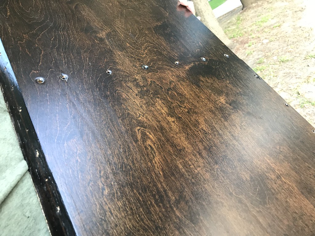

Outside panels (top and bottom) with the second coat of Dark Walnut (no clear yet)
Third coat stain

Wet wet
I've said it before, we're kinda obsessed with Dark Walnut stain
Need to pull the amp rack and main box for stain now.  Should be done before Texas Heatwave in Austin.
