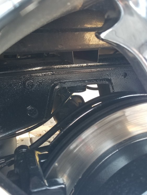

Yep. I passed on it. For a few reasons. I like the idea of starting out with a stock fresh rig, that I do, or have the mods done to my liking. Here us a shot of the rig I looked at, if any one cares. It was a pretty clean ride. But clean doesnt equal built proper for sure. Think I will just find me a bone stock turd, and make my own.

yeah... good looking welds but nowhere near enough frame rail left to be safe.  good call on passing
well if the frame was boxed in on the back side then it would have been good.
