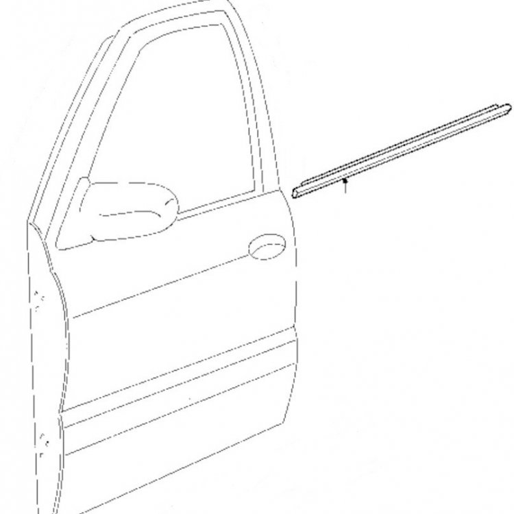

WalledSonic Posted February 27, 2018 Report Posted February 27, 2018 7 hours ago, 06RTCharger said: Just wanted to start a thread about this issue. Share any of ur personal experiences or thoughts on the topic. My car leaks water like crazy on the inner door chamber. Im sure im not the only one that needs some ideas on how to fix the issue. http://www.dodgeparts.com/2006-dodge-charger-sxt-gas_3.5_v_6-transmission_automatic_4-body_hardware-exterior_trim-w_strip_front_door_b_4806139AB-item/ I think this is the one you need, but double check. I usually google "MAKE MODEL parts diagram" to find parts for cars. These days, there's usually a diagram with the exact part I need (usually). Good luck man. I think you already saw the thread yesterday about the speaker baffle umbrella thing, so you should be good to go now. Let us know on your build log how it all works out! Chevy Sonic Wall (4) 15's on 10k Build Log https://www.stevemeadedesigns.com/board/topic/209412-2015-chevy-sonicwall4-15s10klithiumlarge-case-hairpin-us-alts/ (4) Fi SP4 15's | (2) Ampere 5Ks | Active! | Arc KS600.2 & KS125.2mini | CDT Silk Domes | Silver Flute 8s | 240Ah JY | US Alts Jeep Wrangler JK (4) 8's in a 4th Order Build Log https://www.stevemeadedesigns.com/board/topic/209841-shadow-2016-jeep-wrangler-jk4th-order4-8sdc-35klarge-case-hairpin-us-alts/ IG @walledsonic
