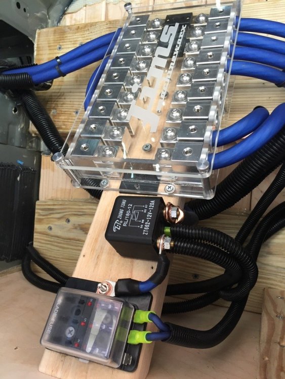

Wishuponasub Posted October 24, 2018 Report Posted October 24, 2018 Sorry I was at work. This is how l learned to do it. With the fuse block you will be able to individually fuse each item appropriately. @WalledSonic. This is his build not mine. Sitting around waiting to be installed: 4 FI X 10 270 CES alt D3400/73ah lithium AA 3800.1 (2) AA 75.4

Joshdashef Posted October 24, 2018 Report Posted October 24, 2018 5 hours ago, Wishuponasub said: Sorry I was at work. This is how l learned to do it. With the fuse block you will be able to individually fuse each item appropriately. @WalledSonic. This is his build not mine. This looks sick as hell SMD Tool Map (2024): https://www.stevemeadedesigns.com/board/topic/226545-smd-tool-map-2024/ Great Box Bracing Examples: https://www.stevemeadedesigns.com/board/topic/202148-best-way-to-brace-a-box/?do=findComment&comment=3055002
