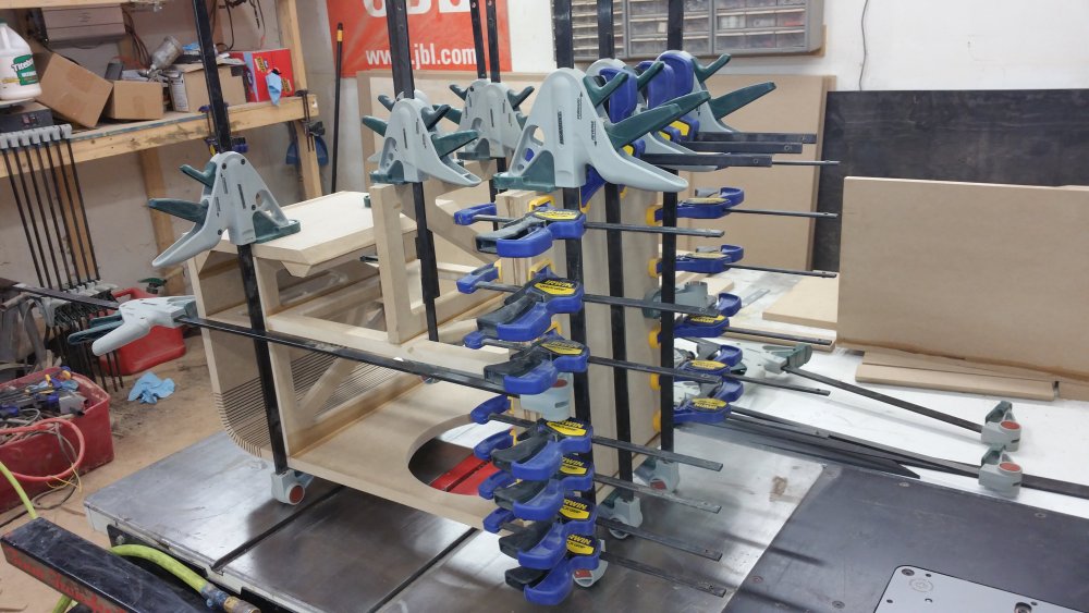

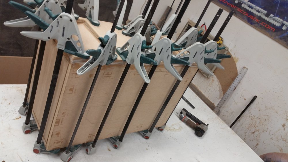

audiofanaticz Posted January 5, 2019 Report Posted January 5, 2019 When I clamp I clamp like crazy... I wouldnt say you need the best clamps you can get by with many slightly cheaper clamps that will cost less but still put out more than enough clamping force. I agree with the tube style clamps.. They are just cumbersome to use, and heavy. Especially if you will be moving the enclosure around a little once you got something clamped then they will scratch up your build table. I prefer something with rubber on the ends so it doesnt damage the wood much. Those Yost Tool clamps with the ball screw tension thing aint too bad and cheap, I used similar Irwin style ones fro a while and they do good, but too much pressure the bar will start to bend. Id stay away from those chincy corner clamps, Ive tried a few different kinds now and none of them will hold a true 90 degree corner once pressure is applie, I found some hefty duty ones now that work good. Try to buy as long of a clamp as you can!! Currently my gotos are masterforce clamps for everything, and they can be changed around to apply outward pressure too if you need to spread something apart. I also got a lot of little Irwin style F clamps as well that come in handy for doing small panel build ups before marrying those parts to the enclosure.
