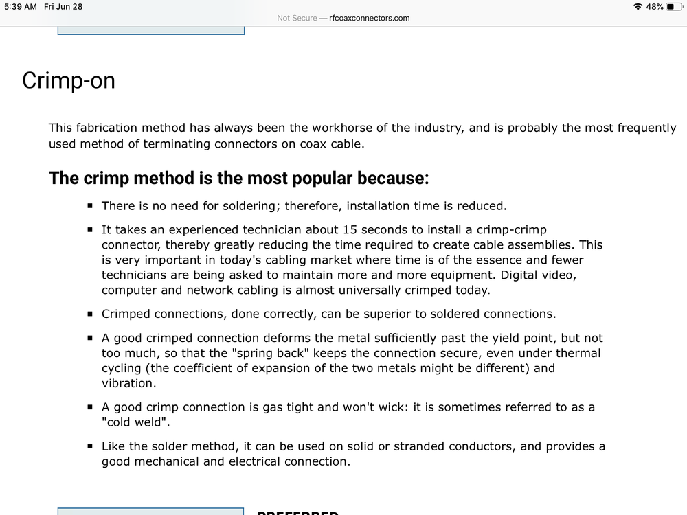

I would just braid the wire together very strong and heat shrink it , I stopped soldering wire years ago unless it’s on a circuit board . Had a class on this awhile back and braided and crimp joints hold better then solder. Solder isn’t flexible and can crack from vibration. Not to mention only about half the people that solder really know how to do it right , U don’t just put a drop of solder on a wire and call it soldered I’ve seen this a ton in car audio.
