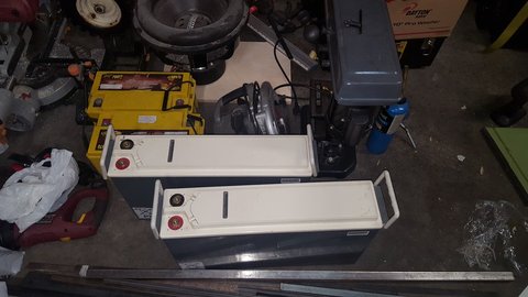

Batteries:
2 nsb170fts and 2 stinger group 31s:

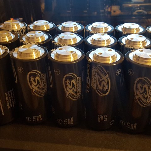

3 banks of super caps:

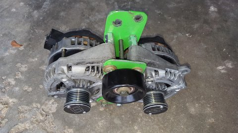

2 singer 320amp alternators (these came with the truck, I'm currently in the process of redoing the bracket to strengthen it and add a tensioner but I'll elaborate later):

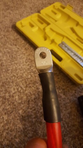

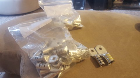

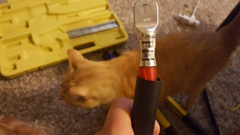

Terminals, marine grade ring terminals lugs, properly crimped with double wall adhesive lined heat shrink:

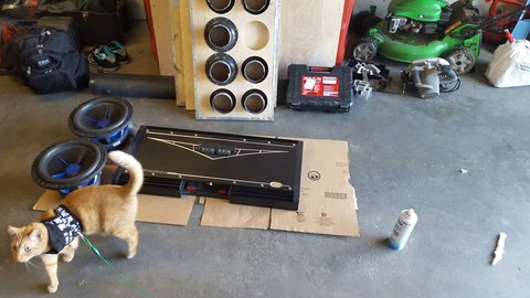

Subs are 2 sundown x15s rev 1(will be rebuilding for level 6 18s at a later date):
Sub Amp, kicker warhorse:

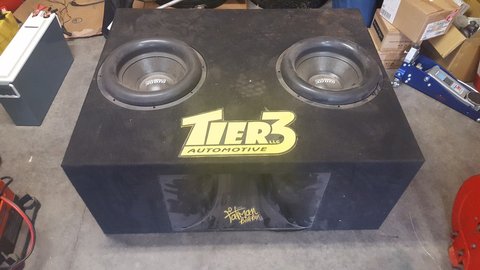

Started by ripping out the blowthrough shell that came with the truck, link in my signature to a series tuned 6th I built in it previous to this if you want to see it.

Did a mockup of the new alternator setup, I ended up deciding to use a different tensioner but I'll post about that later:

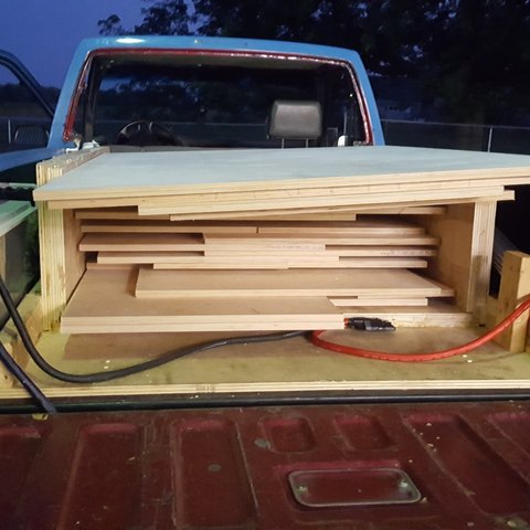

Shot a light coat of paint over the bed, Redid the bottom layer, and laid some expanding foam:
Got the box partially assembled:
I'll be ripping out the port and replacing it with a single sheet and longer divider tomorrow
