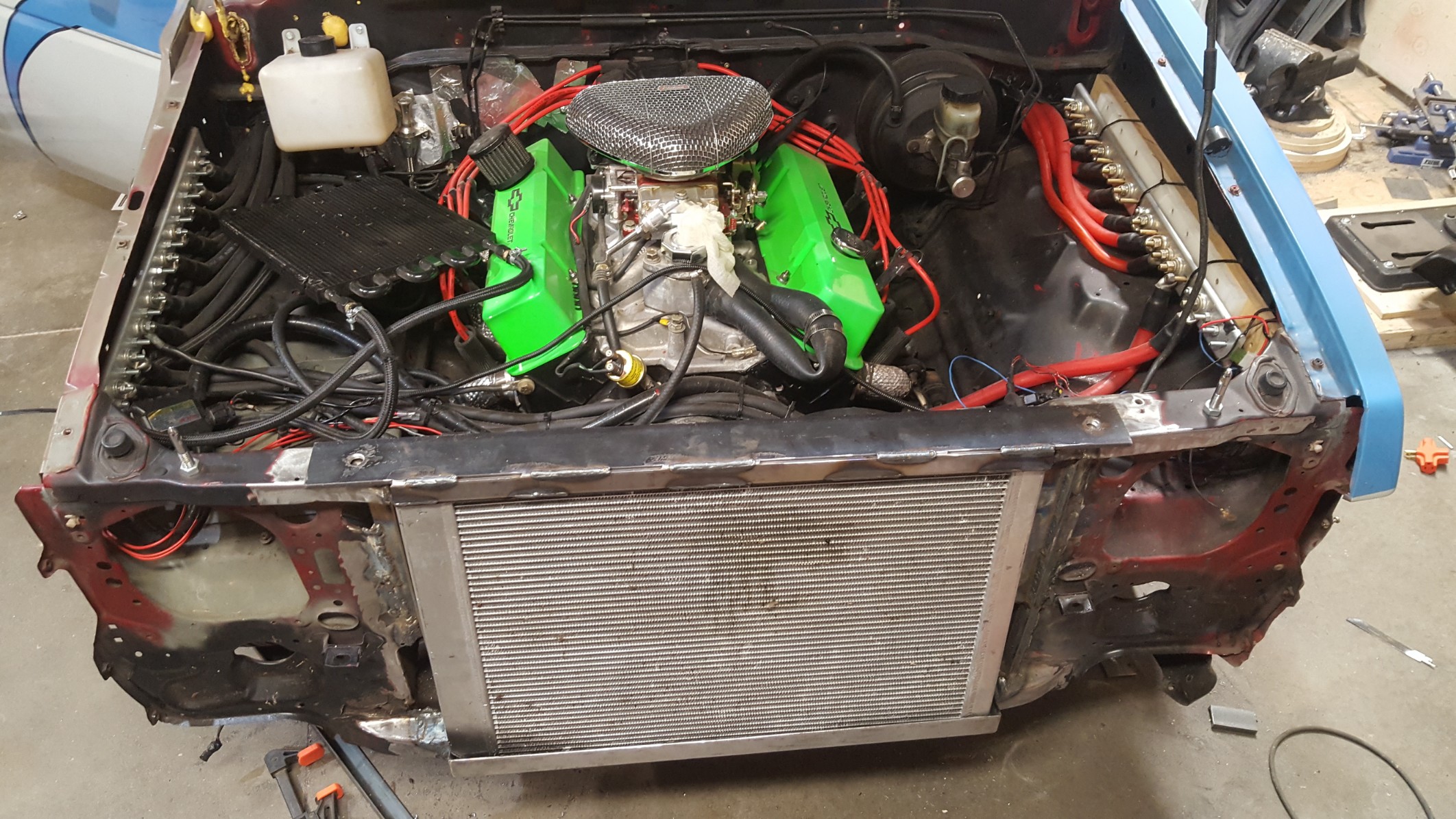

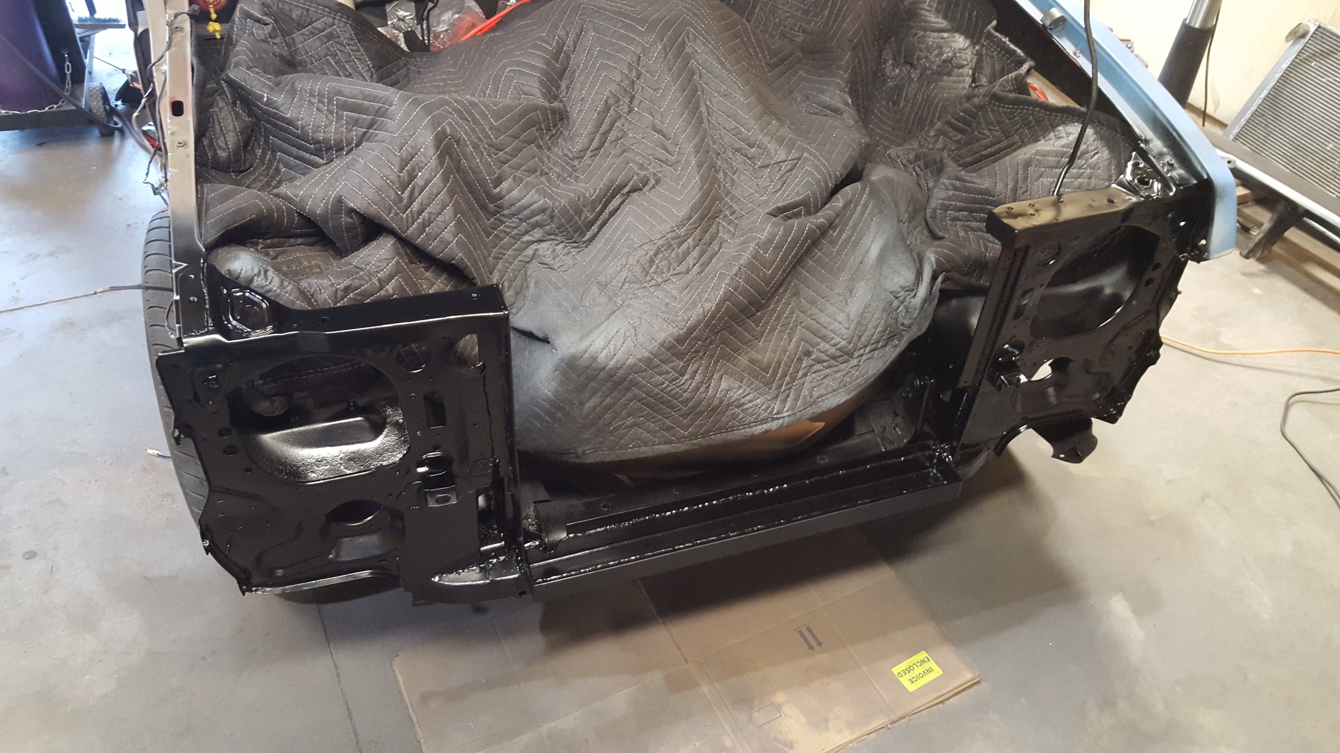

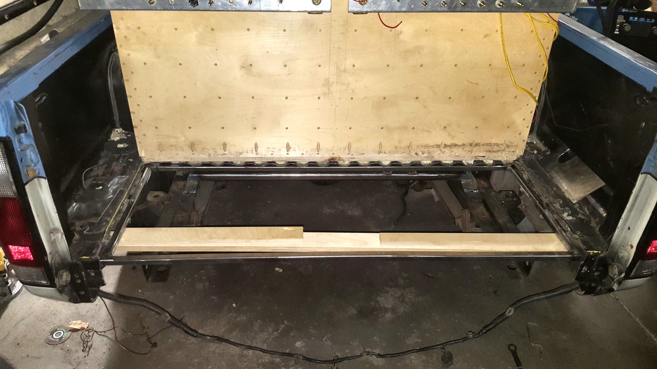

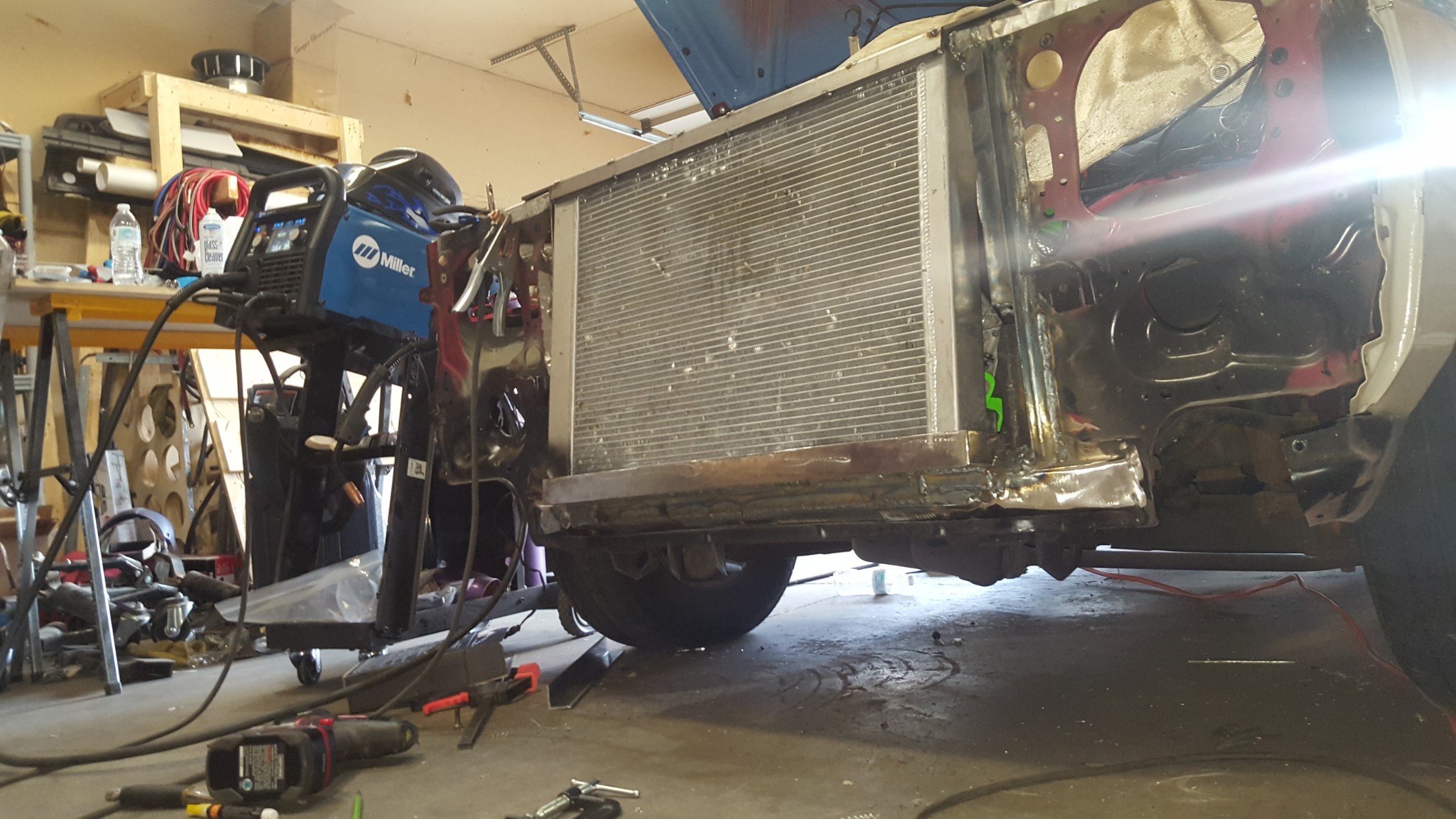

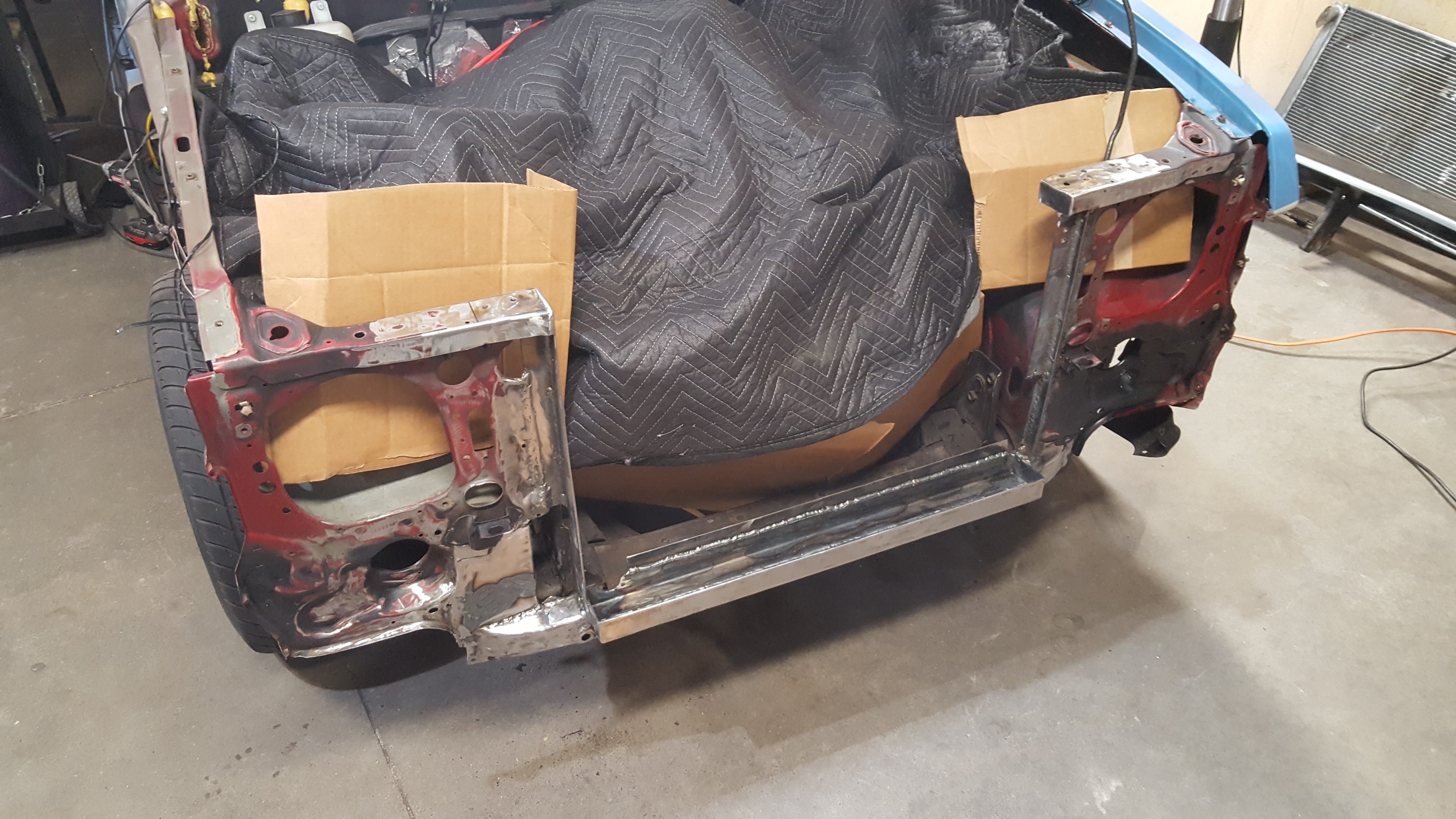

Front radiator frame done

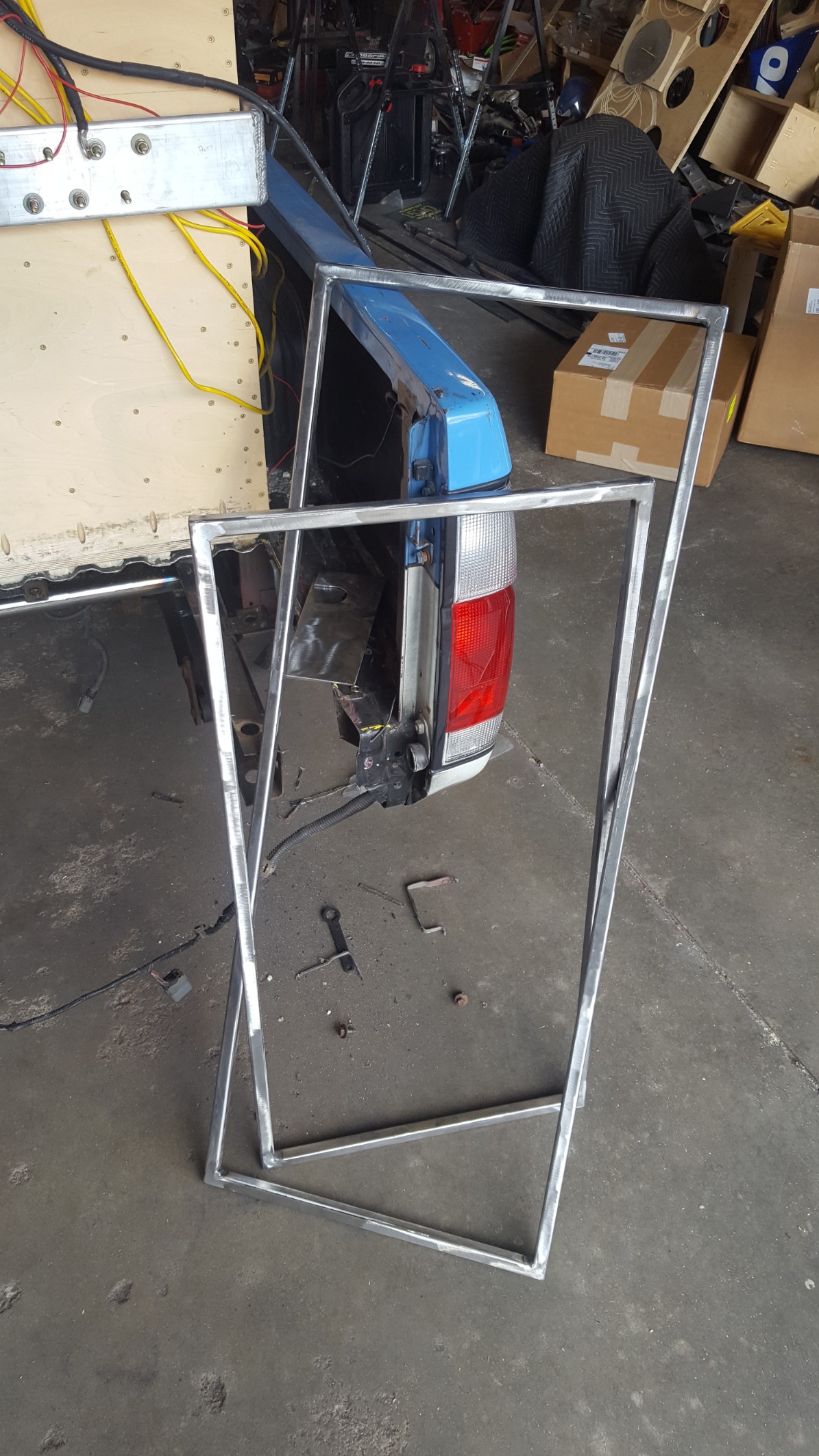

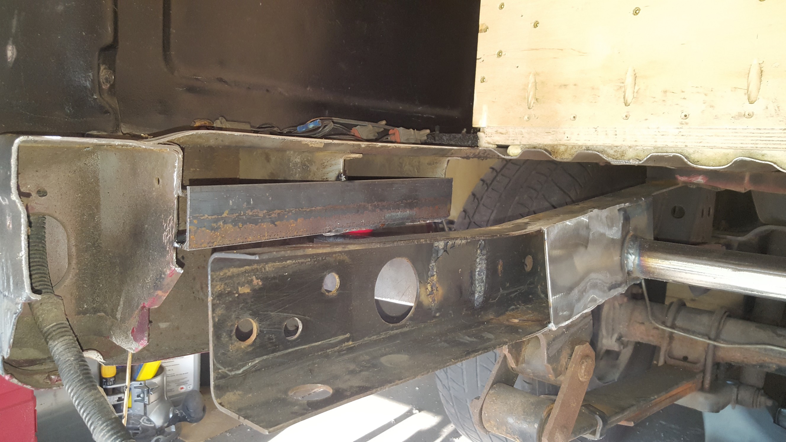

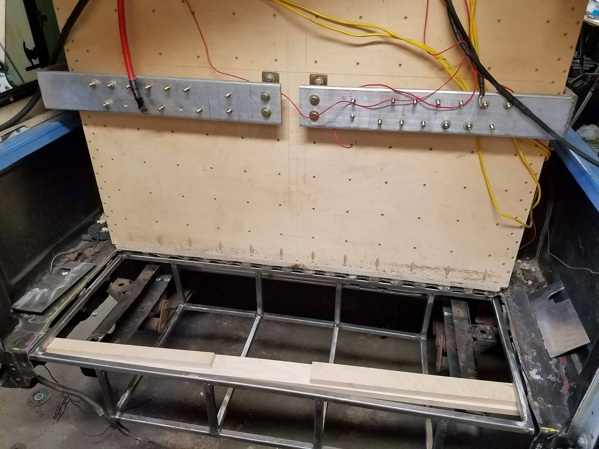

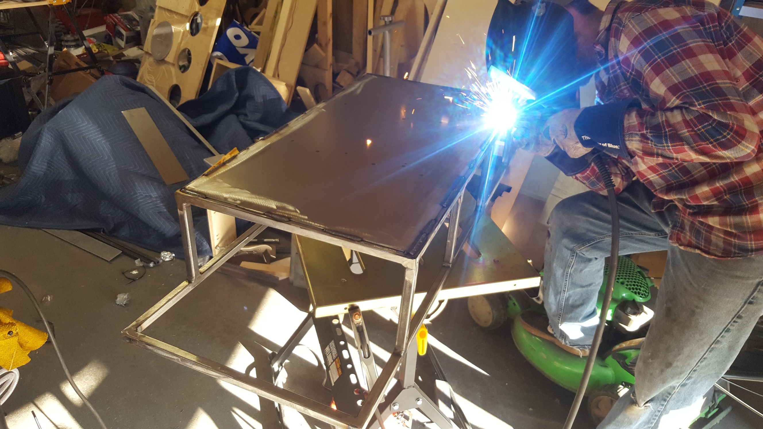

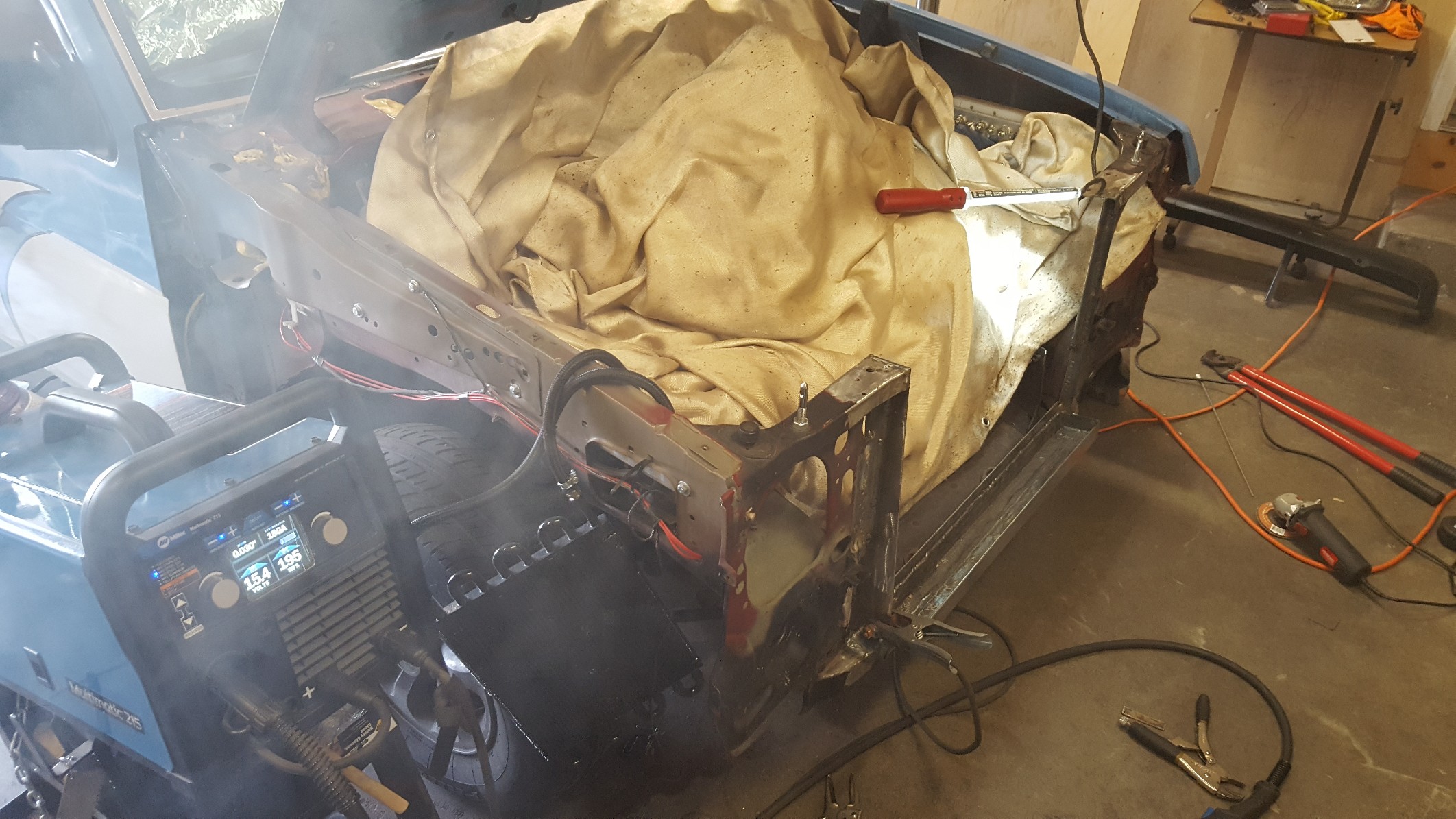

Jeremiah stopped by to give me a hand and welded up the upper and lower capacitor tray frames

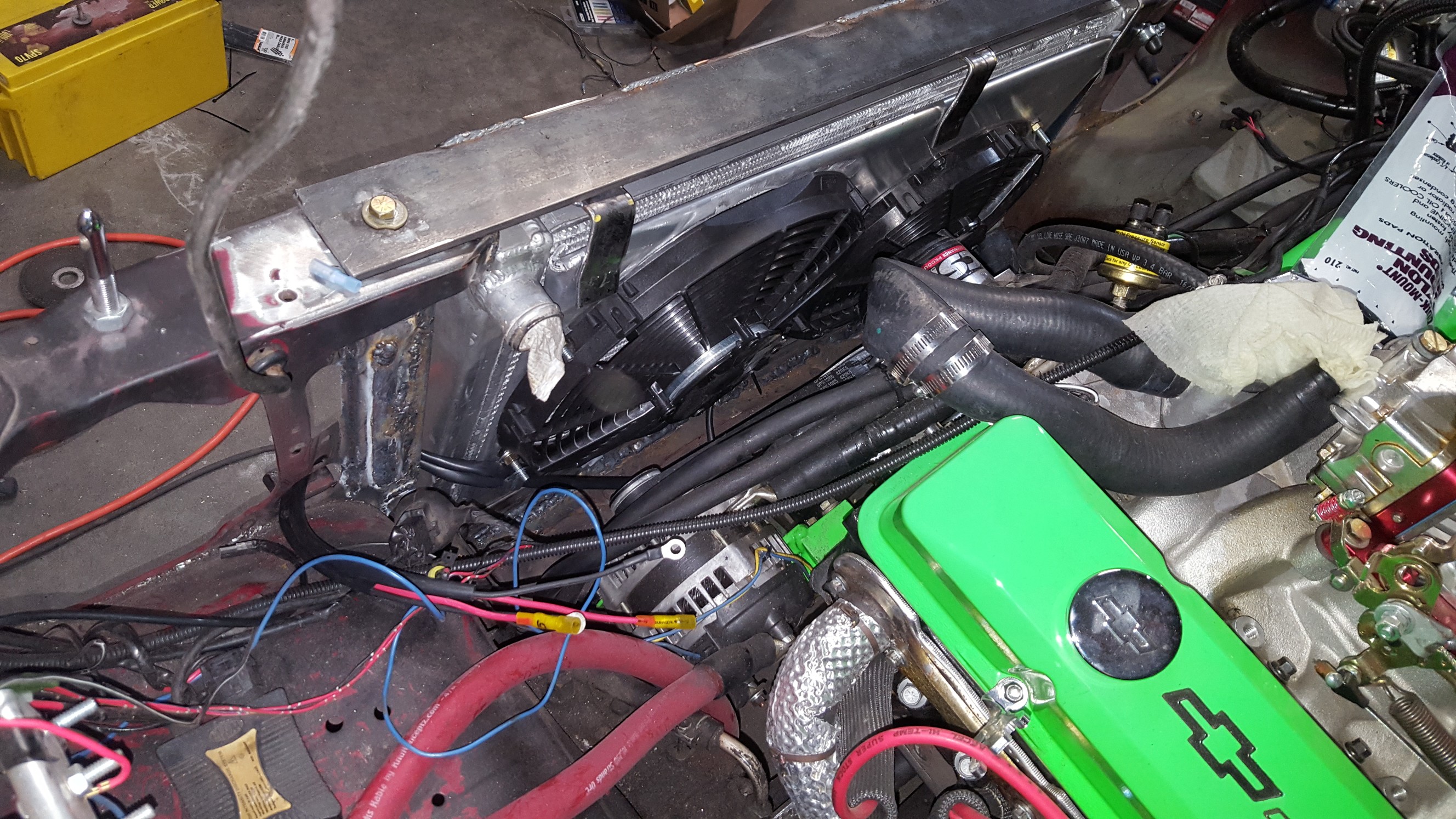

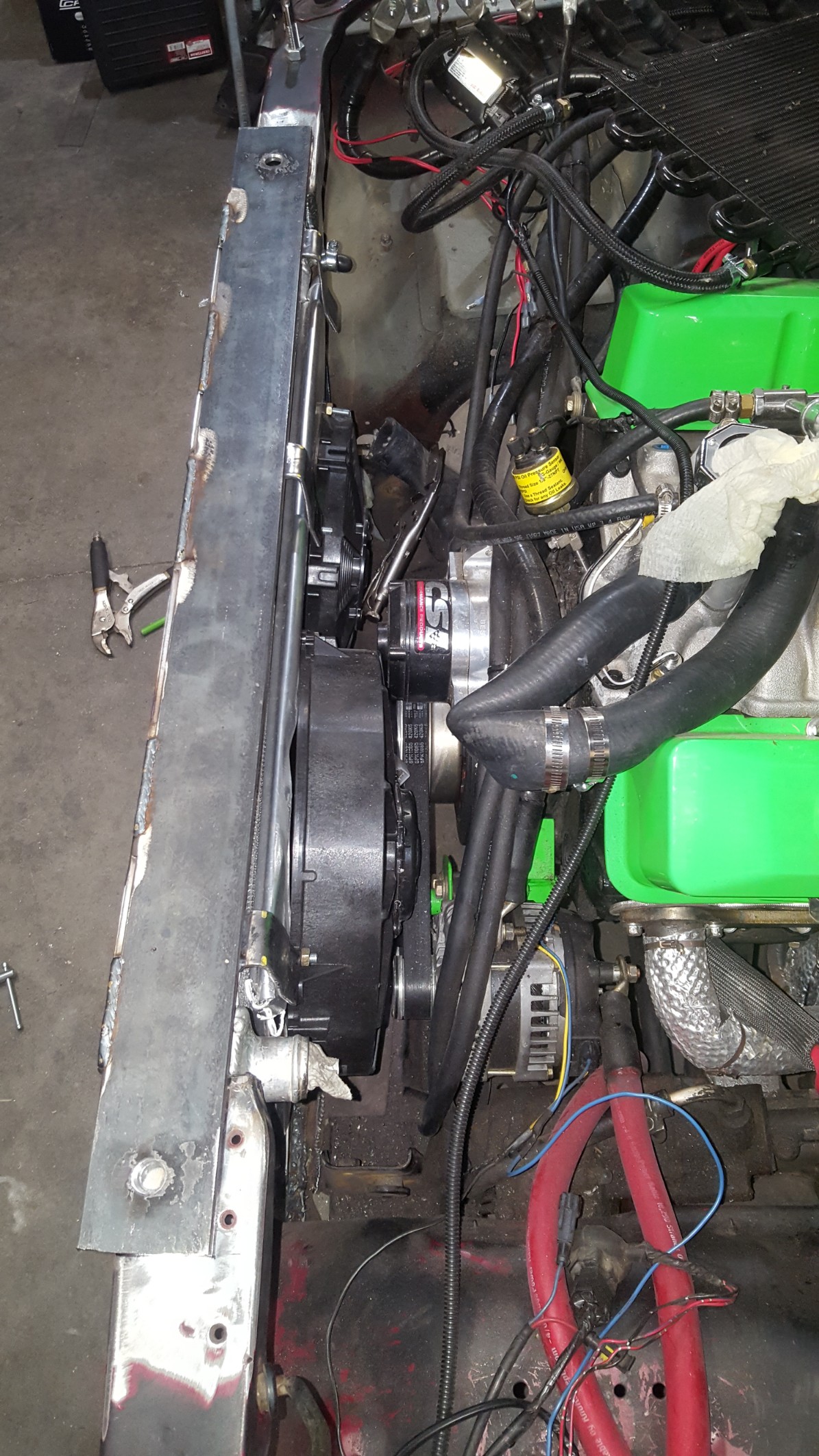

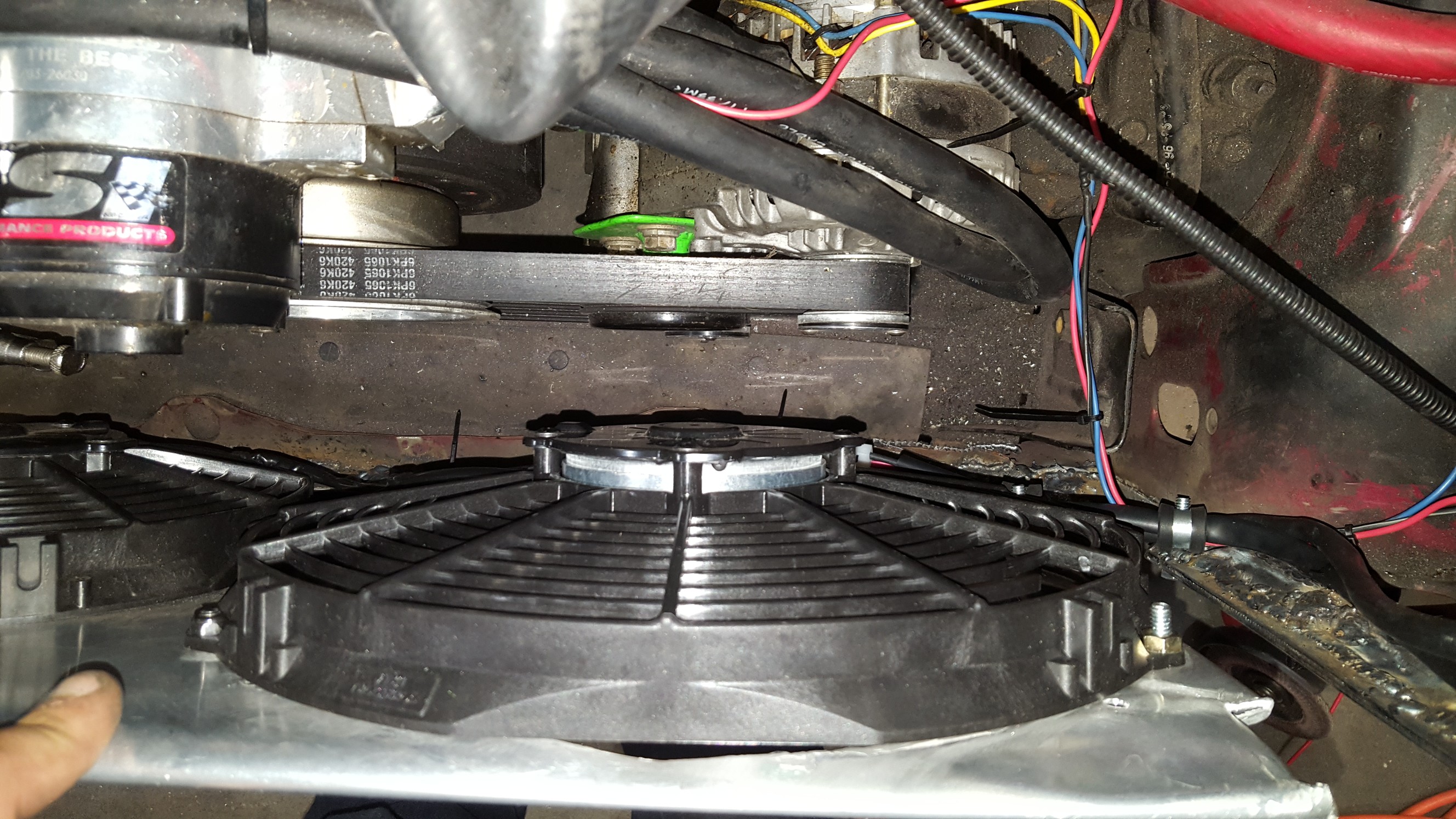

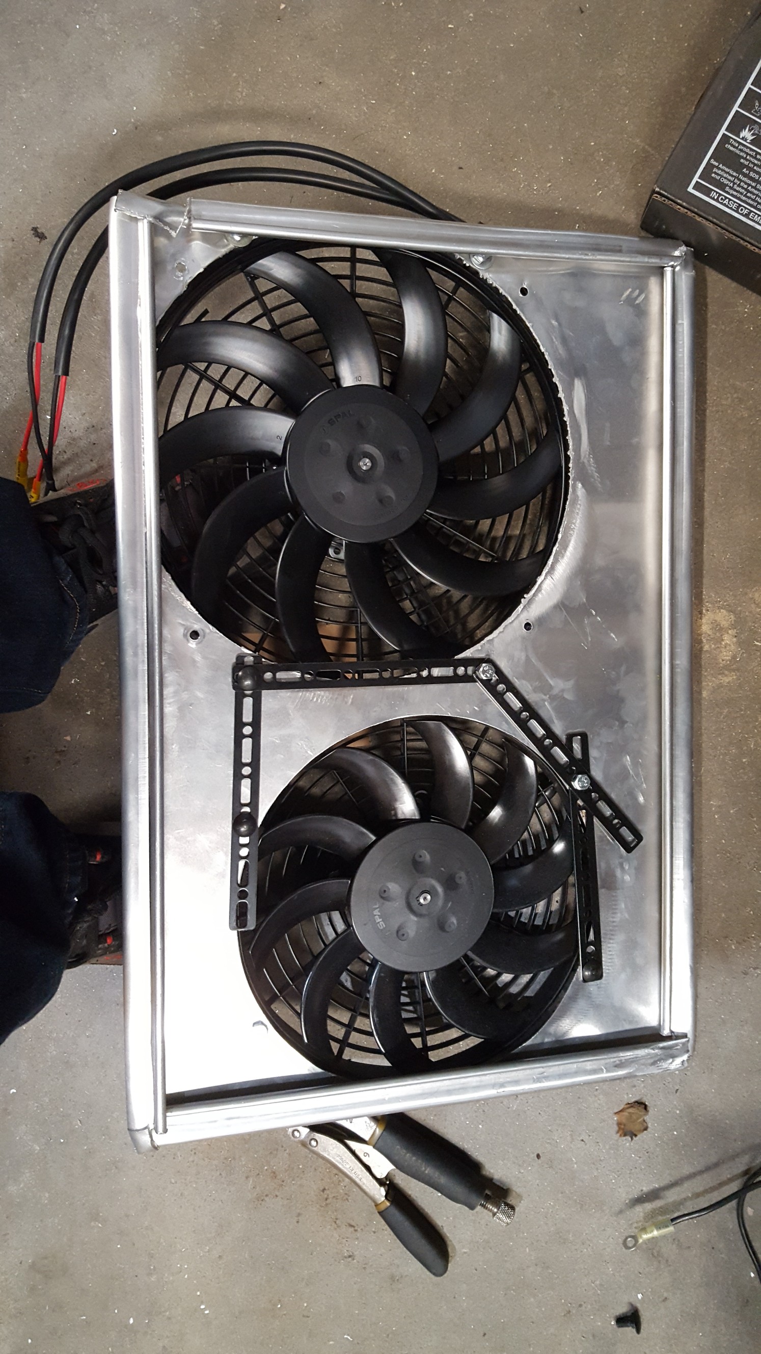

He also made an upper radiator support. It holds the fan shroud to the radiator at the top too

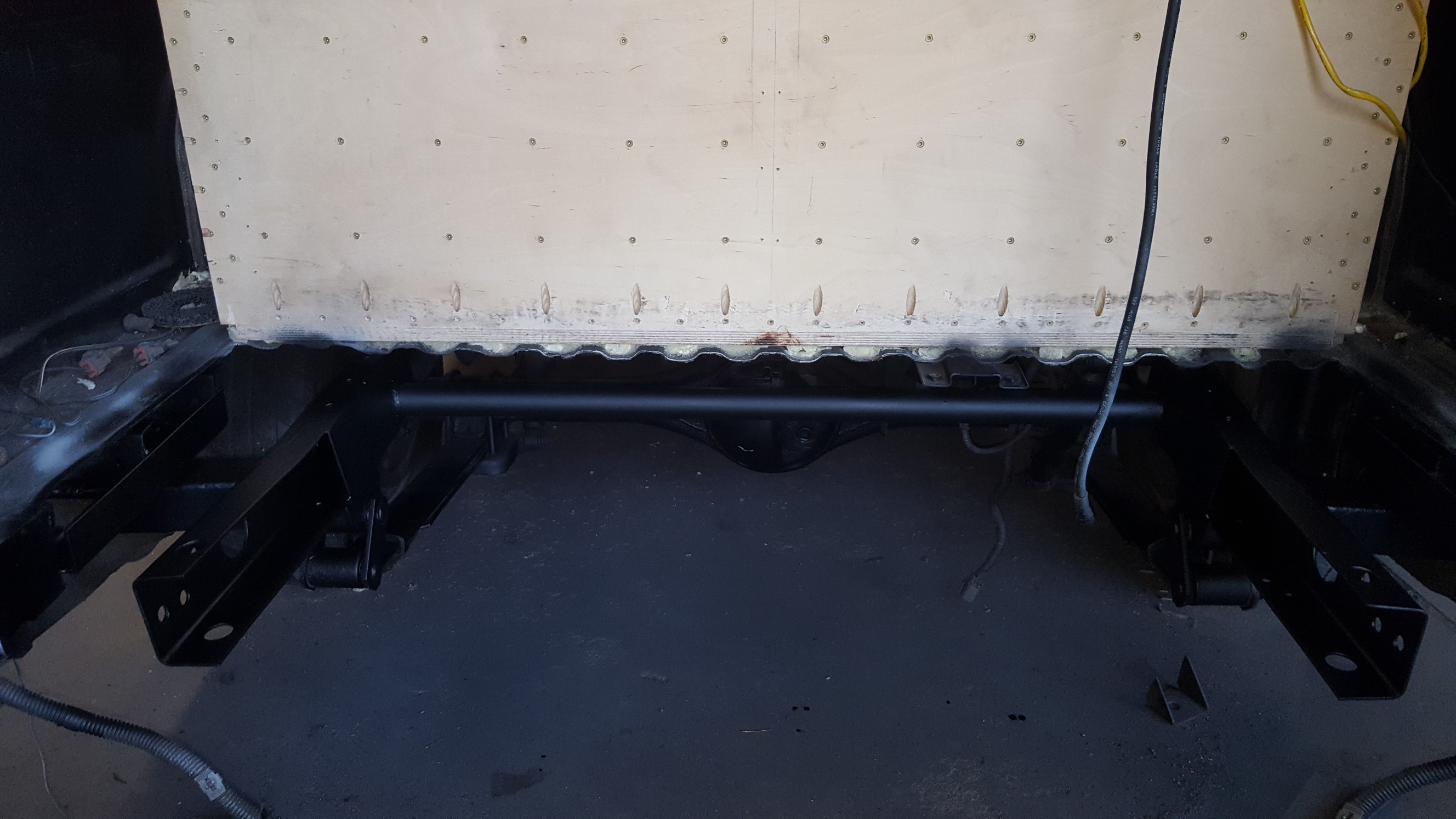

Fans have plenty of room now. Just need to add bolt holes

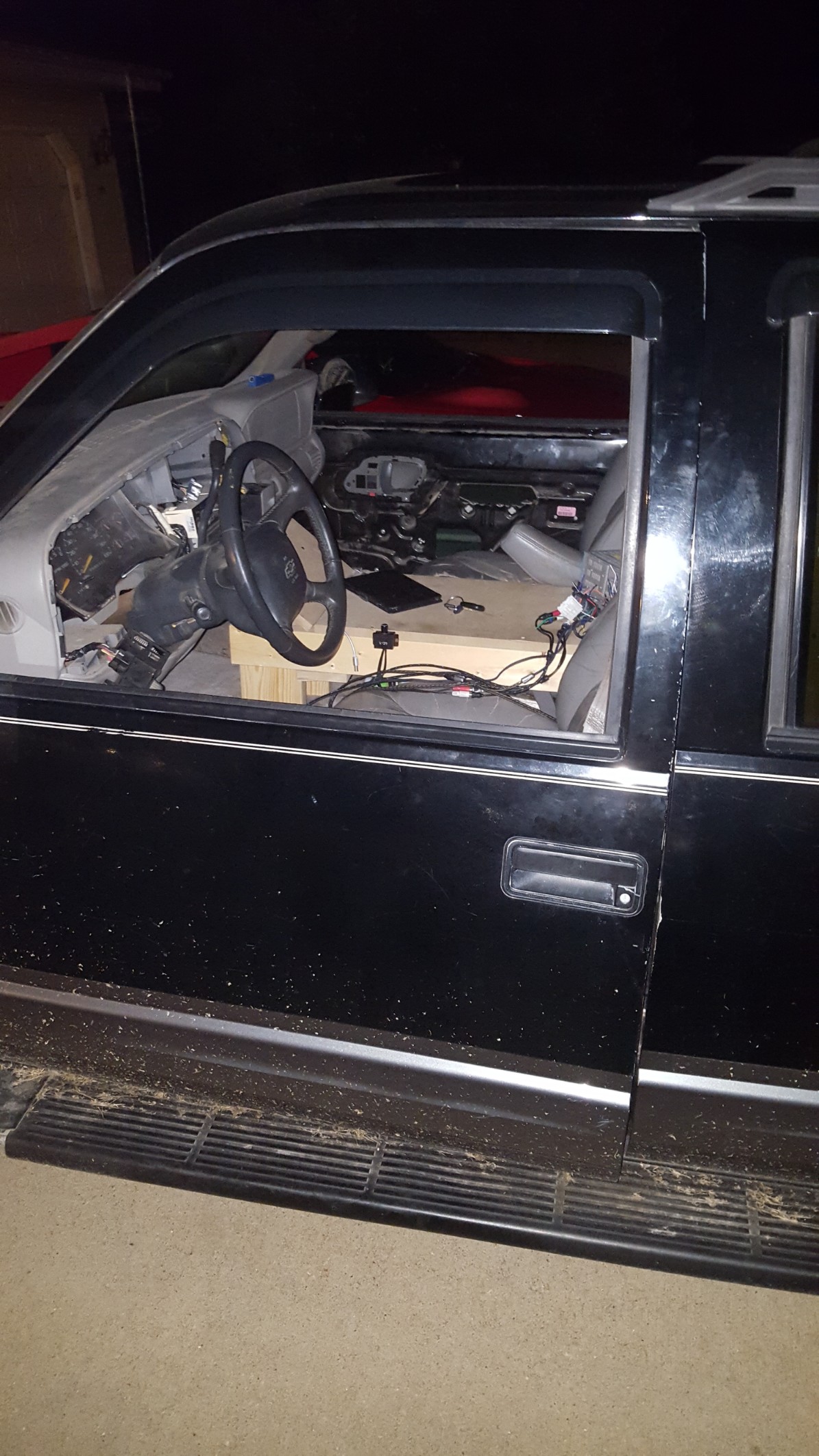

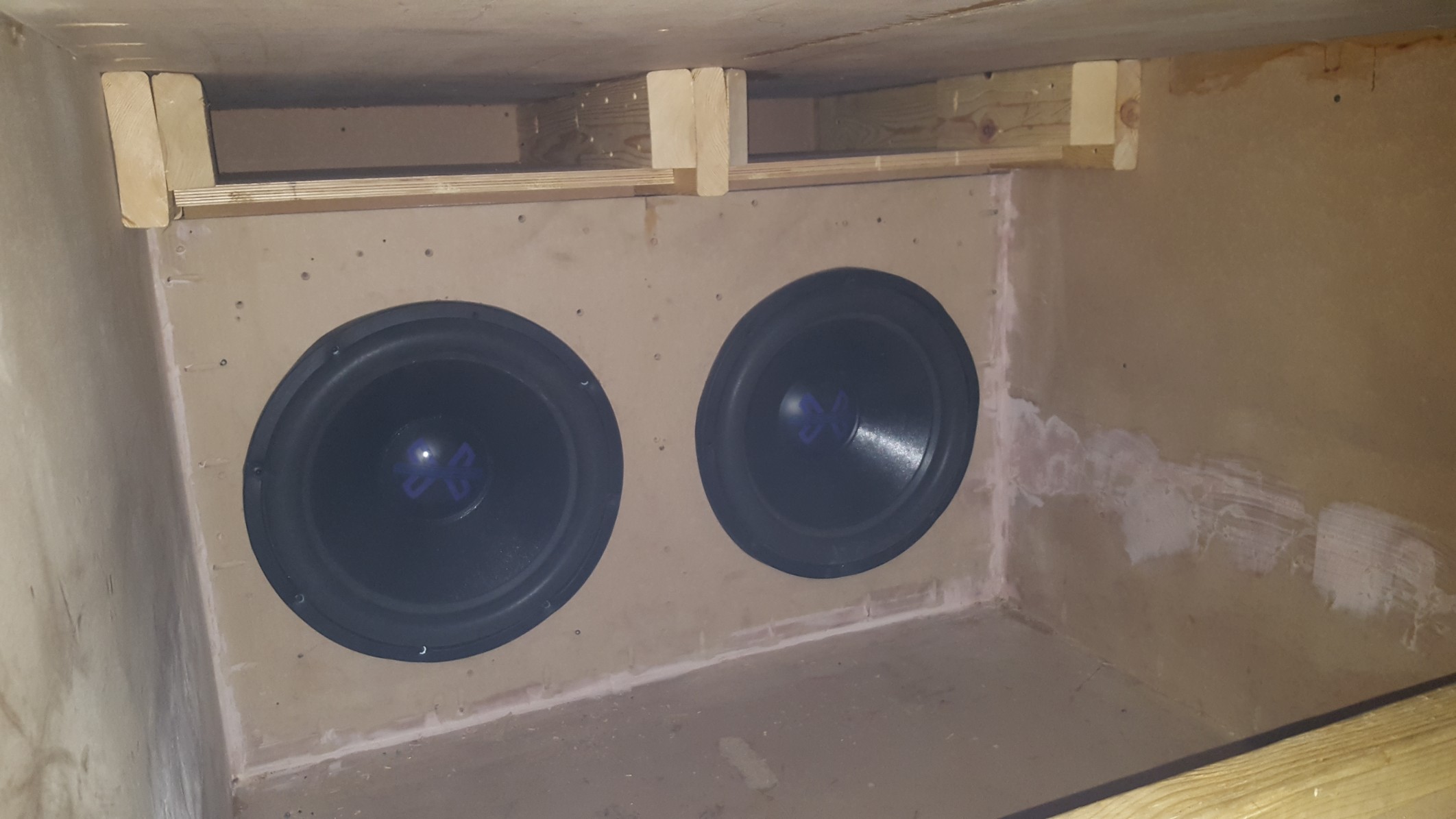

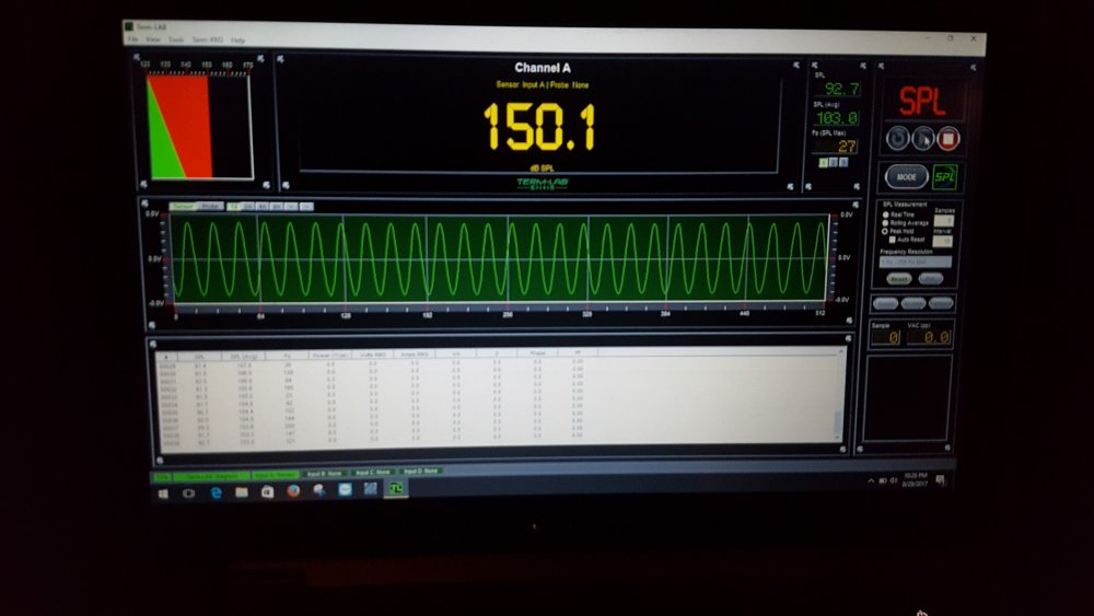

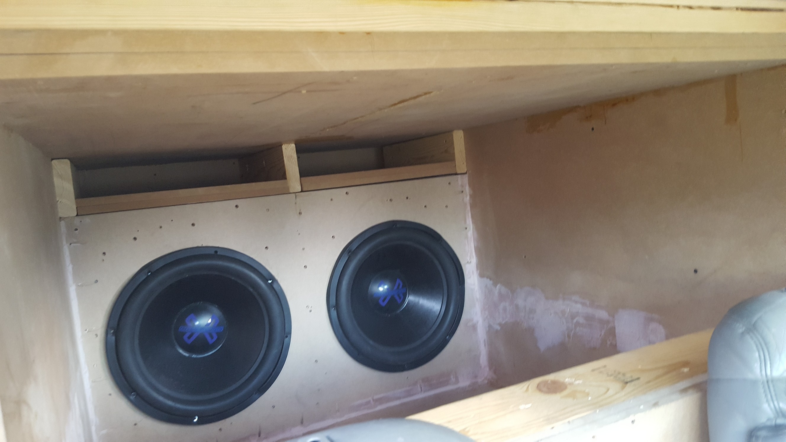

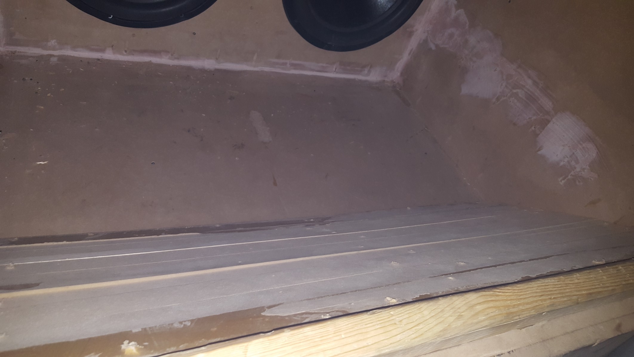

My buddy Tom and I took some time to further adjust his 6th order tuning in his Tahoe (enclosure is temporary, don't mind the ghettoness, it will be redone lol).  Lowered tuning of the rear chamber, increased tuning of the front and sealed off the bottom of the wall.

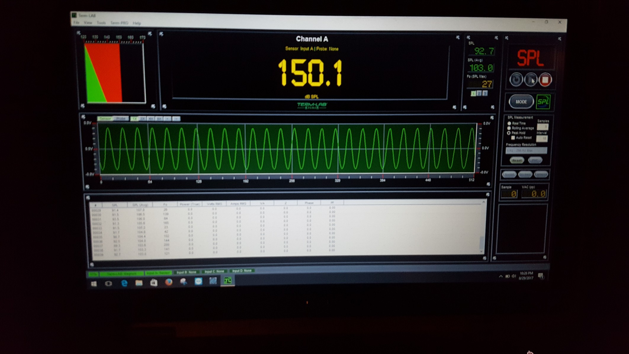

 It didn't gain on the meter with me in the truck (further verifies the truck is losing pressure), even though it's much louder and windier. We did manage a 150.1 at 27hz by me getting out of the truck though
And also broke his driver door hahaha

Did a little more fine triming and a test fit of the upper cap box frame

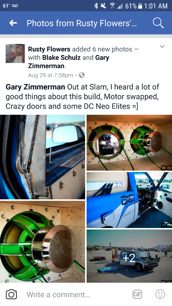

Oh and Rusty showed Project Flexington some love too!

About to head over to my testing spot to meter my buddy's series 6th order I'm helping set up (his tuning is quite a ways off from what I told him due to some factors he didn't take into account). We changed the front chamber tuning a bit to get it closer to where it needs to be but still about 10 Hz from where I want it. The small change made a hell of a difference already though!

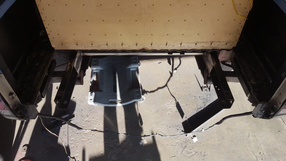

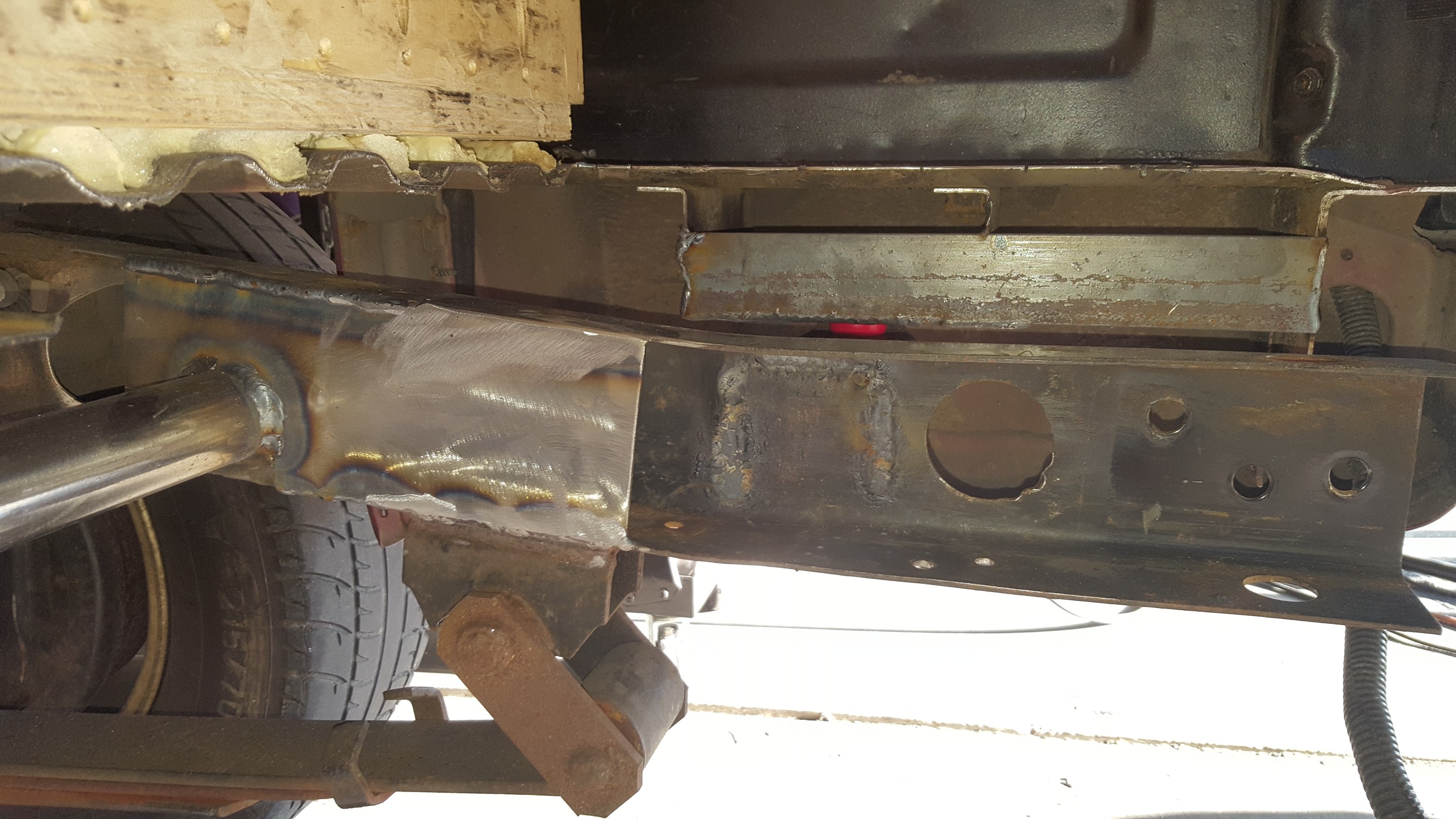

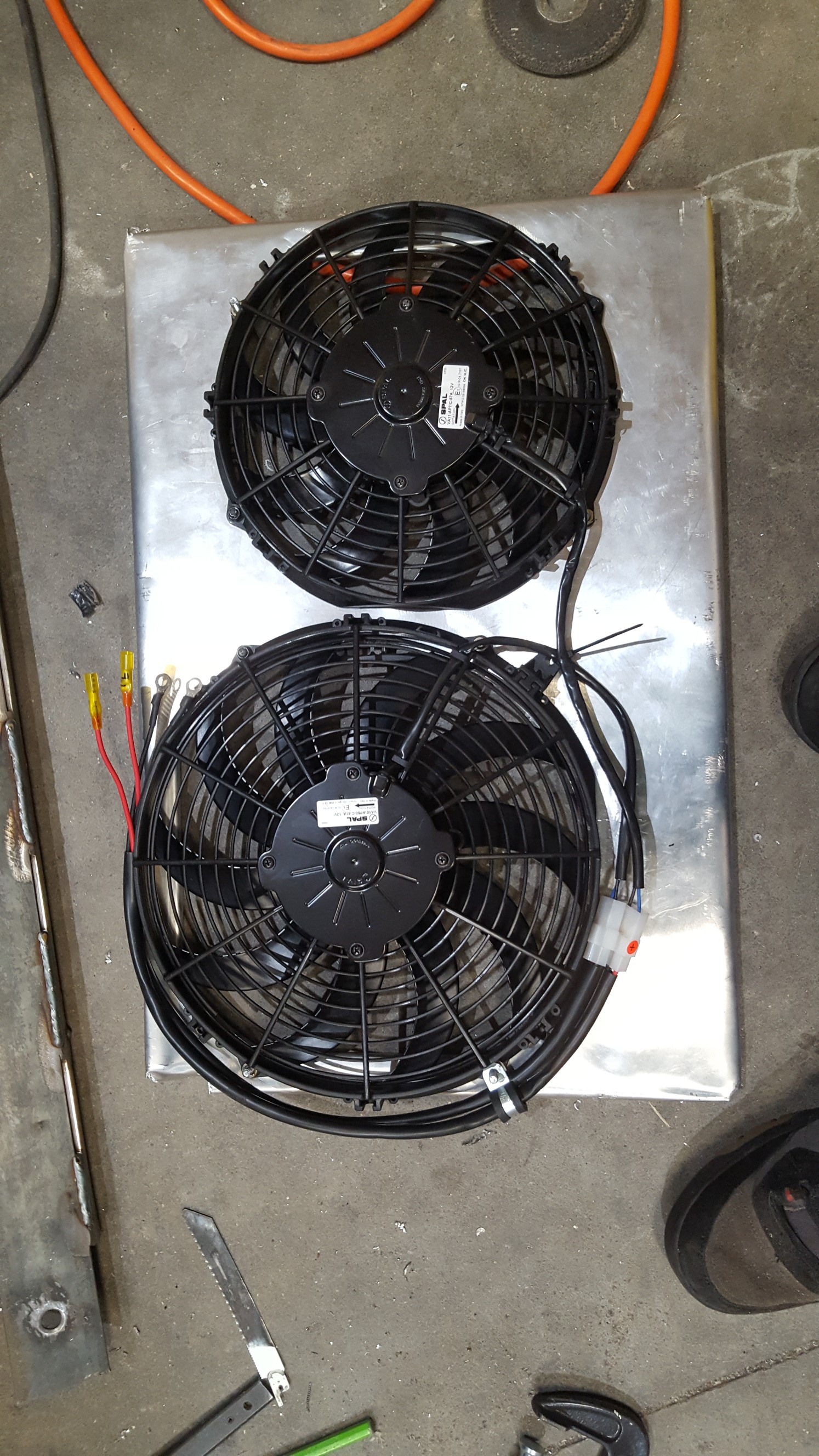

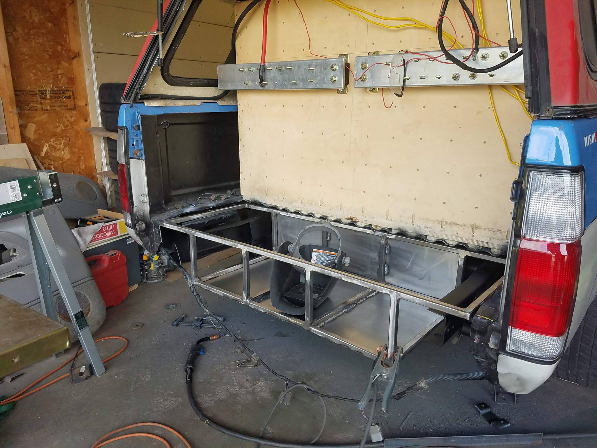

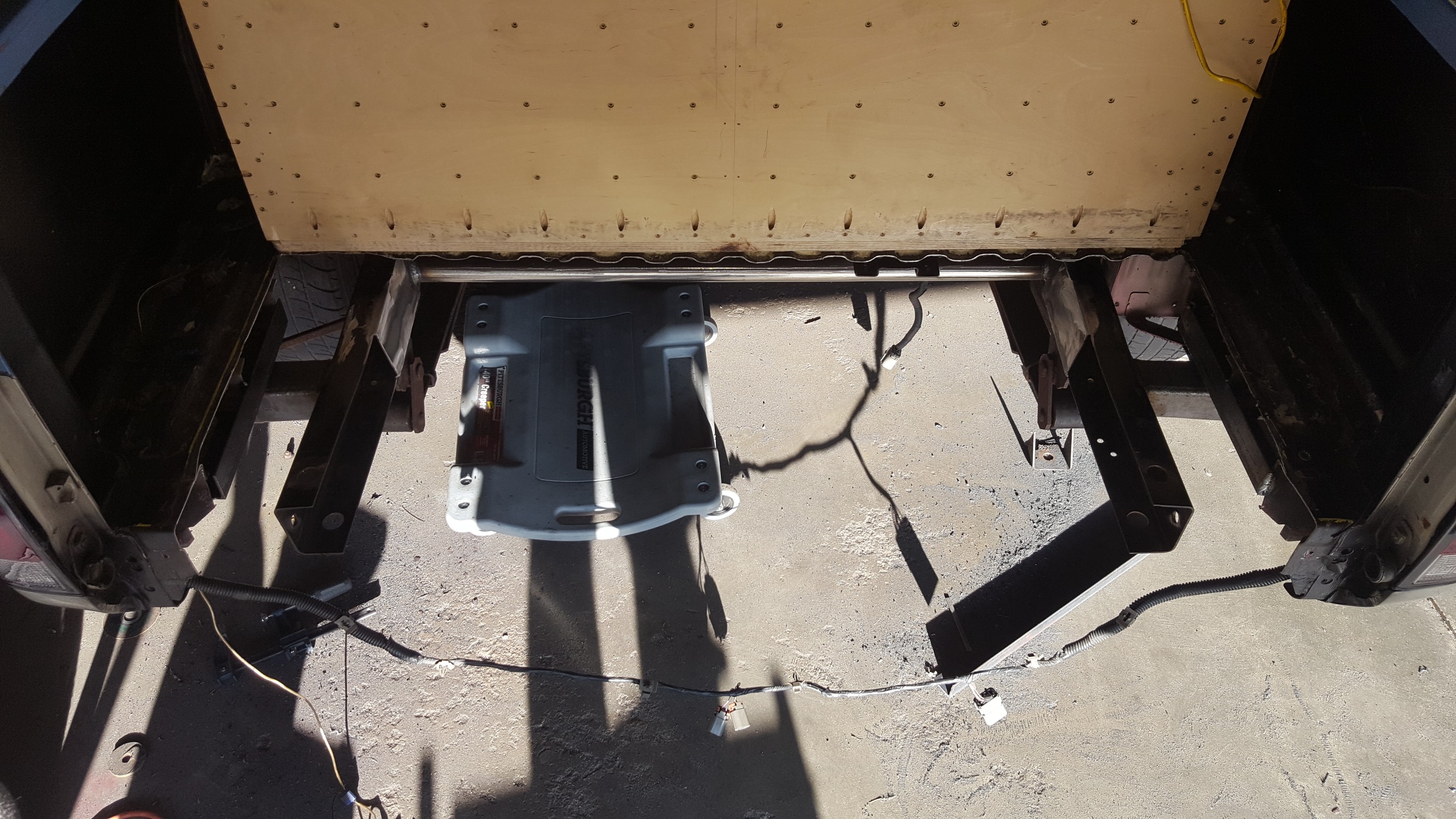

Lot of progress in the last 24hrs, pretty exhausted so I won't be going into much detail, but got the fans wired, temporary shroud strengthened, 12" fan swapped for one that allows for much more clearance and we're finishing up the rear end right now.  Going to hold off on making the amp rack and most likely do it next week instead as time is getting short.

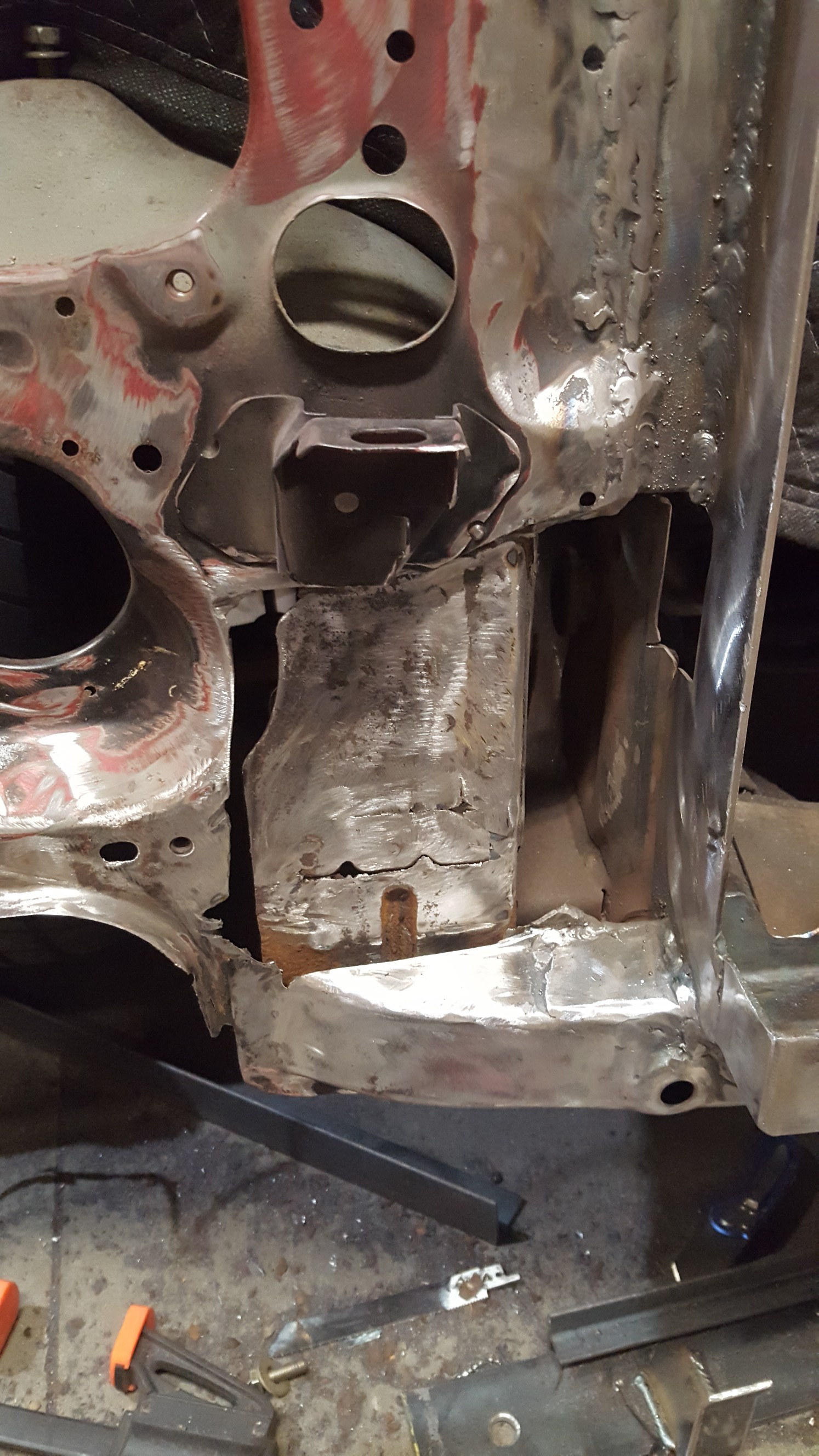

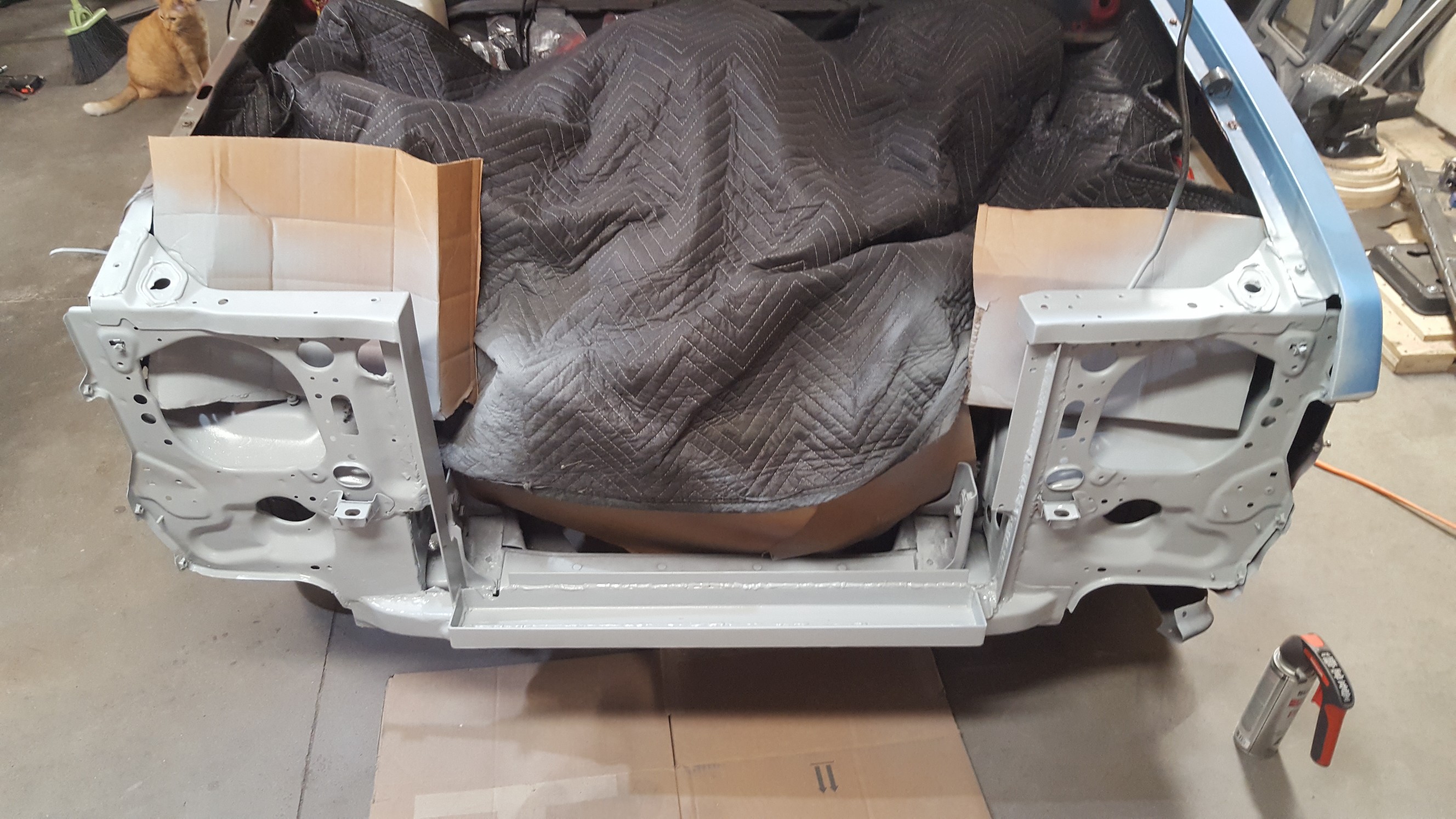

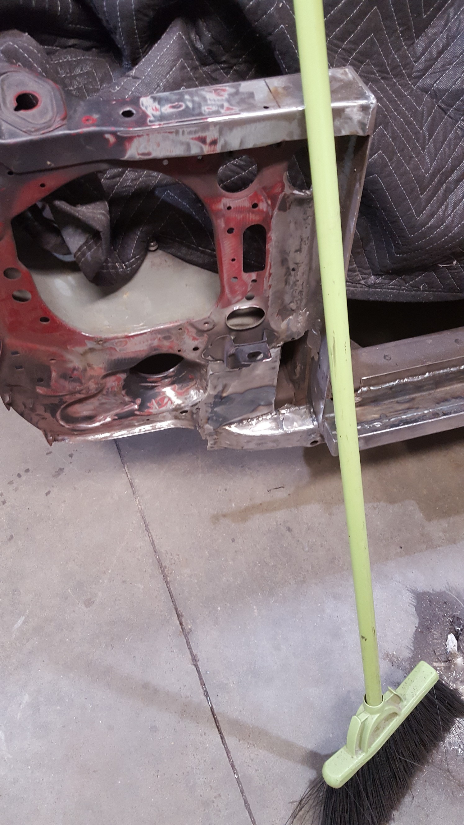

Was cleaning up the front end in preparation for paint and kinda got carried away on the one spot of rust on the truck (battery tray is right above it) and ended up taking off nearly the whole panel lol. Like, I really needed another project right now lol. Anyway, as much as I wanted to rip off the whole panel, I forced myself to stop here:
Did a bit more cleaning and welded a 16ga panel on
Prepped the rest
And shot a few coats of primer on

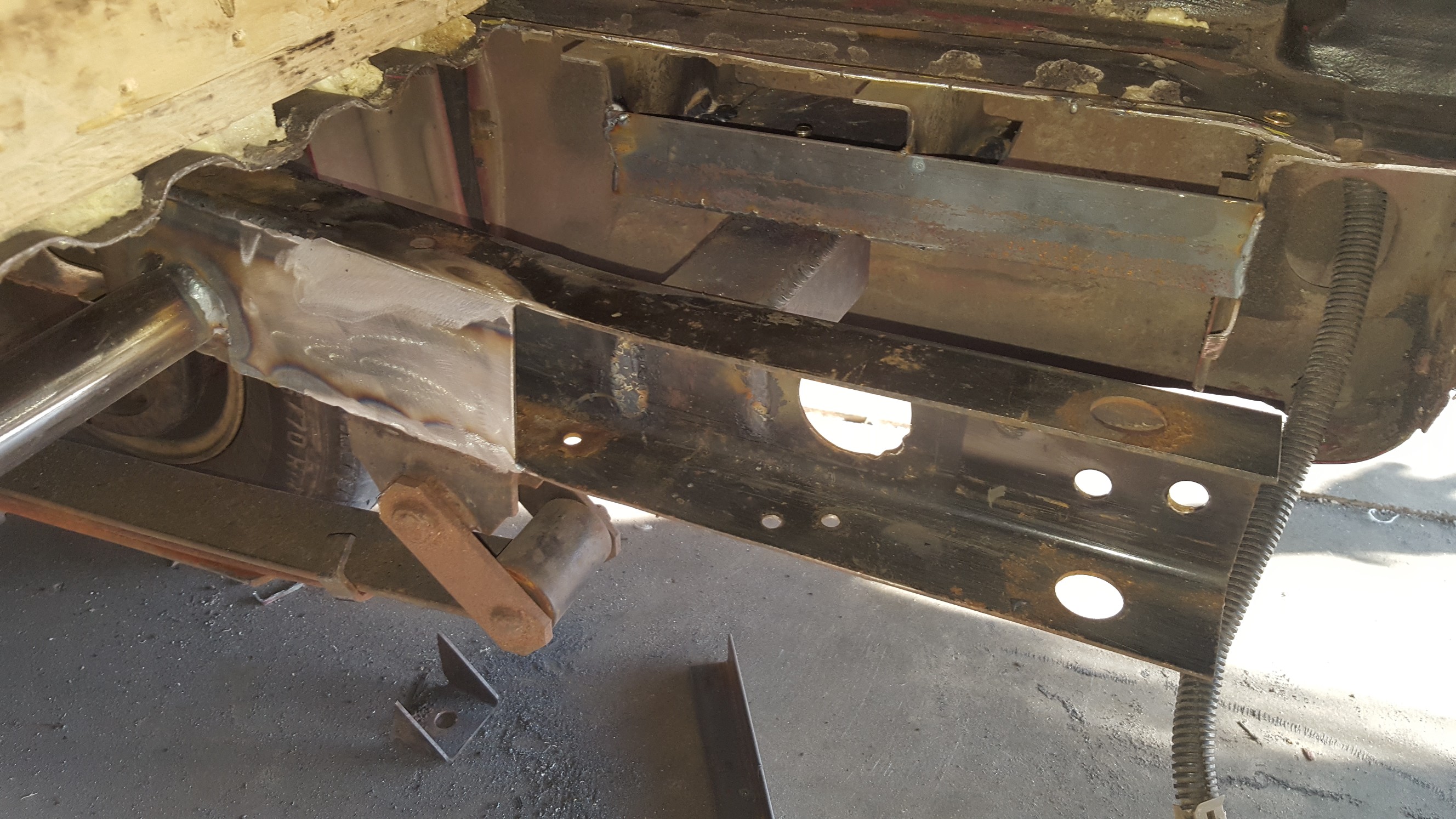

Currently about to put on the third coat of semi gloss black as well as starting on the top coats under the rear of the truck. Figured it'd be easier to paint the crossbar and new bed mounts without the capacitor cage in the way. More pictures to come!
Managed to finish painting after a 2hr nap. Hoping to wrap up the front end tonight, seal off the wall and get the interior back in today. Capacitor box should be done and hoops for the amp rack today too. Hoping it goes smoothly cuz I'm running outta steam lol
