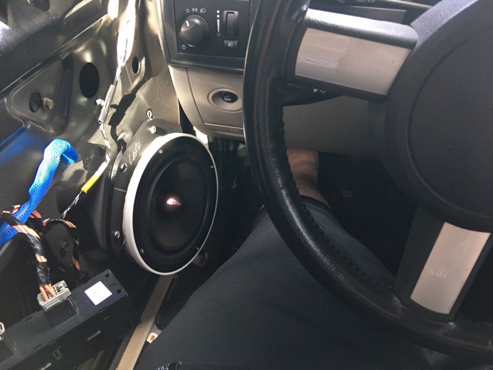

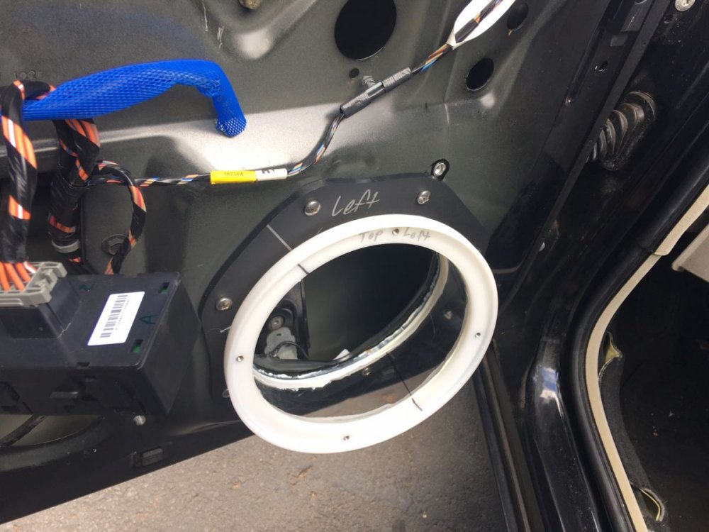

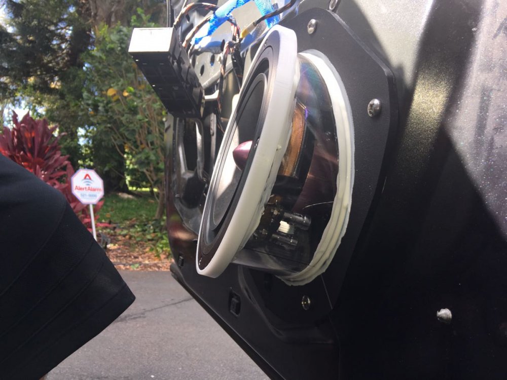

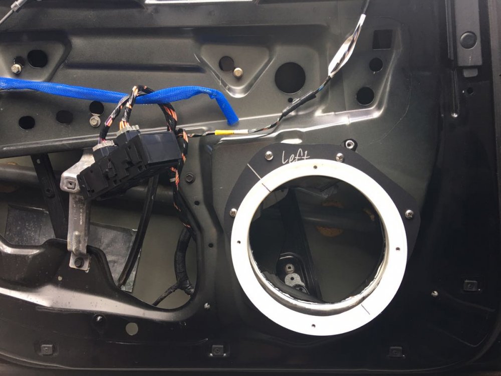

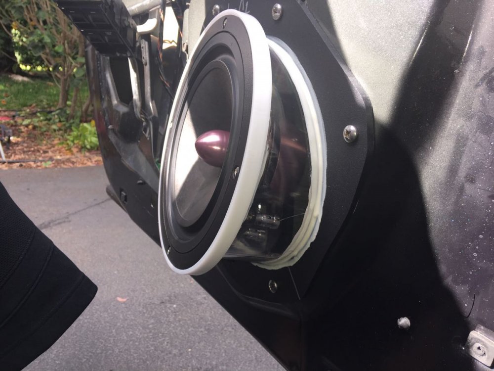

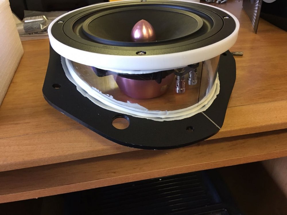

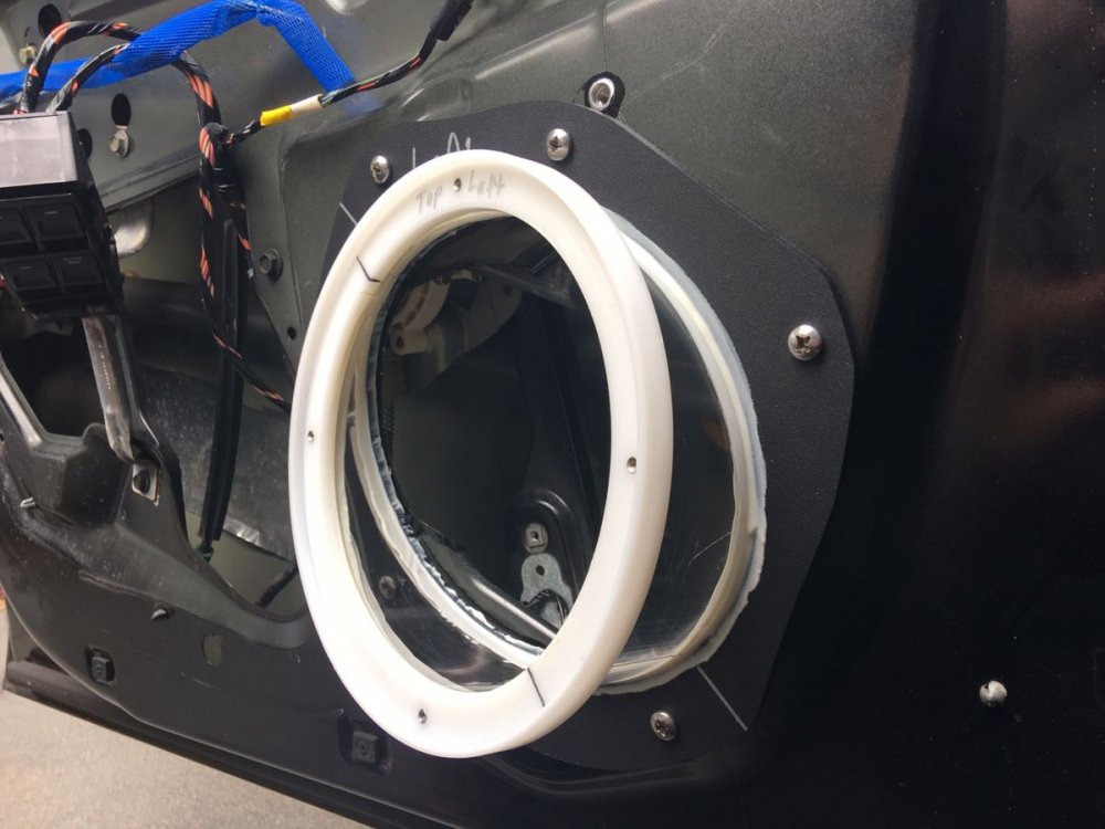

Let the adapters dry for a few days, mounting the speakers into them today. I really like being able to see thru the tube to see the push terminals. I can see/check that connection without having to remove the speaker or adapte from the door.
RenderedContent-71D3EE14-5ED5-441B-829D-DA084238CD27.thumb.JPG.a3f09f45d69e9ec9744fed04f46cbad9.JPG
Then mounting the adapter to the door.RenderedContent-96406B56-7DD3-48F2-86AE-A1EDF0DC317D.thumb.JPG.51903fbe807d76a7f8b81af267feaba8.JPGRenderedContent-66055458-A3C3-4117-B6F6-16E16B18B1DD.thumb.JPG.c7de4bf5cc26e4d6b7cd51722547c2a3.JPGRenderedContent-2DBE05A6-C054-4B16-A234-8C95F78C50A6.thumb.JPG.66d27200ffe1f41ef9743498bc2b73ad.JPG

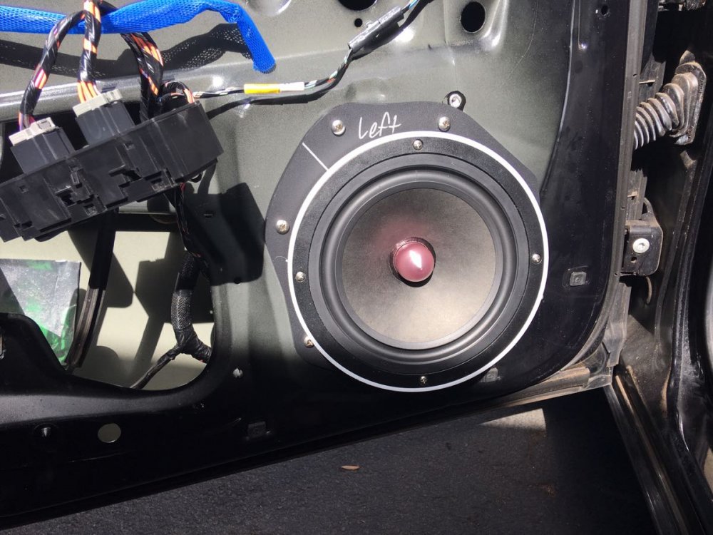

Now mounting the speaker to it all. Perfect. Didnt turn out to being as on axis as i thought it would be but i like it. It should make some sort of difference rather than being pointed directly at my ankles. Also again you can see the push terminals clearly even when its all mounted up.

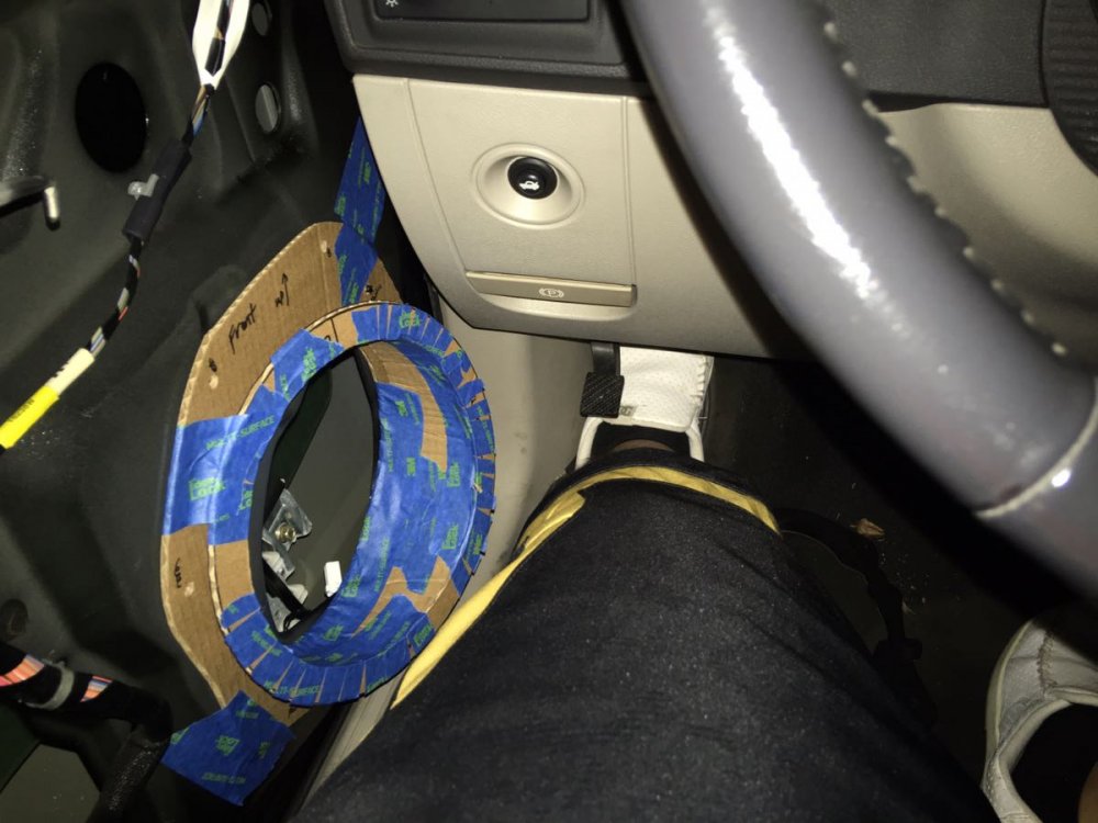

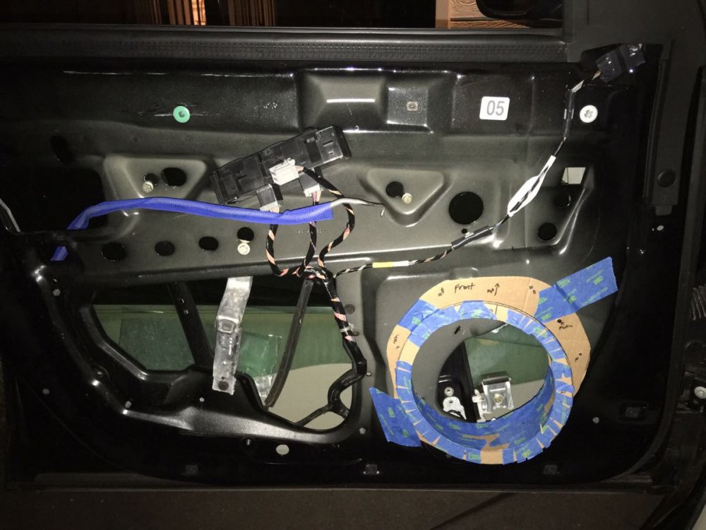

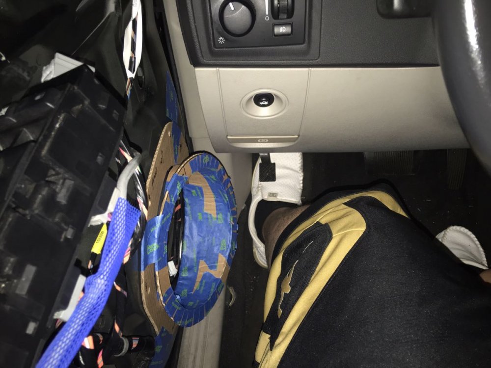

Cardboard to plastic comparison.

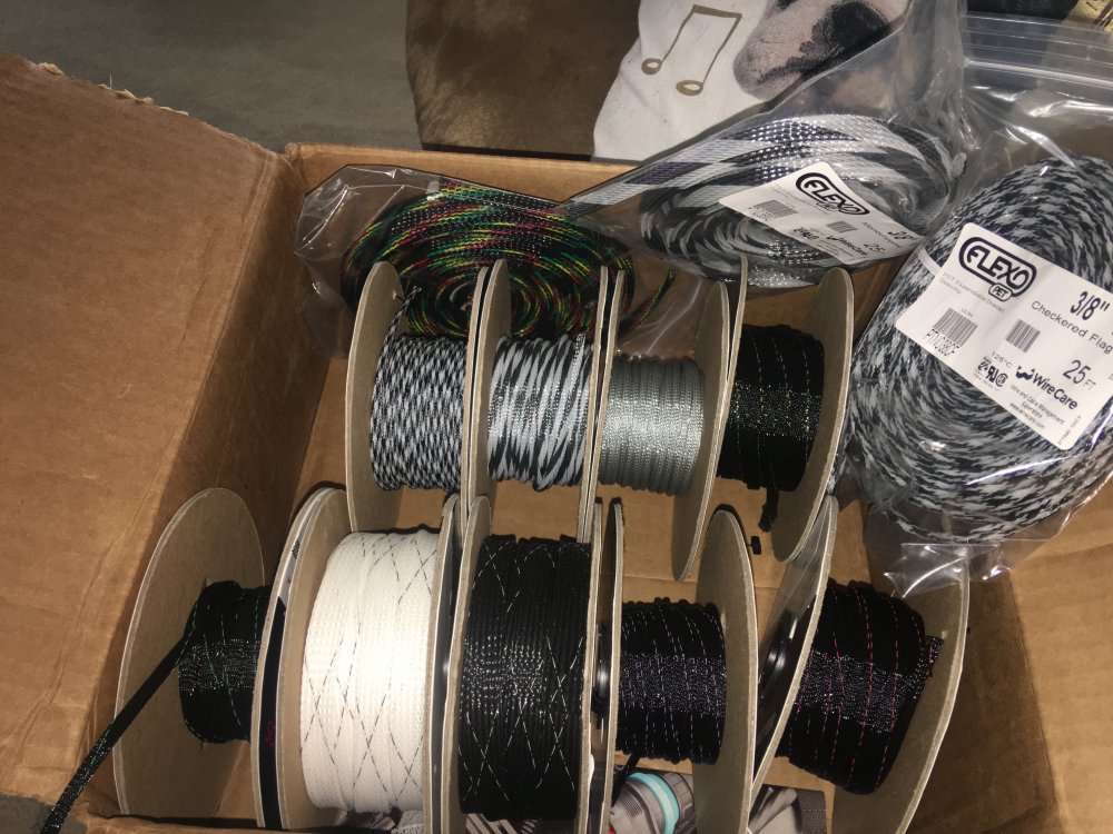

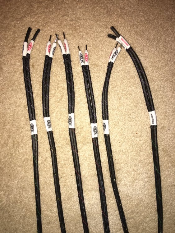

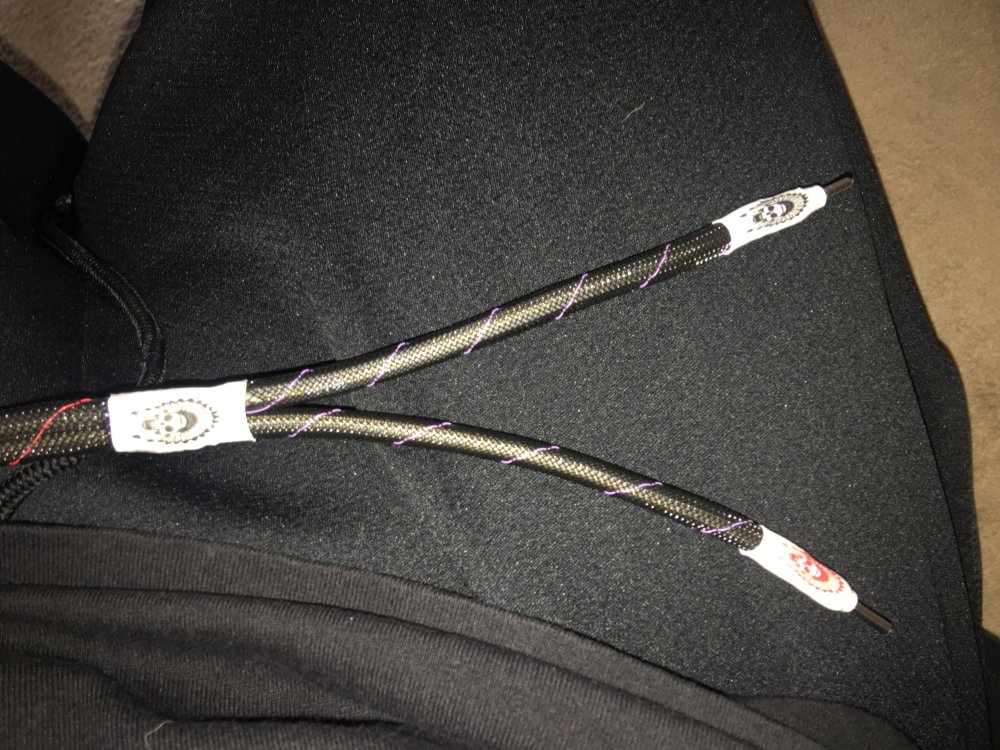

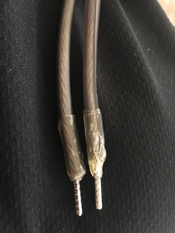

Start off with some wire preping. Using Knuconceptz ofc 4/0 red+black, Stinger pro series ofc power wire 1/0 red+black, Stinger matte ofc 12awg (for tweet+4in) and 10awg (for 8in) speaker wires, Ancor Marine Grade ofc 12awg black+yellow and 14awg black+yellow+white and 18awg blue, assortmen of techflex, wirecare heat shrink with custom print (non-adhesive), wire ferrules w/ferrule crimping tool, adhesive shrink tape for non-adhesive custom printed heatshrink.
Making some custom 3 speaker wire cable bundles. Tedious work.
All front stage speaker wires done, just waiting for my 10awg ferrules for the 8s. Black techflex with single spiral stripe of either Red Yellow or Green for the three front stage speakers, green mid bass, yellow mid range, red highs and used the purple stripe for the ends where the wire splits into two.Then for my sub speaker wires ill be using that black techflex that has all three stripes on it, red yellow green on the black. Love the roots reggae music.
