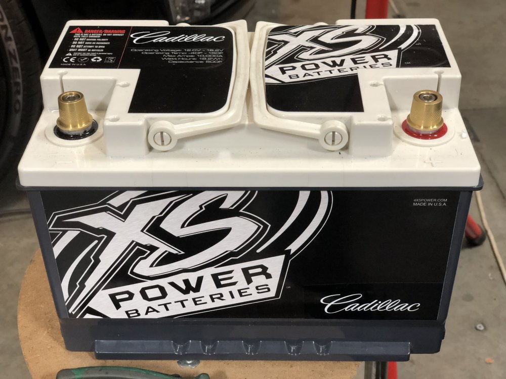

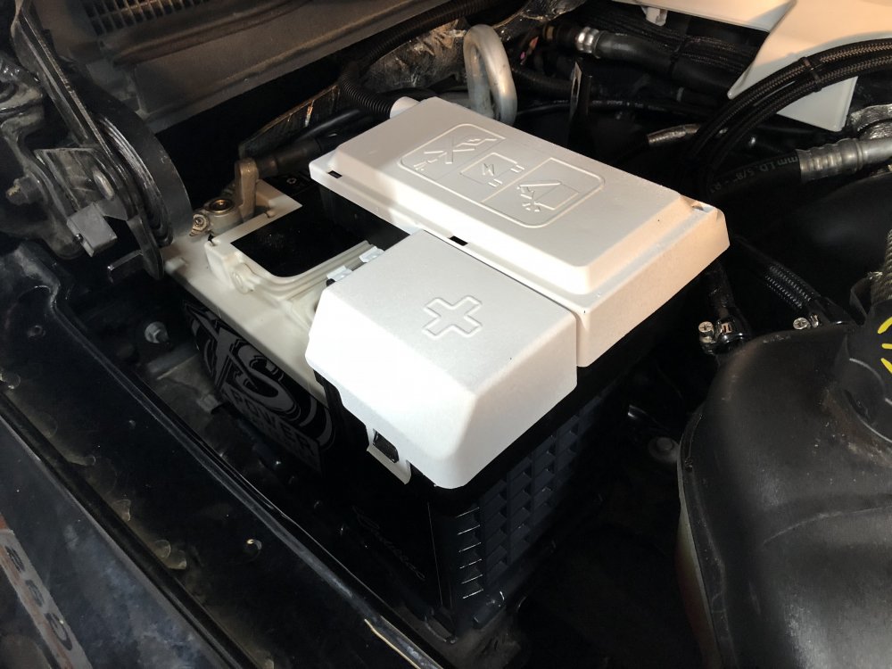

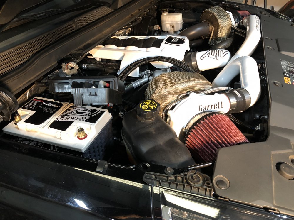

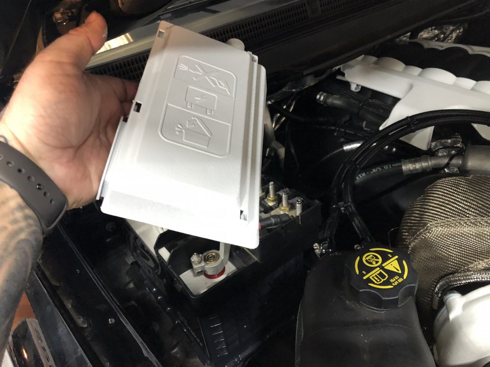

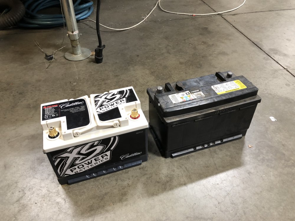

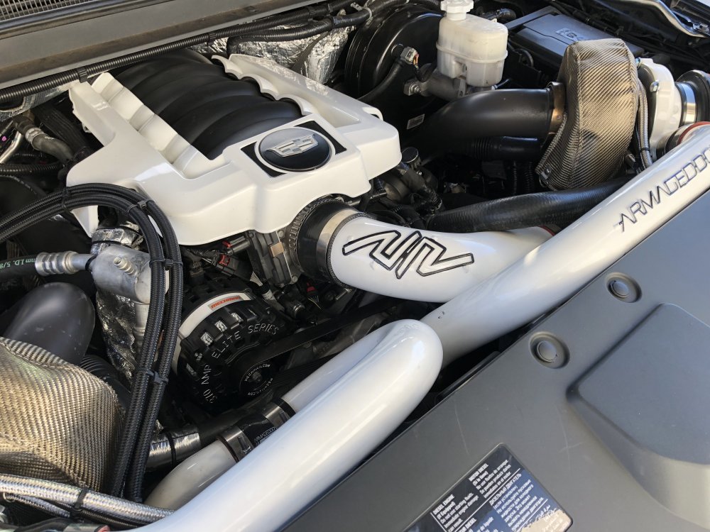

Ok lets get this started.  Today i planned on putting the alternator AND the battery in, but the alternator, although in a very easy spot, was kind of a bitch.  I had to remove turbo intake tubes to get one of the bolts out. I also had to cut a notch in the valve cover-cover (a plastic trim piece).  I could not get any special wiring done yet. I am waiting on my Skyhigh wiring to arrive and it isn't here yet.  I am planning on doing white for positive and black for negative. It is a special order since he doesn't carry it anymore so i am just waiting on it.

Alt matches perfect ,can’t wait to see the build.
Still cant get over how much shit you crammed into that engine bay lol, and it looks like it all belongs.

That outdoor nighttime engine bay shot looks wicked Steve!

Steve, I cant tell for sure, but does your alt have a 2 pin regulator?  I figure all the new ones have the Regulated Voltage Control setup.  Im wondering how the caps like the voltage swings, if you have any.

Awesome. When I saw the red an black battery caps my first thought was those would look sick painted. At least the red one painted white. Then bam a few pics later..... Painted white. Looks badass man.
