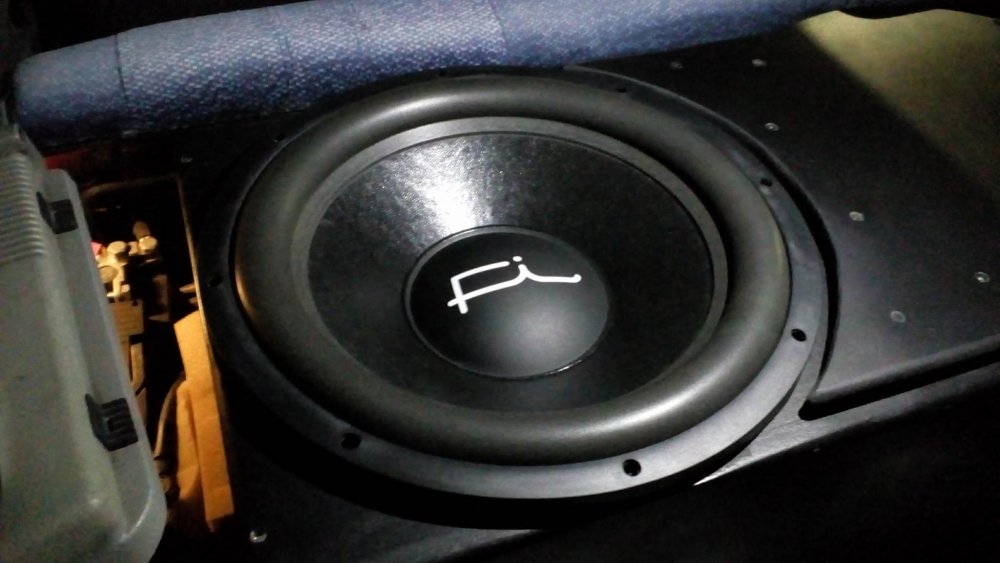

Antoni Čović Posted January 29, 2018 Report Posted January 29, 2018 Hello everyone, I didn't see any similar topics on forum so I thought I will open one.. So the point of this topic is to post your watt clamped results from your system. You can post pictures or just write.. It would be cool if you wrote your equipment: amplifier, subwoofer, box size and tuning, electrical and then post your clamped results. You can post a picture or video of your system too! If you don't know how to measure your watts look at this tutorial: http://ddaudio.com/faq/clamp-testing/ So let me begin.Amplifier: Hifoinics BXI6000DSubwoofer: Fi audio Q 15 wired to 1 ohmBox: 4cuft 32hz tuningElectrical: 2x 54ah battery & 75a alternatorClamp result: 1064 Watts (50 Hz)
WalledSonic Posted January 29, 2018 Report Posted January 29, 2018 1064W at which frequency? Chevy Sonic Wall (4) 15's on 10k Build Log https://www.stevemeadedesigns.com/board/topic/209412-2015-chevy-sonicwall4-15s10klithiumlarge-case-hairpin-us-alts/ (4) Fi SP4 15's | (2) Ampere 5Ks | Active! | Arc KS600.2 & KS125.2mini | CDT Silk Domes | Silver Flute 8s | 240Ah JY | US Alts Jeep Wrangler JK (4) 8's in a 4th Order Build Log https://www.stevemeadedesigns.com/board/topic/209841-shadow-2016-jeep-wrangler-jk4th-order4-8sdc-35klarge-case-hairpin-us-alts/ IG @walledsonic
Antoni Čović Posted January 29, 2018 Author Report Posted January 29, 2018 2 minutes ago, WalledSonic said: 1064W at which frequency? At 50hz. I just updated it.
