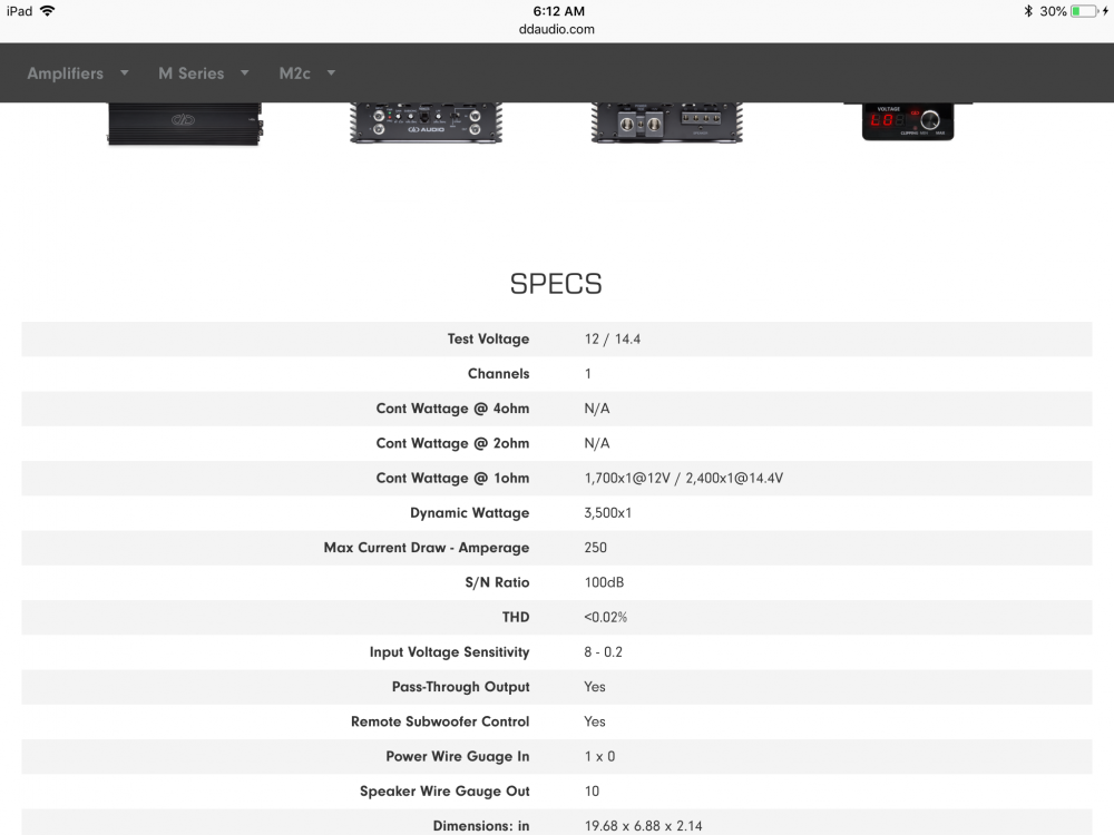

Do you think, that 1.6 volts can actually make such a huge impact so it makes half the power?
These are specs on a DD M2 amp at 1ohm. At 12volts 1700rms and at 14volts 2400rms, Big difference.
Your amp is not even close to a DD amp in quality.
