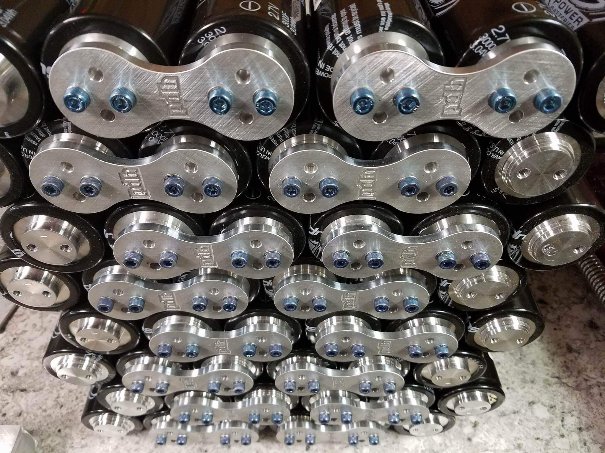

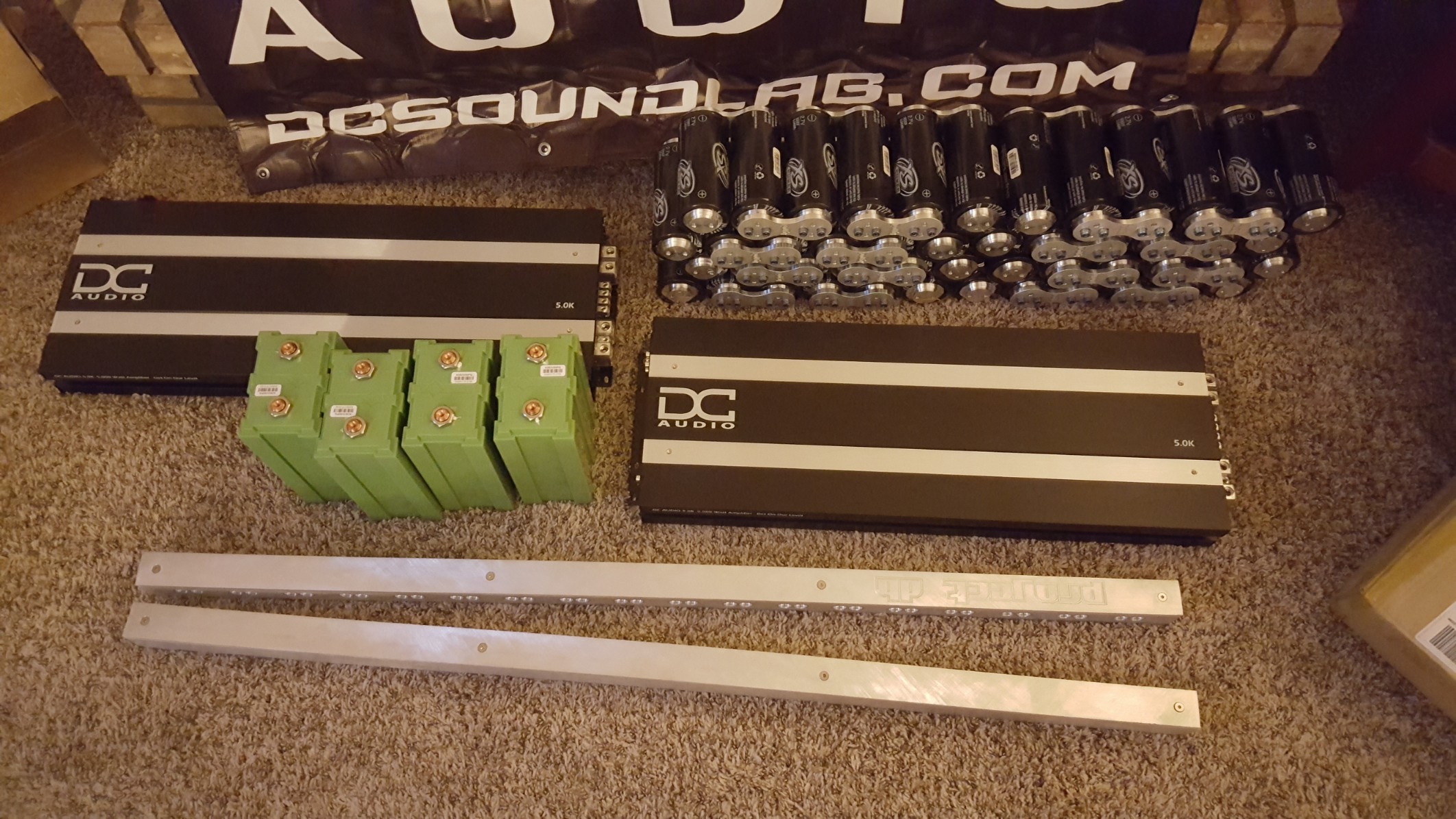

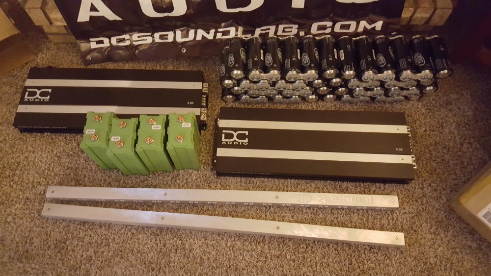

Also picked up my new caps and projectdb hardware and buds bars from my buddy Geoff (projectdb) while I was there!
Can't wait to get all 12 banks connected!

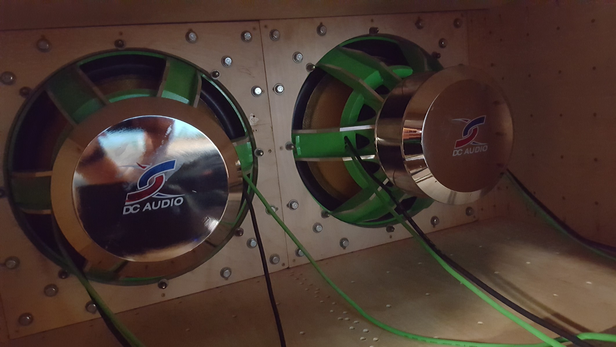

Also got my new anniversary decals for my subs but only had time to put one on the blank sub.  The other will get replaced when I have time (I wrecked it slightly while removing the sub last week).

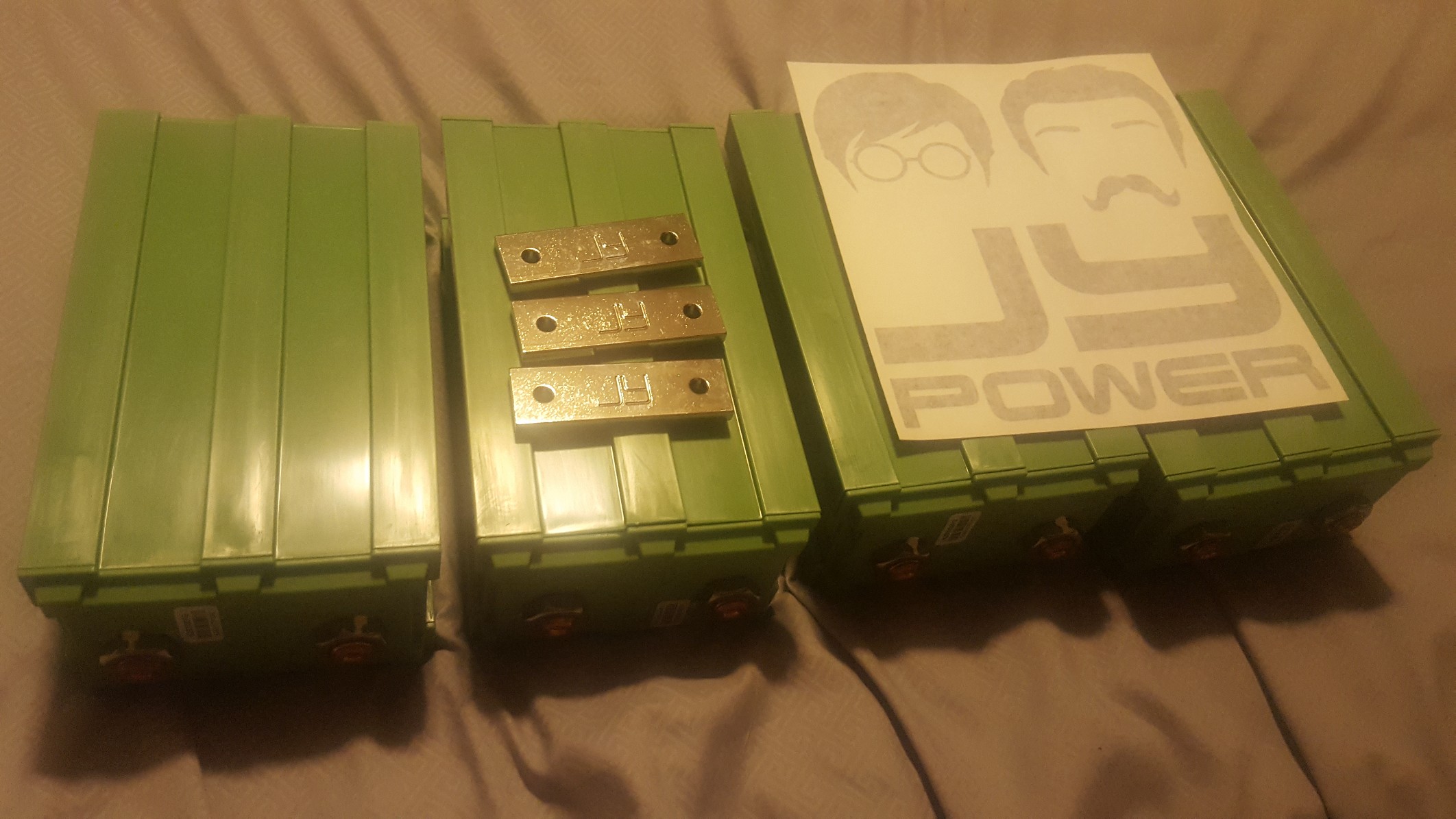

Got a delivery yesterday from JY Power!  My new 80ah lithium:
Forza approved...unfortunately he decided he liked it too much to let go and claimed it as his own so I wasn't able to install it yet lol:

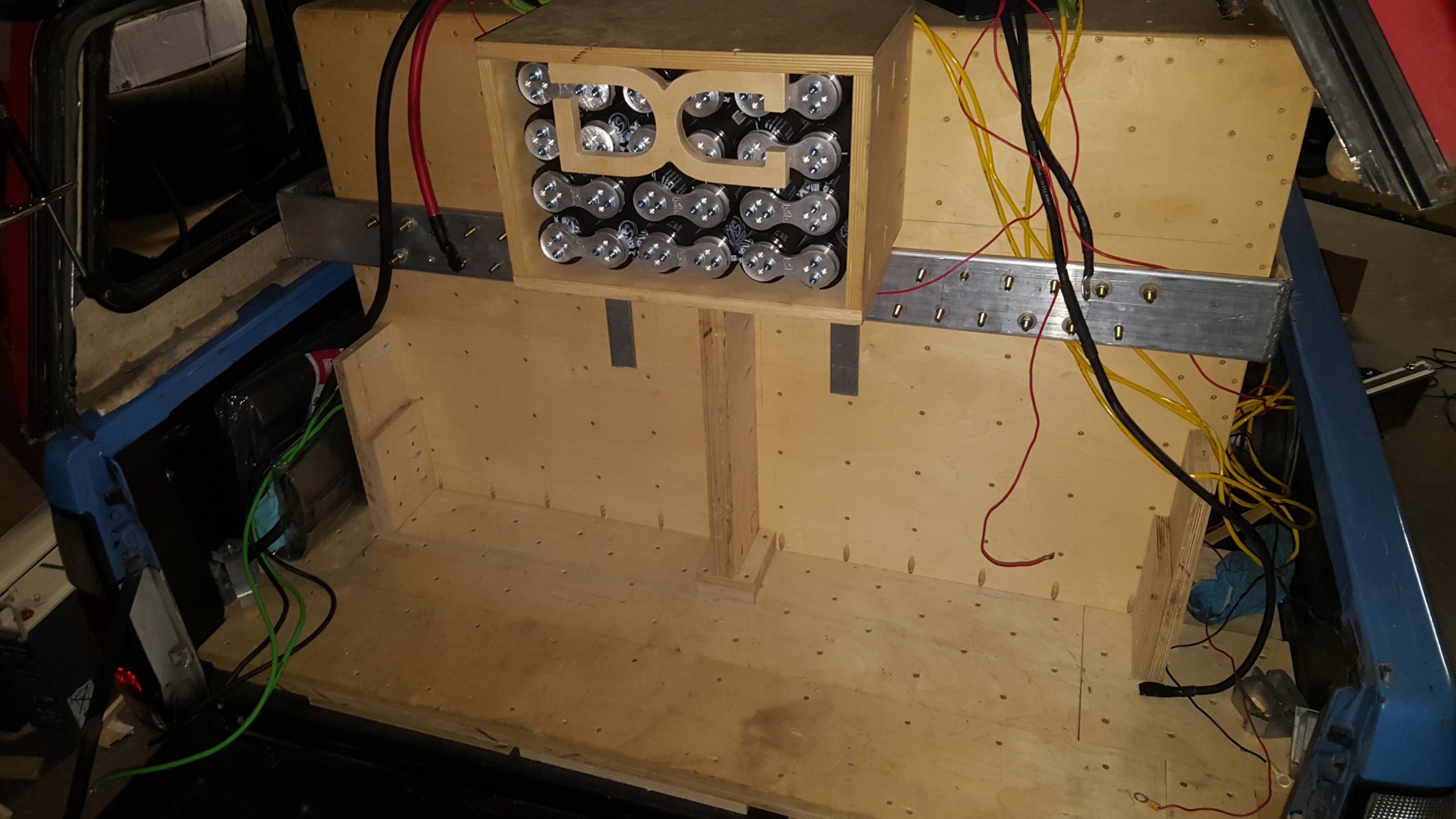

Might have gotten a little carried away tonight
Ready for lithium...definitely got room for the caps now! On a side note, check out the bad ass DC logo CNC'd by 920CNC!

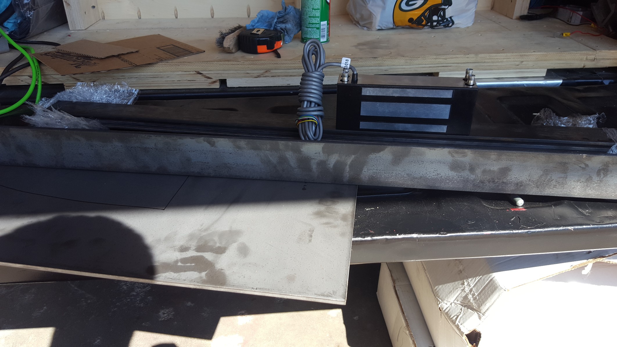

Might just have a little something in store thanks to a brilliant idea I got from John Nolte, since the door latch doesn't seem to be doing is job! Details will come as the installation progresses.

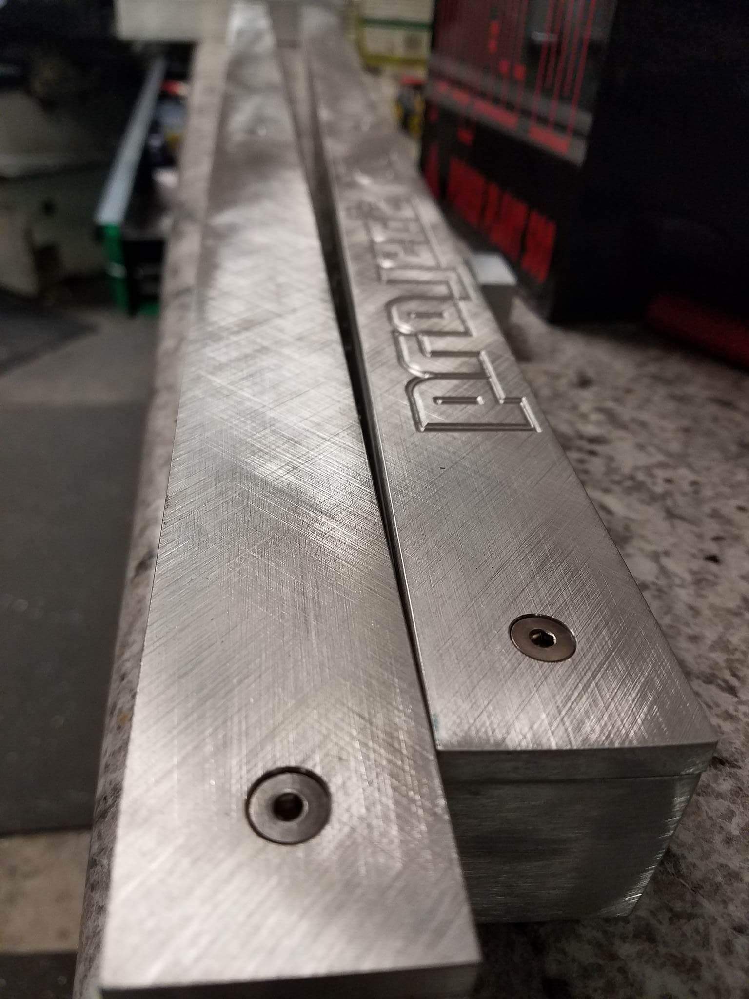

The buss bars are huge! Room for up to 19 banks of caps!
More to come tomorrow

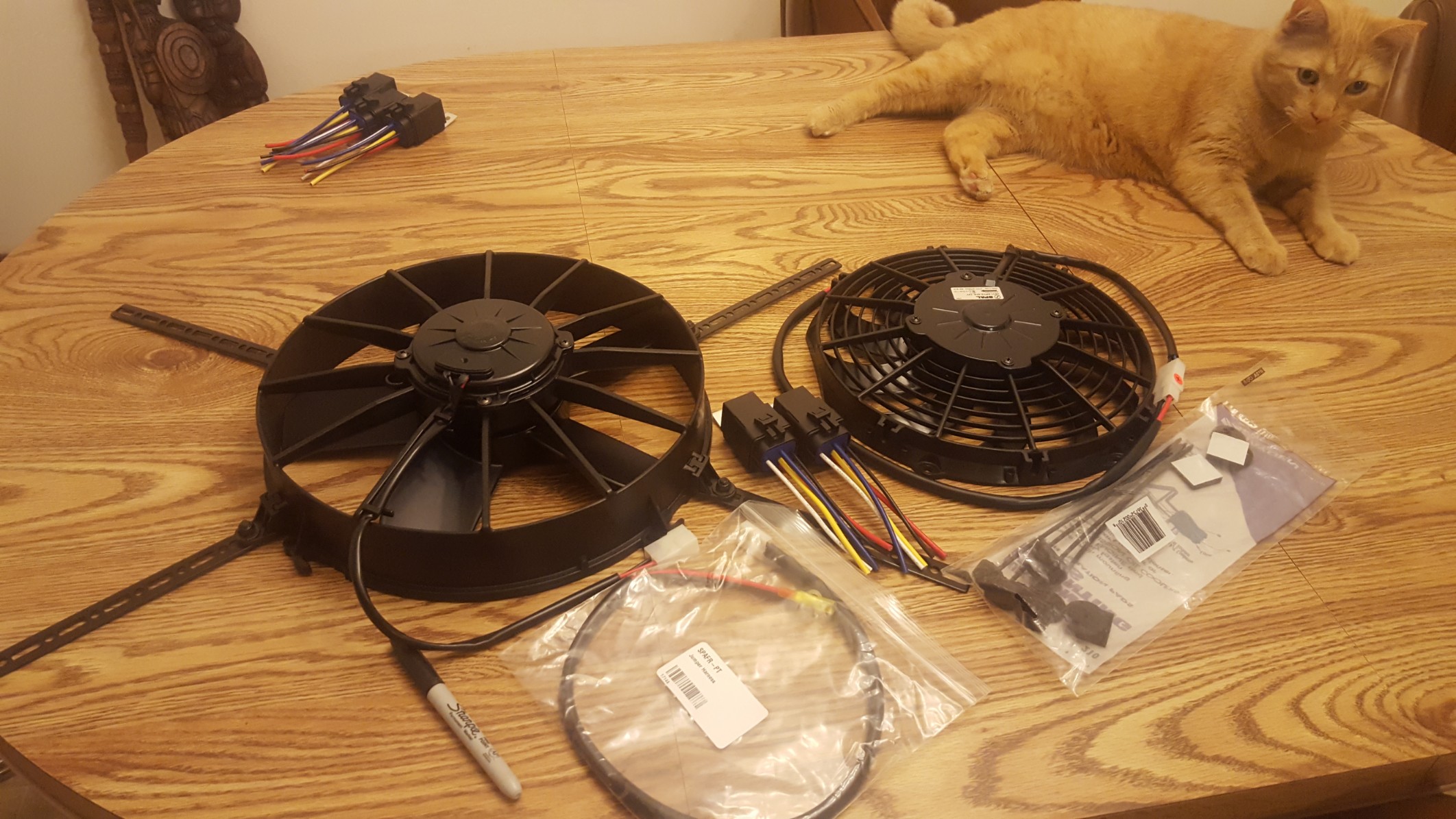

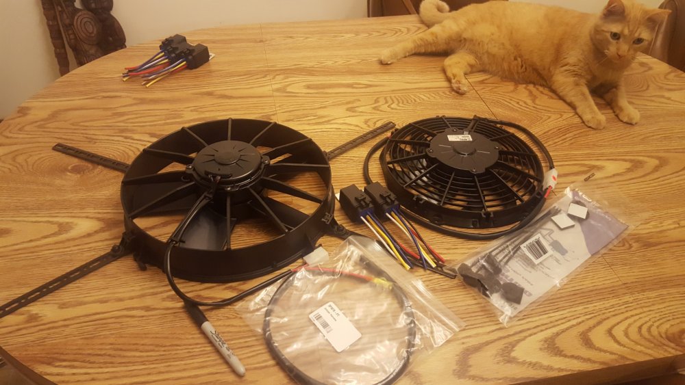

Got my new fans. Can't wait to get these bad boys hooked up...if these don't keep the sbc cool I'm going to give up hahaha.  Spal is the best of the best and the 12" fan is monsterous. Had to go with a low profile model for the 10".  C.f.m. ratings aren't awe inspiring unless you take into account that these are rated completely different than any other aftermarket electric fans.  1640cfm for the 12" and 900 for the 10".  To put it in perspective, almost all other fans are like boss audio amps and rated at an extremely over rated peak power vs an amp that is under rated at rms power lol.

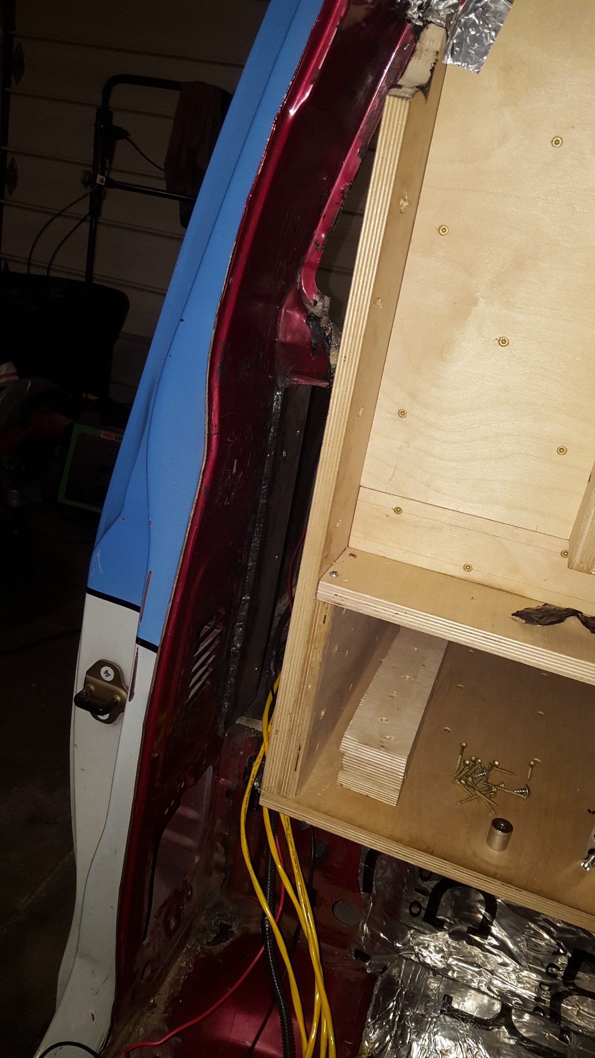

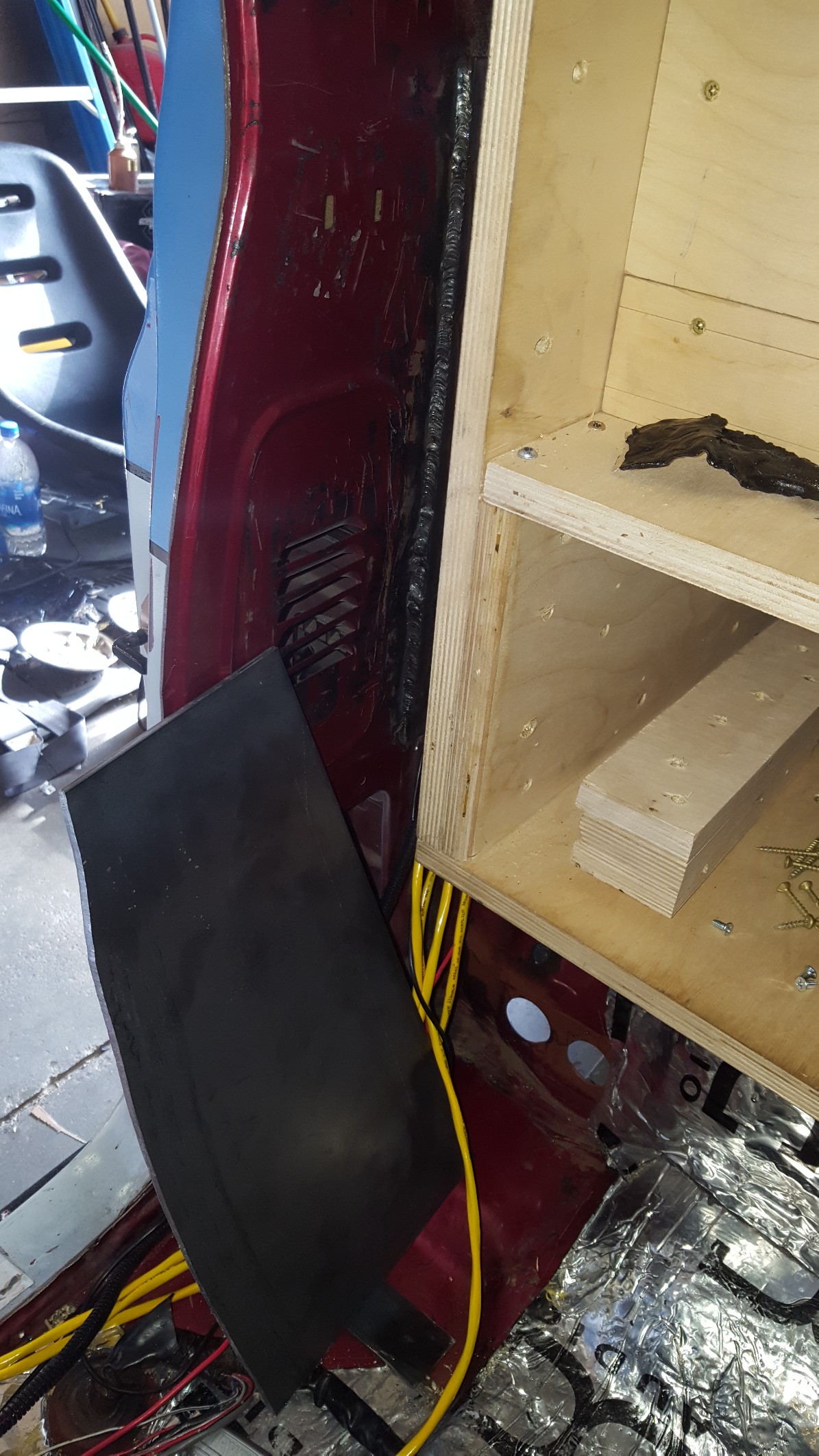

Not much else to post as I've been cutting gussets for the roof brace and stripper pole.  And I've been working on my new way of latching the door.  Been holding off because I got the idea of the product to use from John Nolte and was waiting for him to do it first, but he gave me the go ahead since he's not going to be doing it for a while.  Here's a little teaser. Anyone recognize what I've got in store? ?

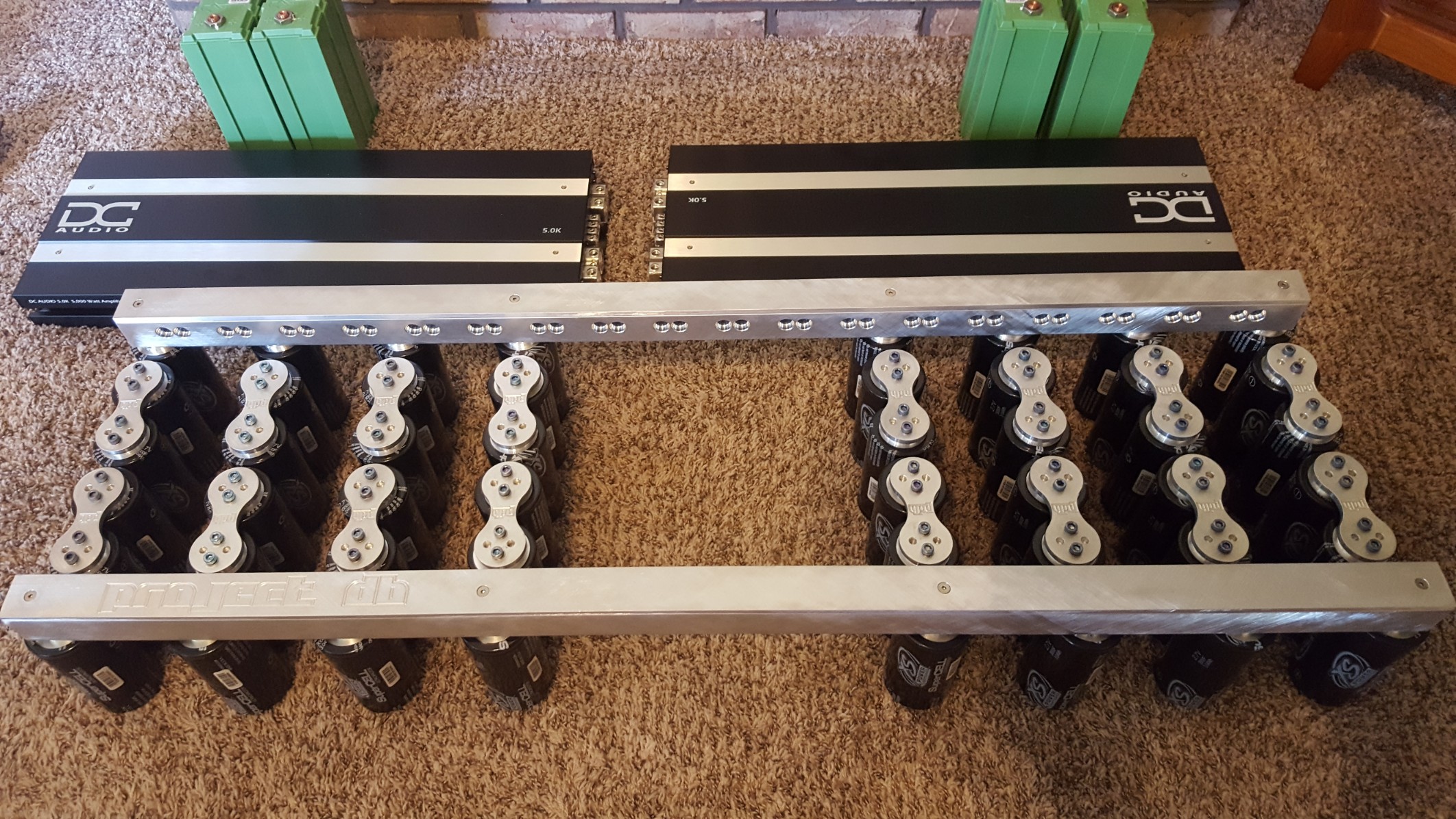

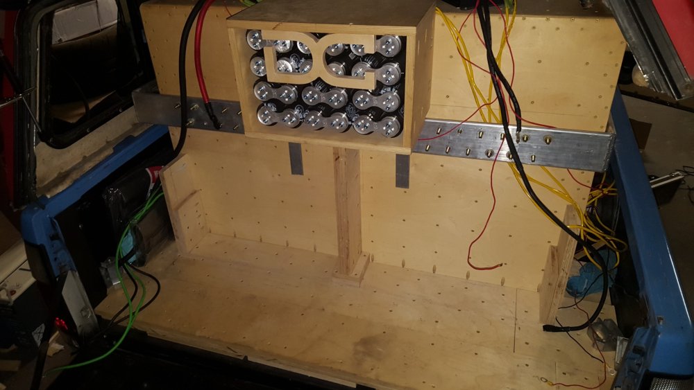

Started assembling my cap bank, not sure I'll have time to install it during this round of work but here she is in 2/3rds of her glory (4 banks are still in my truck)
I wonder how long until my OCD kicks in and I can't handle the 6 open spaces and buy 7 more banks lmao
