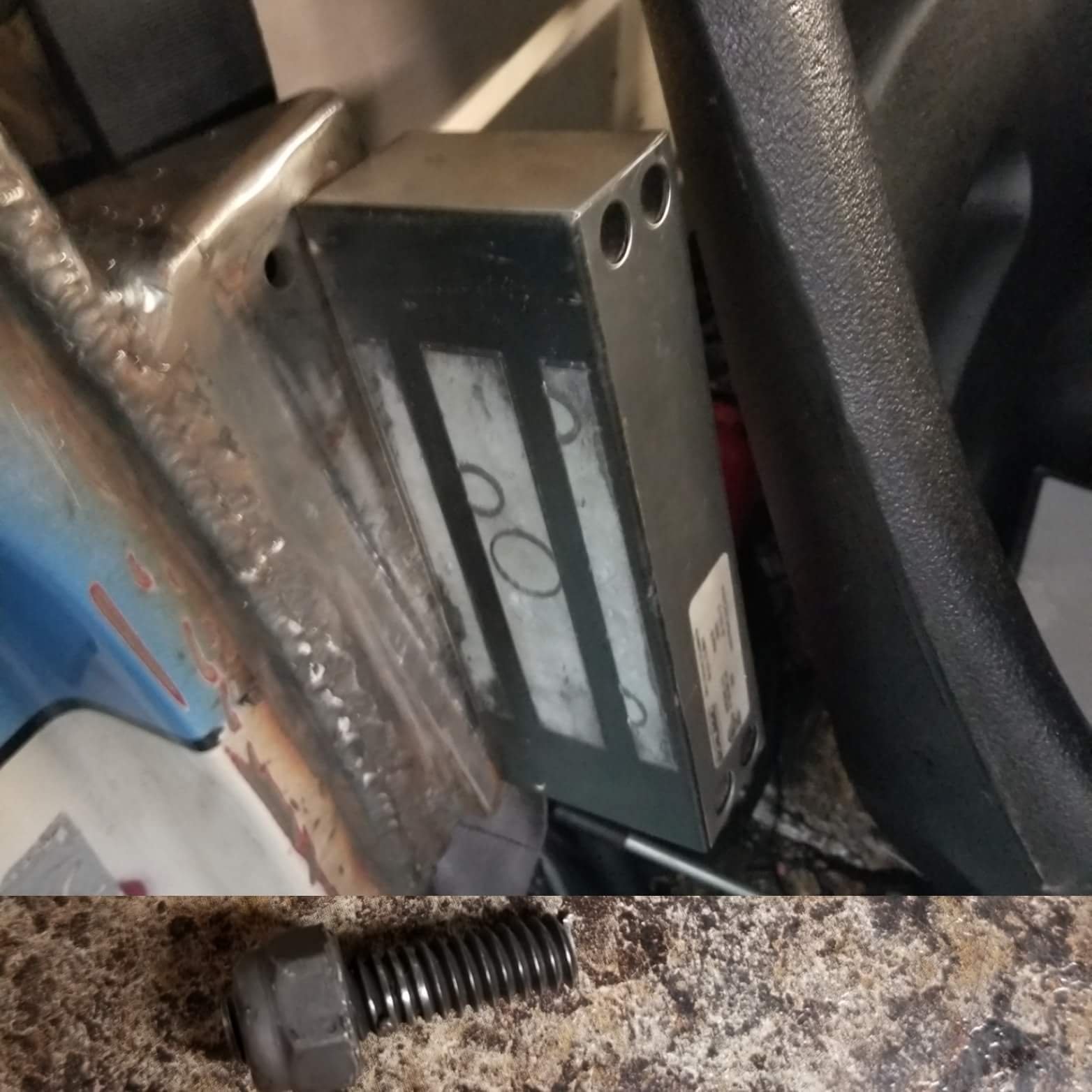

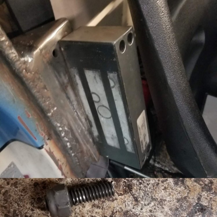

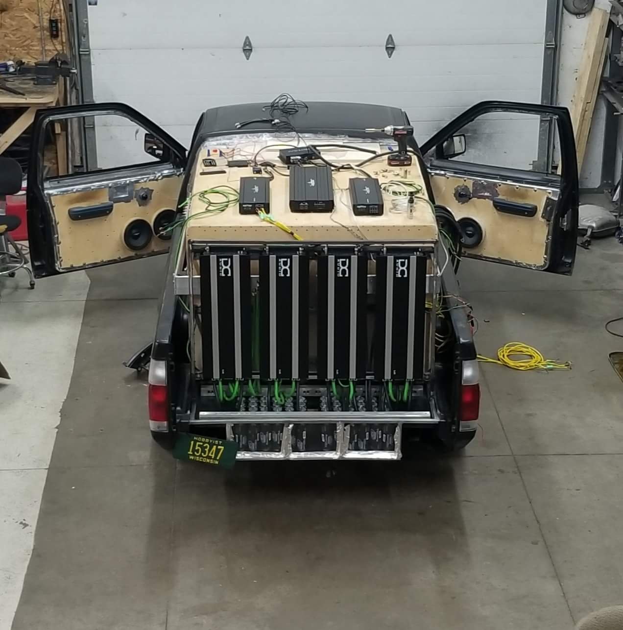

So the passenger door started flapping a little bit this year after the rebuild. Turns out the changes made quite a difference because I went to close the door the day after I dropped it off at my shop to get started on the current project, and it wouldn't close.  Upon further inspection I noticed that 3 of the 4 bolts had sheared off lol
Replaced everything with grade 8 hardware. Can't wait to see what a difference it made.

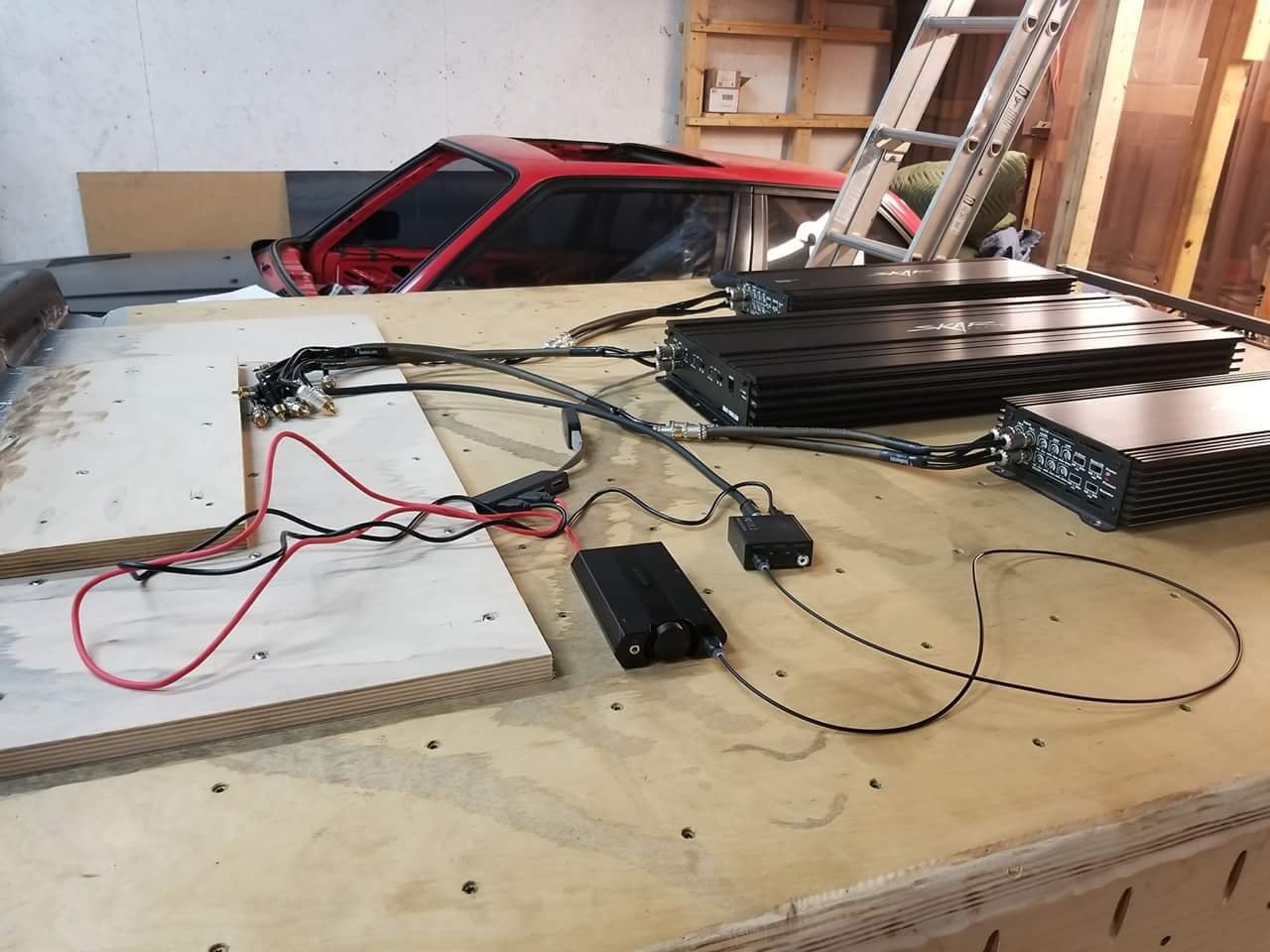

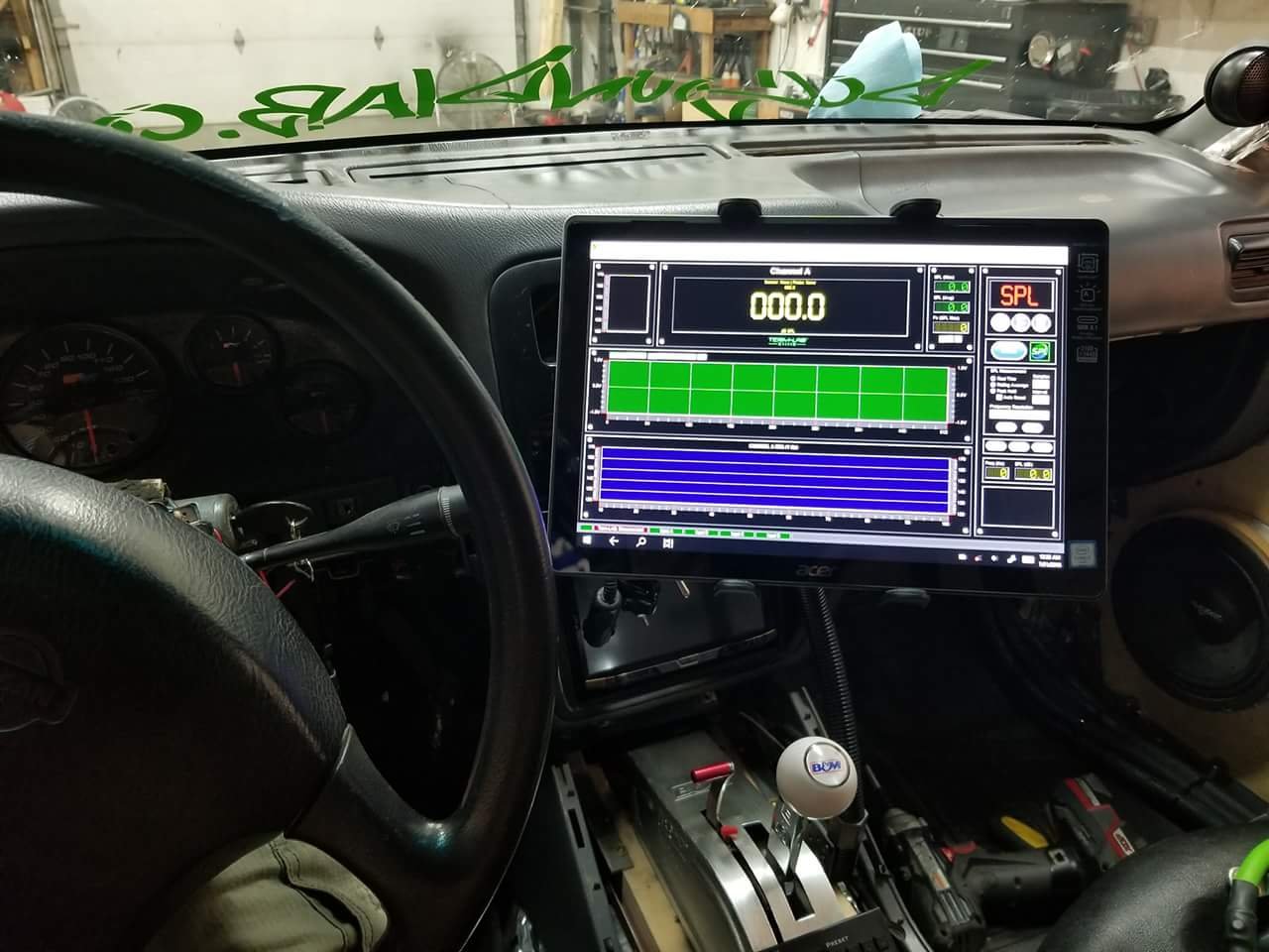

So here's what I'm currently working on.  I'm replacing the head unit with a windows 10 tablet and high end external sound card.  I'll go into more detail about the hardware when I have more time.

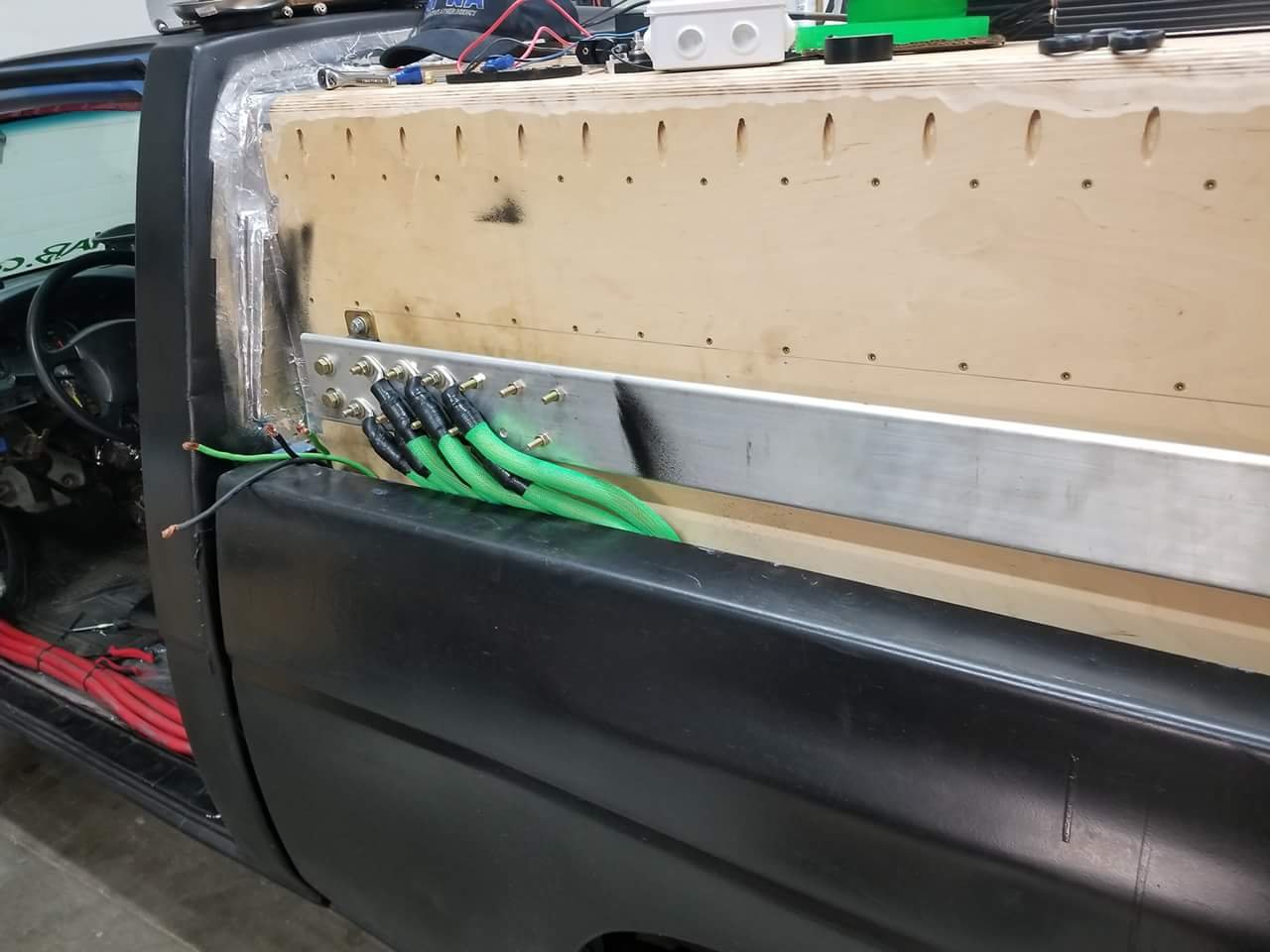

Im also upgrading the power for the mids and highs and doing a bit of wiring clean up
FB_IMG_1532624039847.thumb.jpg.e1fca99e9399bdf9406fa2aee814bd87.jpgFB_IMG_1532624066687.thumb.jpg.374c4cbf4dd8eaaae01d80a49fb7e1ac.jpg
More to come
