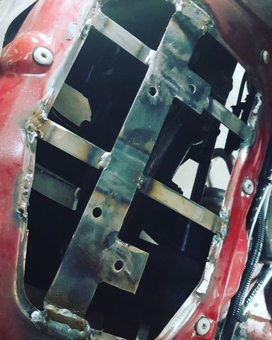

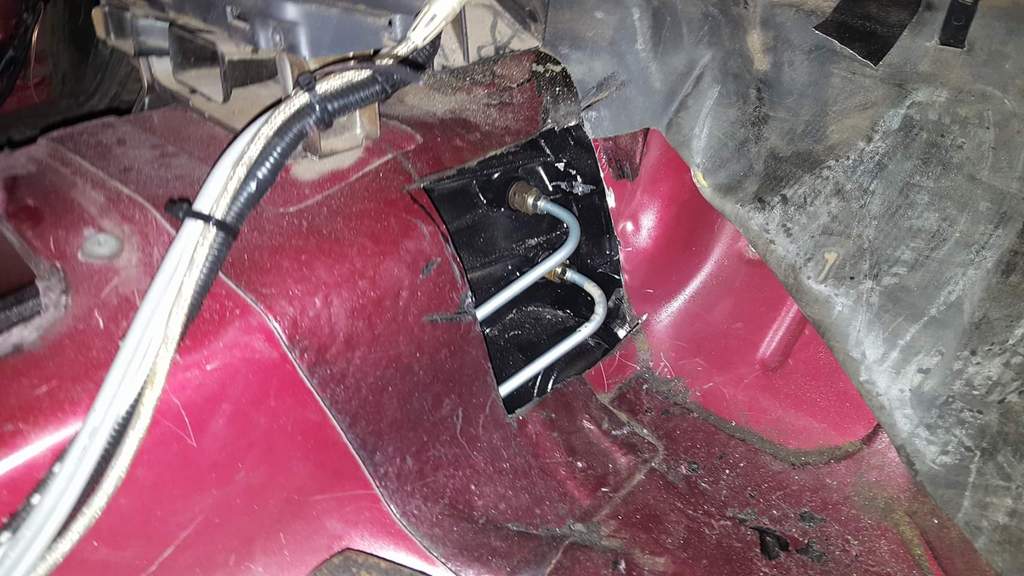

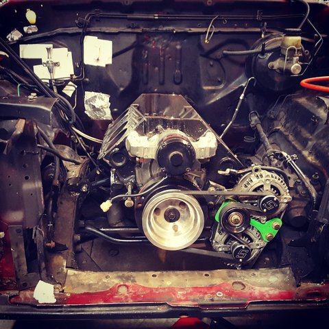

Had to cut an access panel for the transmission cooler lines so they would clear:

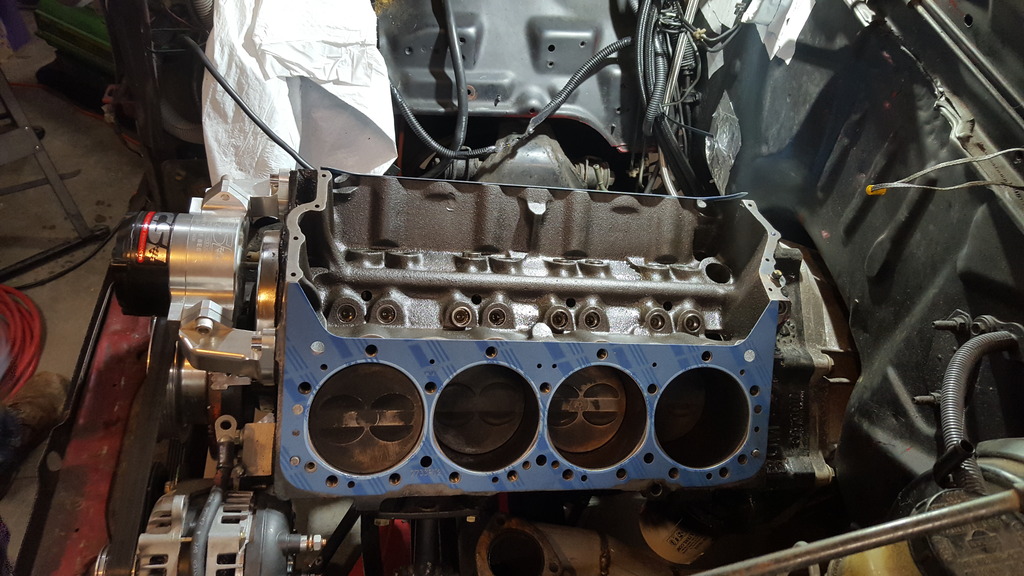

Pulled the intake manifold:

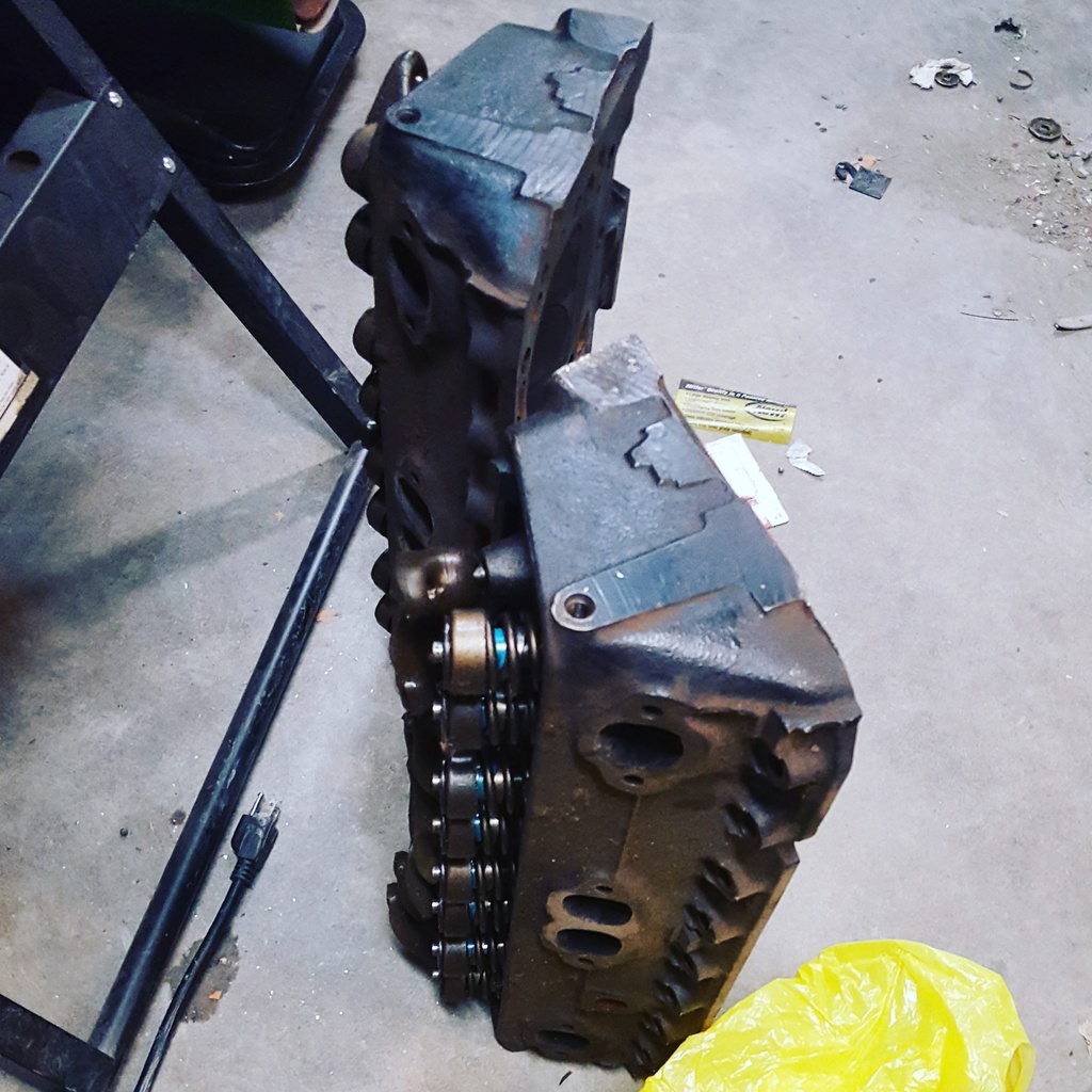

Unfortunately we found that the valve seals were shot, so off came the heads:
Luckilly i had a set of heads laying around from my old roadmaster that i never ended up putting on.

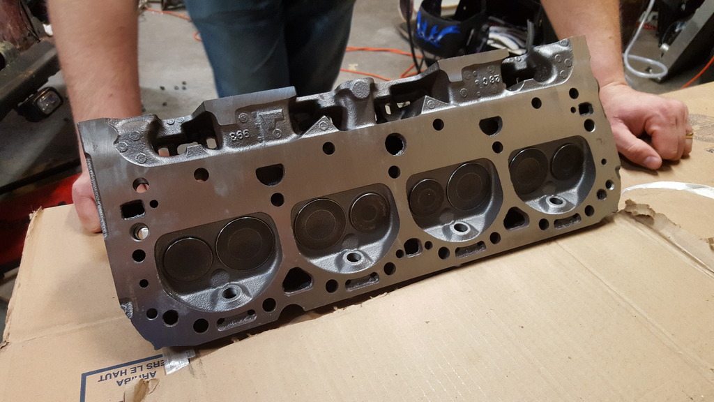

Theyre mildly ported 993 heads with 500 lift springs. Had them resurfaced at the machine shop and had the valve seals replaced too:
Made myself a mount for my new shifter:
And thats where its at presently.  Im going to probably pull the passenger door off soon and start reinforcing it. Planning on tearing into the wall after the engine work is done and getting it ready for the DC Neos!

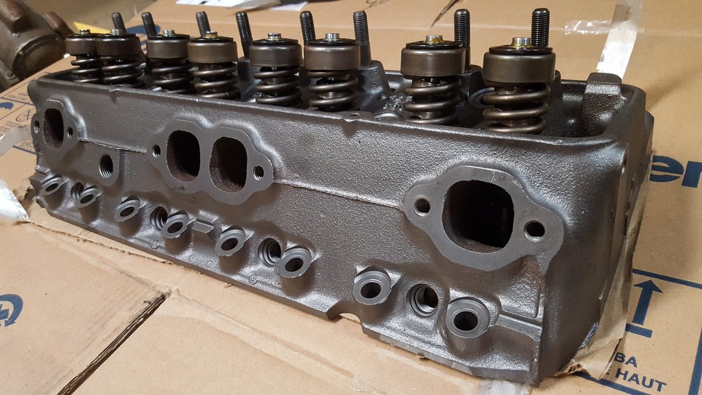

Got my ported #993 heads back from the machine shop! Completely gone through, decked, new valve guides / seals. Lookin fresh!

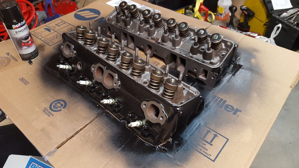

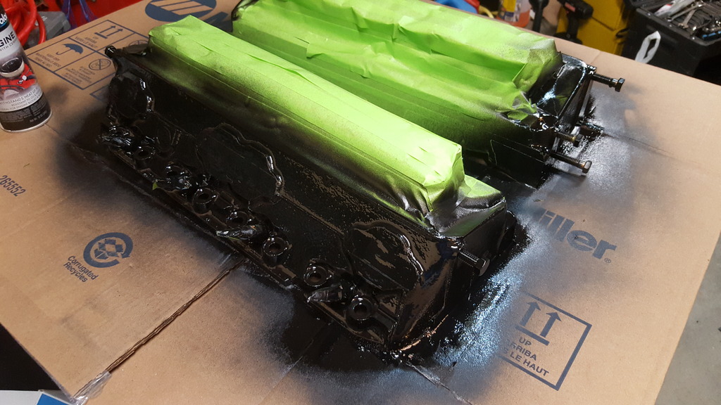

Masked them off and shot a few coats of engine paint on:

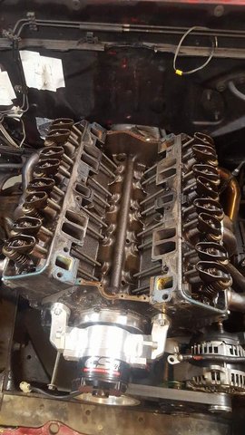

Got the engine prepped, head surfaces cleaned off, bought a new tap and die set and cleaned all of the threads too:
Going to start reassembly tomorrow morning. Should be mostly back together by the end of the day.  Hopefully will have the engine and trans work completed by the end of the week which means that I can start ripping the wall out and start rebuilding it for the 18s!  This thing should haul some ass even with all of the weight of the system!
