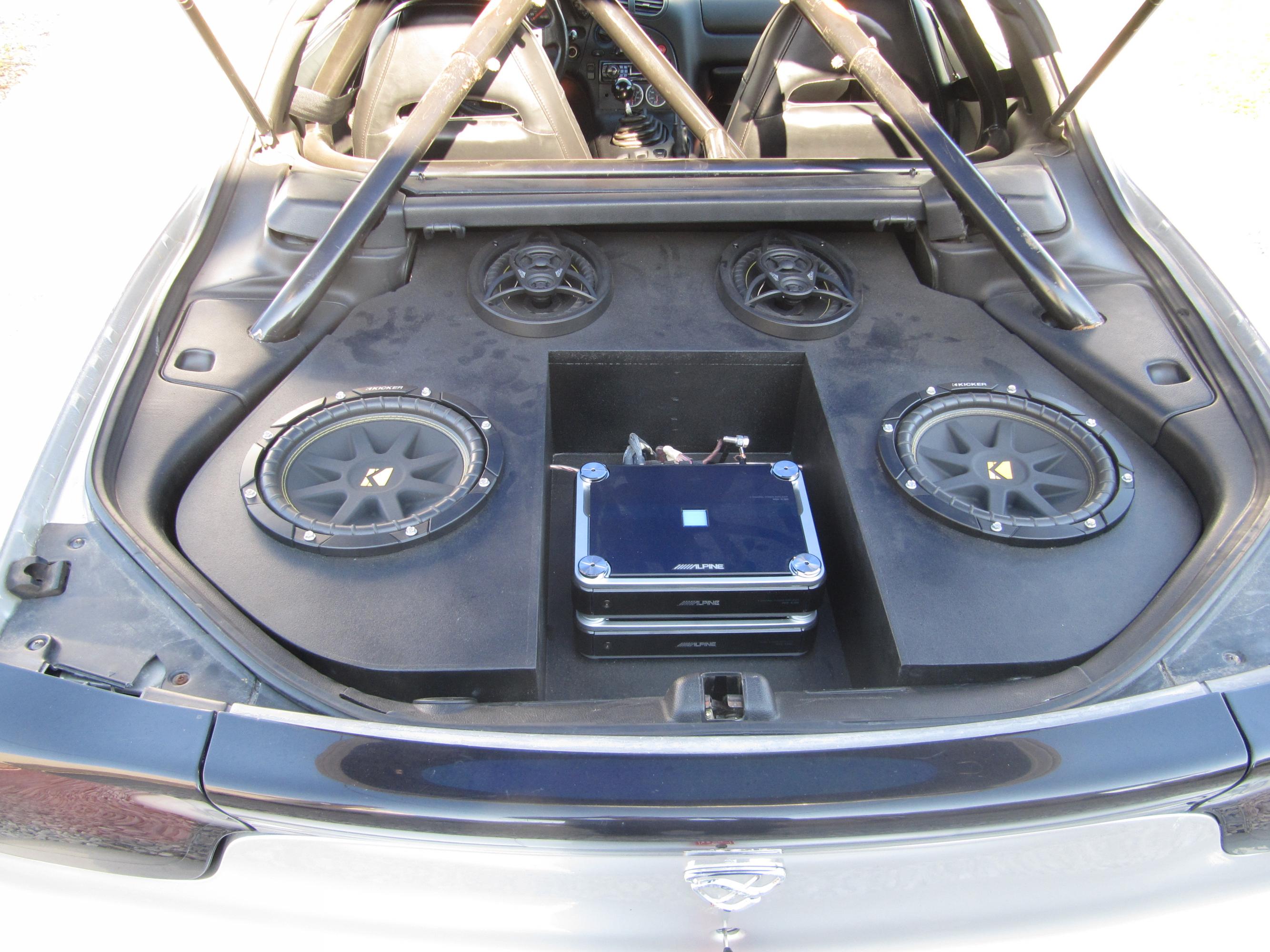

john253a Posted July 9, 2013 Report Posted July 9, 2013 Post some measurement As depth may come into play here Your l710 should do well in that space if its net , gross on the other hand no if it ported Also post the box you have now and the measurement + that amp and wiring config plus coil config Thoes 2 10" sealed on 2k should still get loud Edit 3-4x sa8 or slimar will get loud in that space I. The right power(2.5-4k)

john253a Posted July 10, 2013 Report Posted July 10, 2013 2.2-2.5 gross is need for 2 sa8 with slot port in 0.7net each So you could do 3 easily or depending on design 4x 8" ported Another option sealed in big power In 3cuft gross (box design pending in measurements)upto 10x sd2 8" on upto 6000rms
PaulPumpsBass Posted July 10, 2013 Author Report Posted July 10, 2013 Here's a picture of the old setup that was in there when I bought it. You can see it's not square dimensions. It's 24" Wide in the front, 38" Wide in near the rear (widest part), 30" in Length from front to back, and 11" Deep. 1994 Mazda RX7 with LS1 Swap and 2 - 10" Kicker L7's in Truck Boxes (because of extremely limited hatch space) 2003 GMC Yukon XL with 3 - 12" MTX 9500's and still has the third row seat (over 7.5 cu ft of enclosures behind third row) 1971 Chevrolet Nova with LS1 Swap (work in progress, most likely 4 - 12" Alpine Type R's as I already have them) 1961 Chevrolet Corvette Restomod with LS7 Swap (system upgrade will be one of the first things that I'll do) Solo Basshead For The Most Part, None Of My Close Friends Have A Passion For It, Nor The Money For It. If I'm Home And Free... Always Looking To Meet Up With A Fellow Enthusiast To Talk Shop Or Do Demos! Hard To Find Fellow Bassheads (Not Crack or Heroin Addicts, I Can Find Them Everywhere) In Baltimore / Mid-Atlantic / DMV areas.
