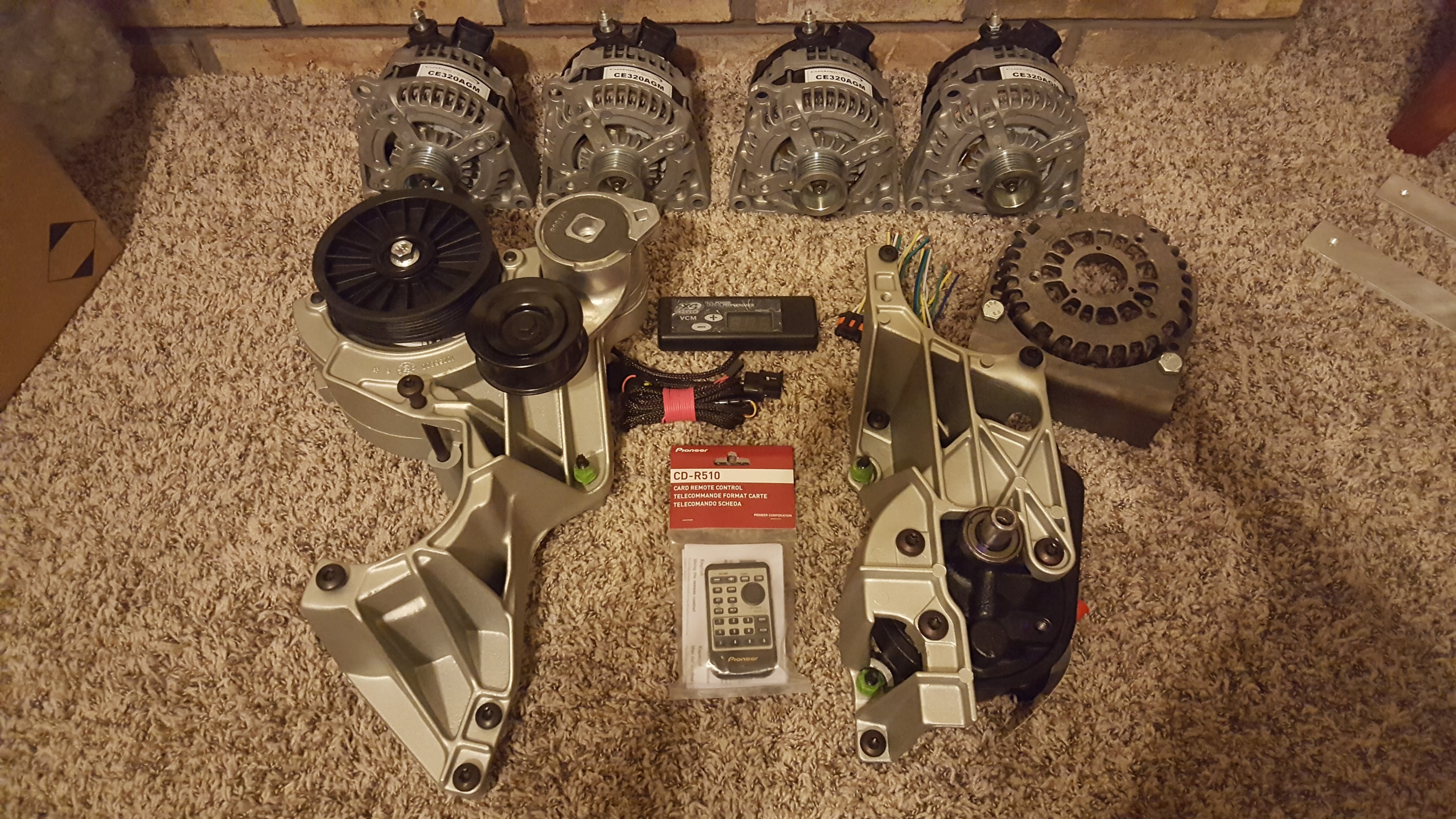

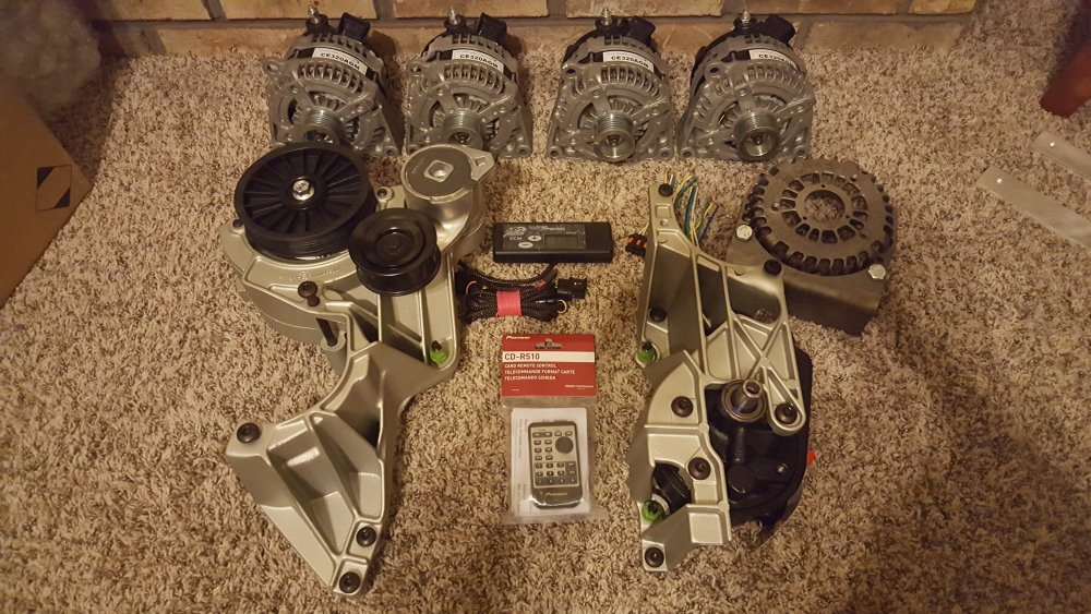

Some more parts showed up for my charging system upgrade, going to attempt to get power steering worked in if I can! I'm really excited to tear into this pproject this winter!
New serpentine conversion brackets, ps pump, mechman alternator bracket and xs power vcm
Oh and the remote I ordered showed up, thought it had a volume knob but turns out it's just a d pad :(

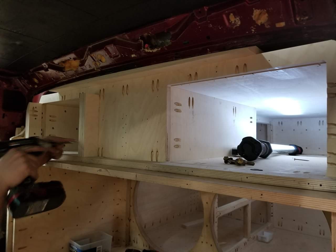

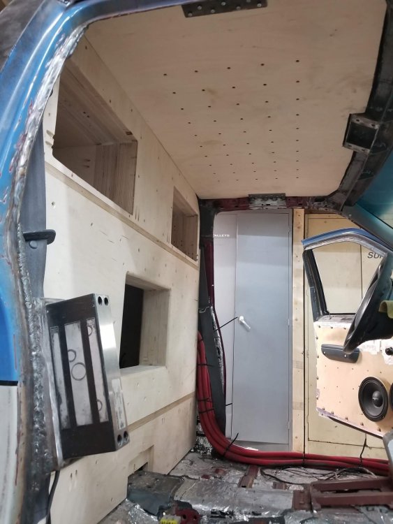

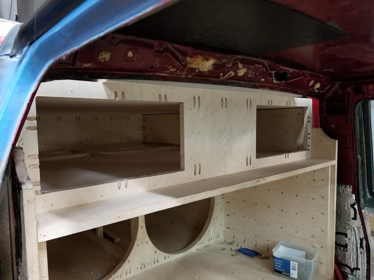

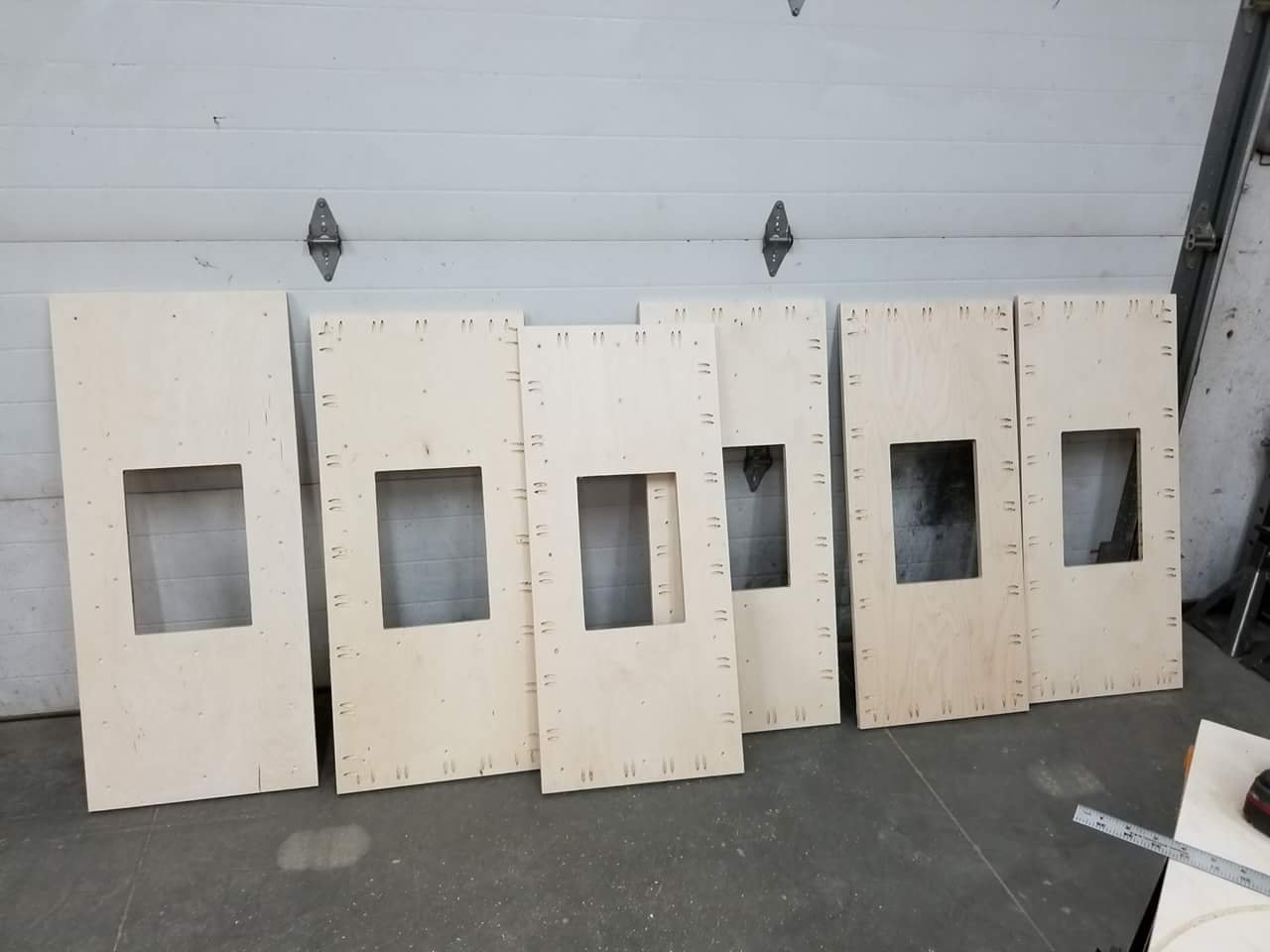

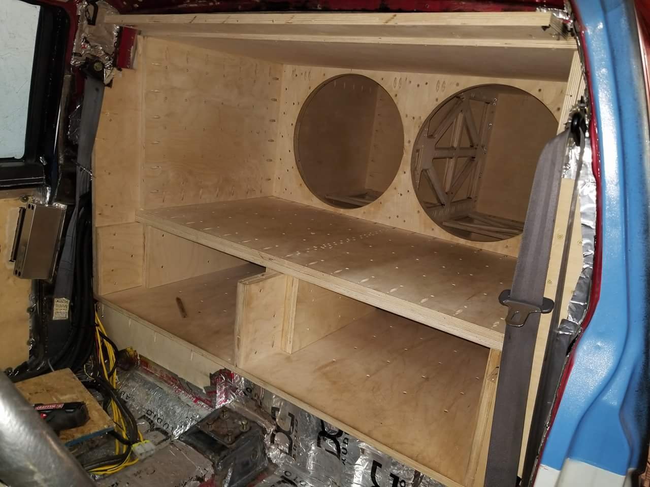

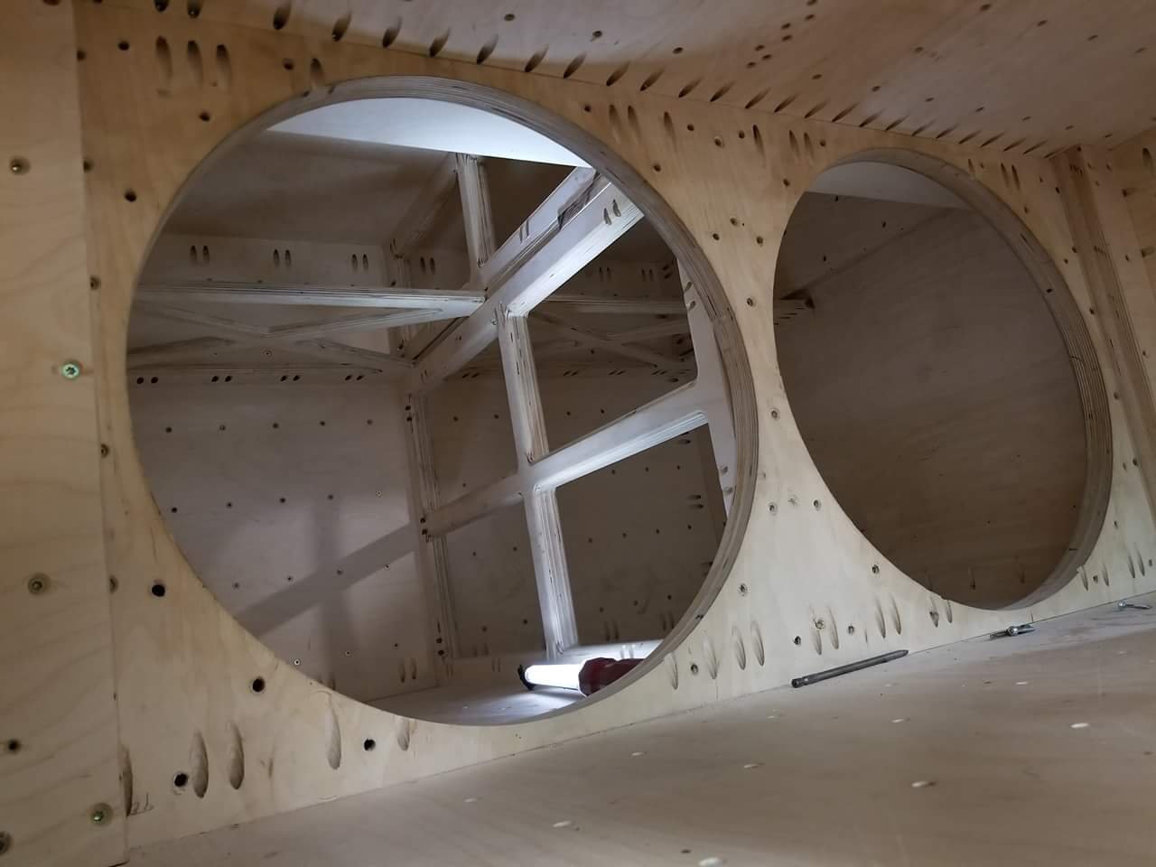

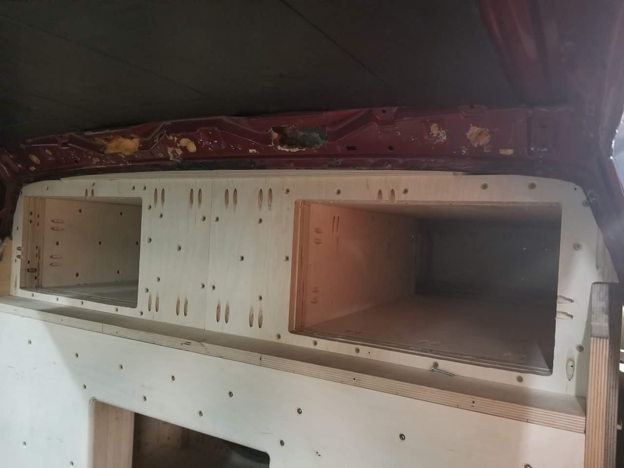

Anyway, this springs work consisted of a redesign of the 6th order.
Basically flipped the internals, shrunk front chamber and ports and did some new bracing
Also added quite a bit more screws lol

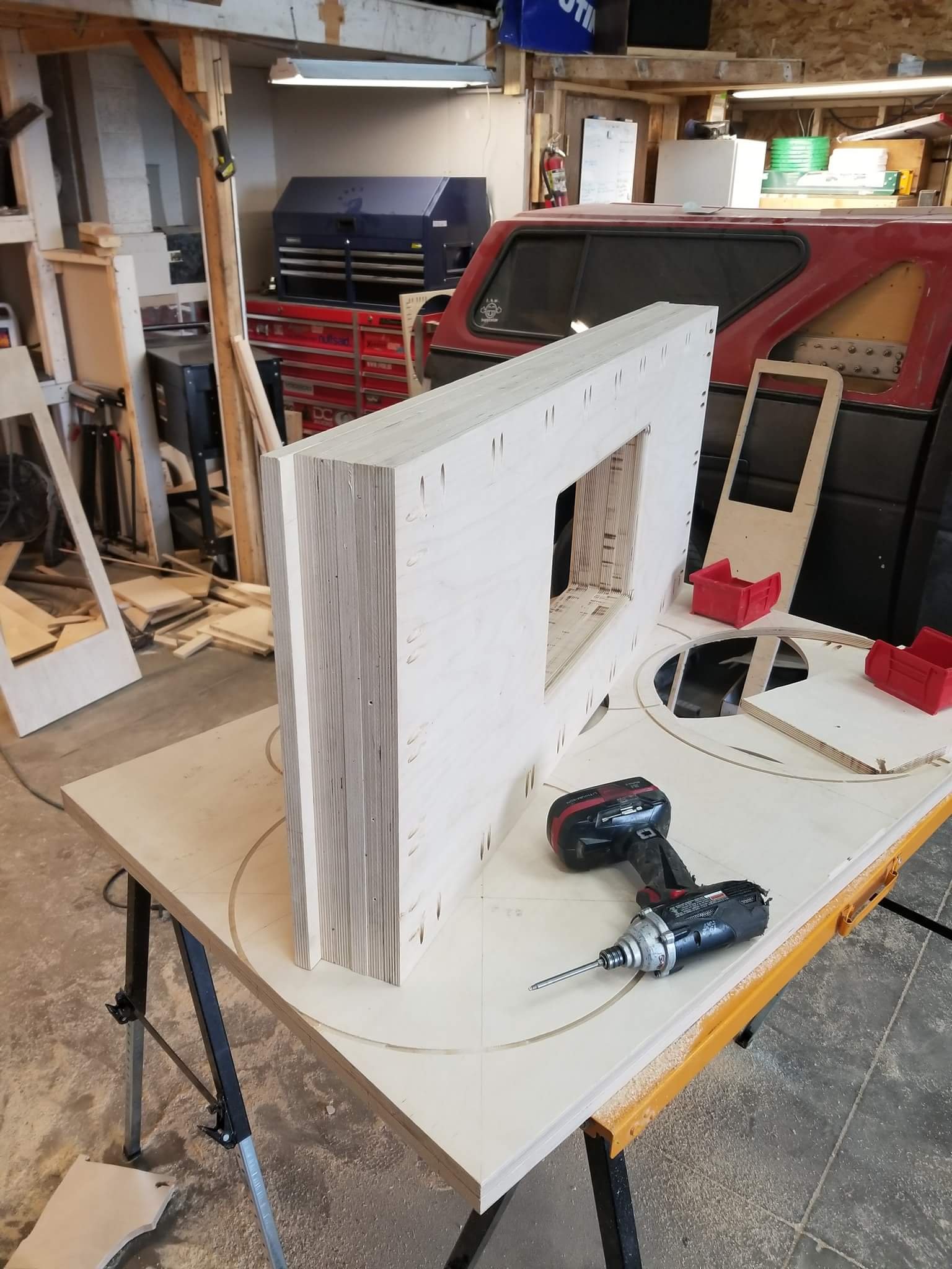

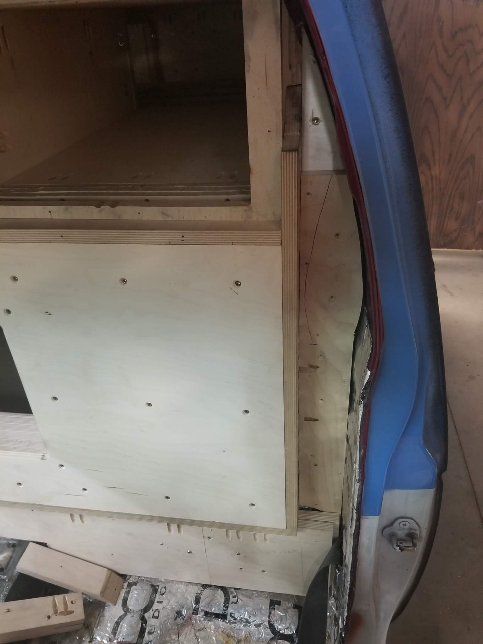

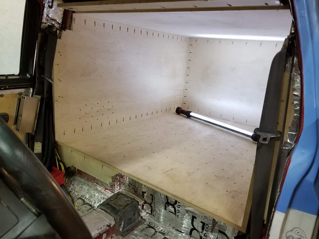

New front chamber loading wall

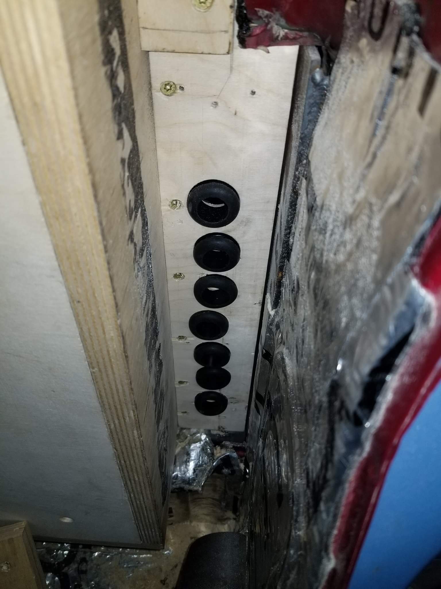

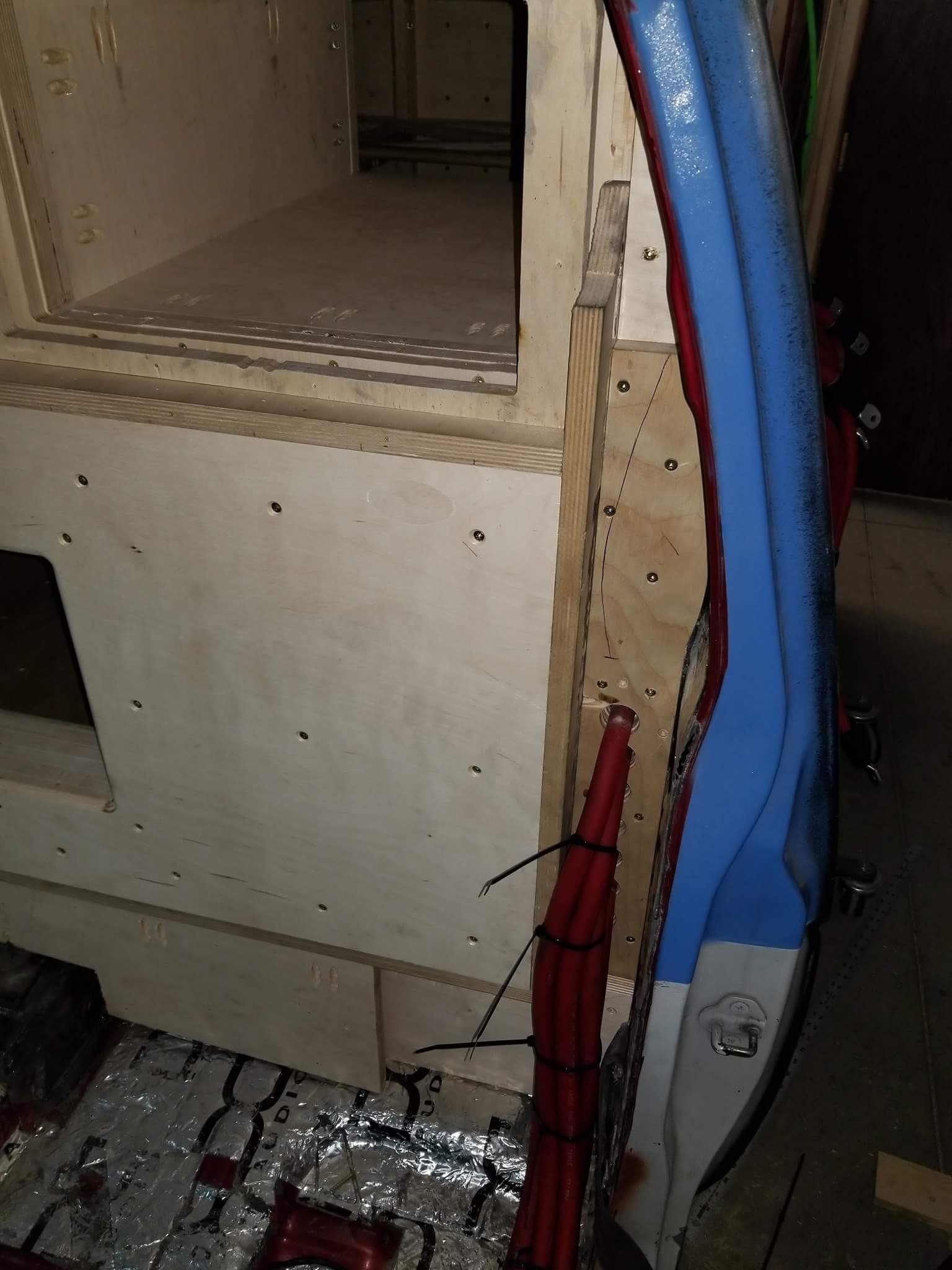

Sealed off the cabin much better:

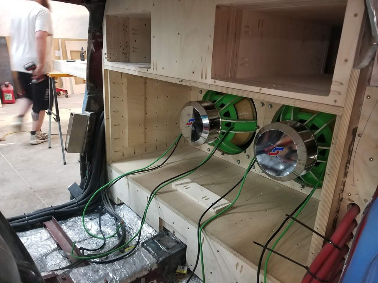

Subs loaded
More to come!

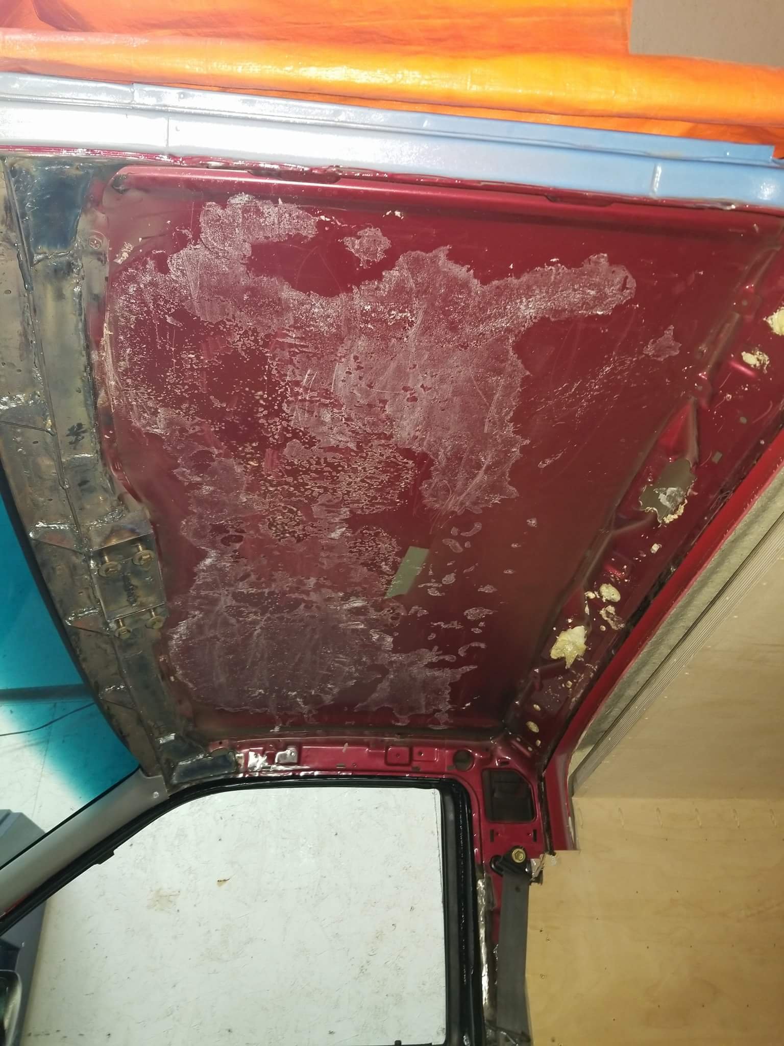

Finally ripped out the last piece of the previous owners buildFB_IMG_1532437719947.thumb.jpg.bbe169c448680ac6c3bd68a68eb2f682.jpg

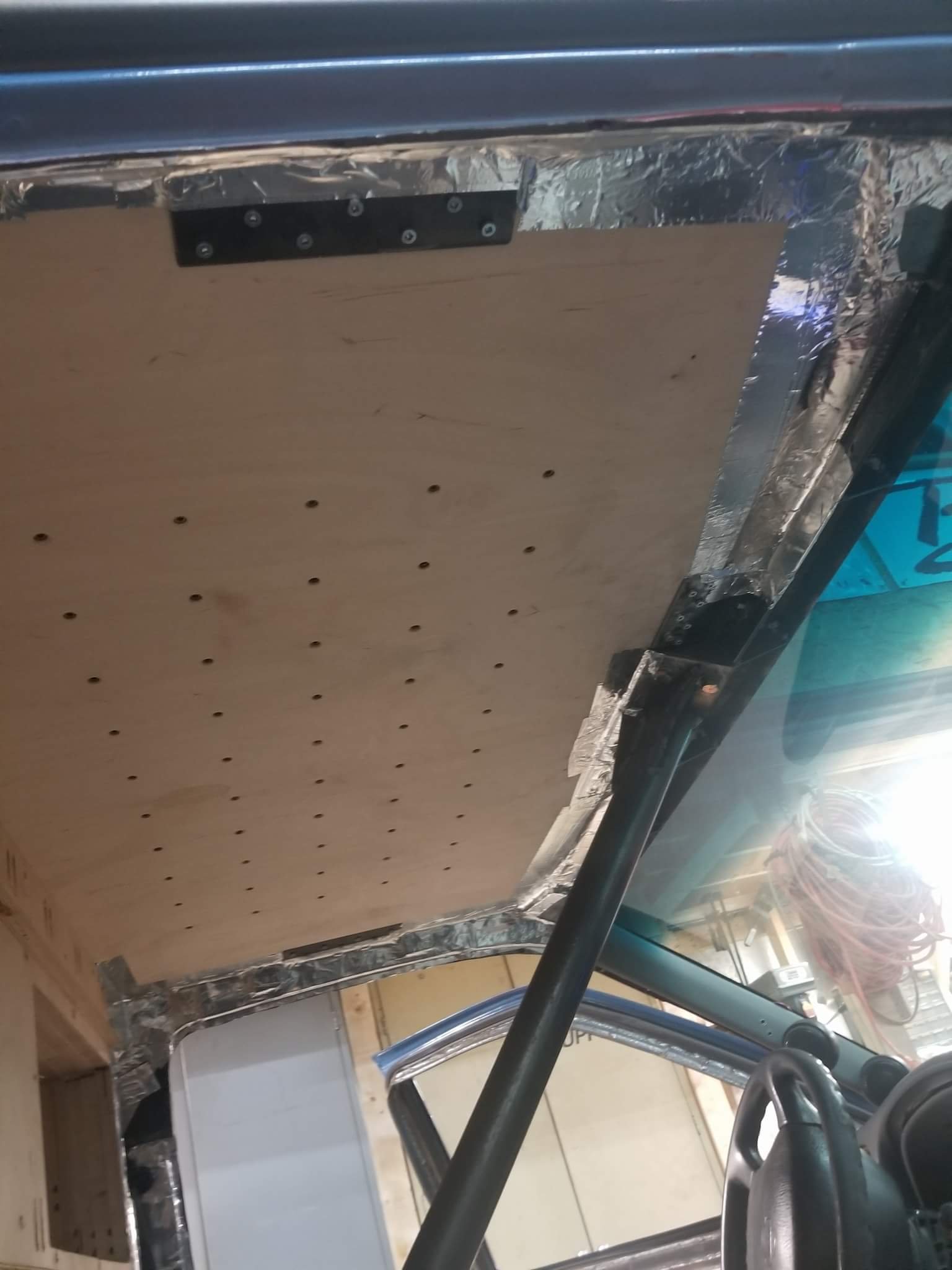

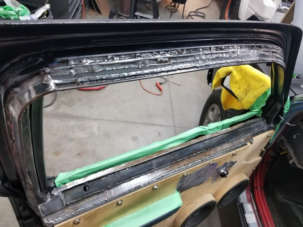

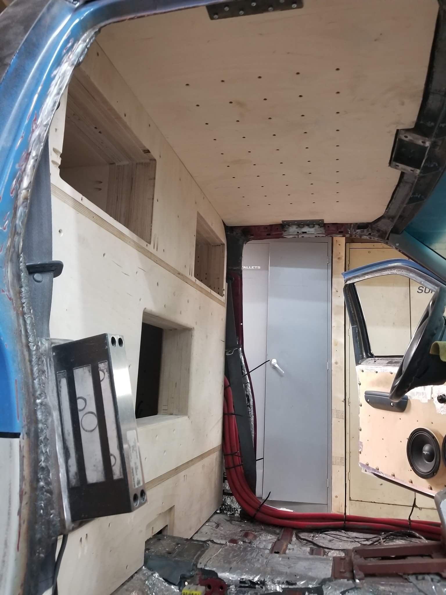

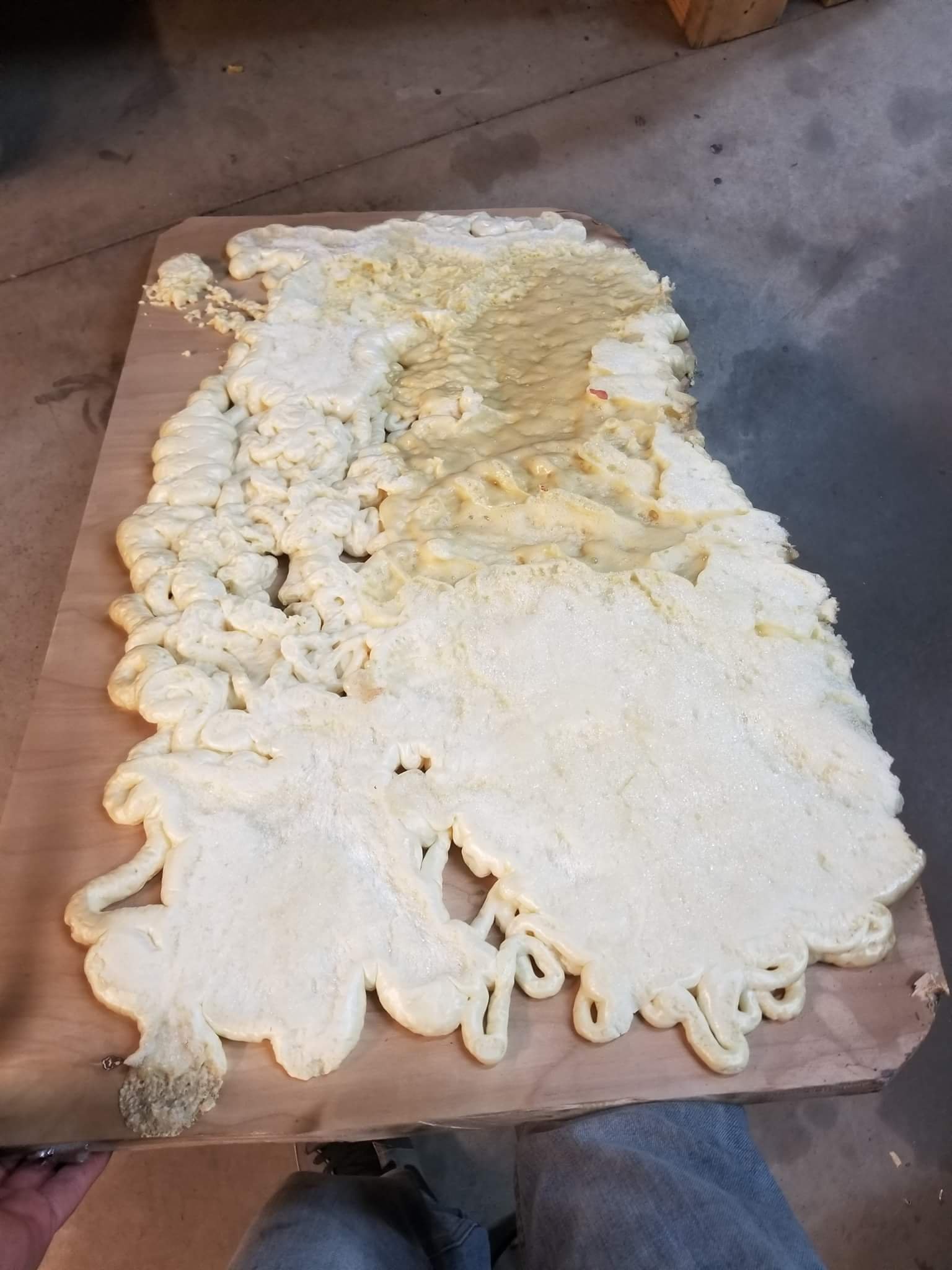

Prepped the roof, 2 layers of vibraflex, a third layer in the middle, 2 big tubes of PL on the top layer (about the size of where the grid of screws is) and a second layer of birch. The second layer isnt PL'd yet because I have some welding plans for the roof yet.
Everything is together

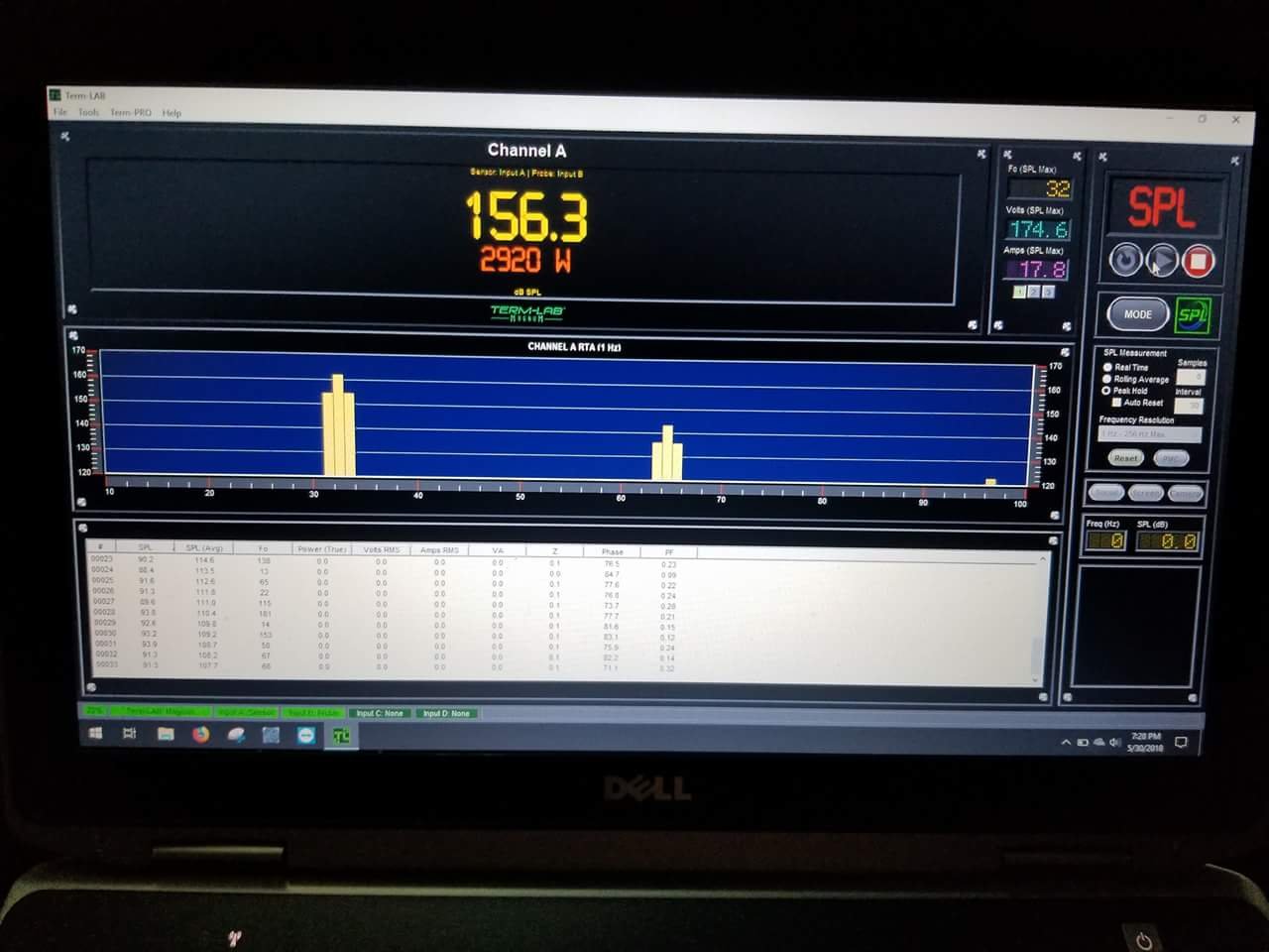

Did a 32hz burp sealed at the dash, truck off on only caps
It should be even louder now but no time to retest yet

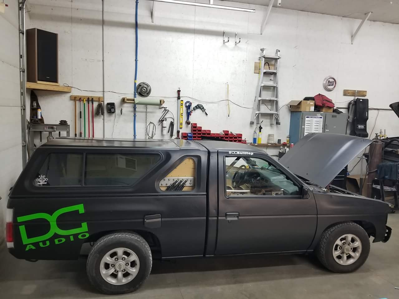

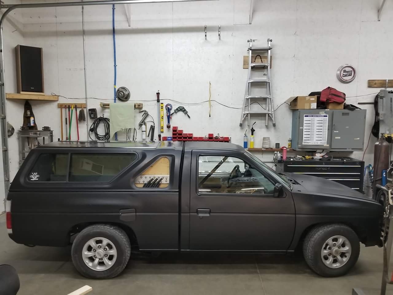

More to come!
Blacked out truck looks great man.
IG @walledsonic
Thanks guys!
I kind of like the raw look of my doors so instead of letting them rust I used clear plastidip

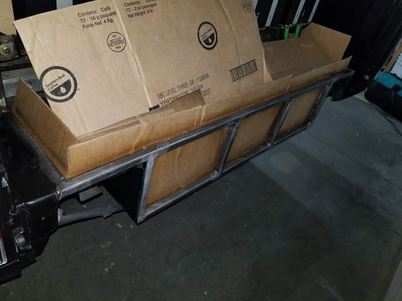

Also did it on the cap bank frame

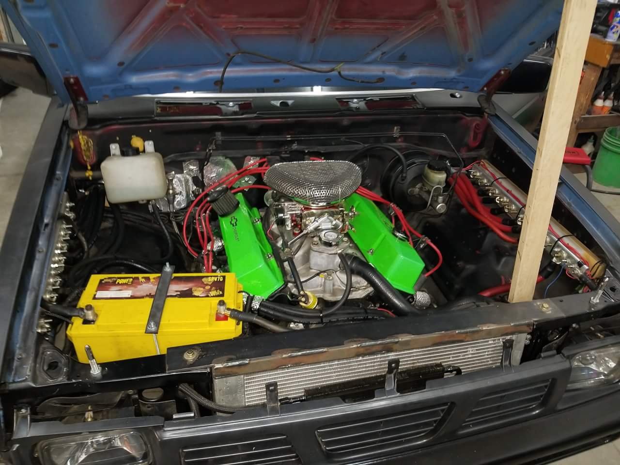

Added a temporary AGM under the hood. I sold my JY this winter because I never drop voltage low enough use it and there's a slow drain in the truck I haven't had a chance to fix yet. So it was very stressful having such an expensive starting battery that needed to be on a charger 24/7 if the truck was sitting, because without a charger, it would drain in like a week of sitting and could destroy the battery.

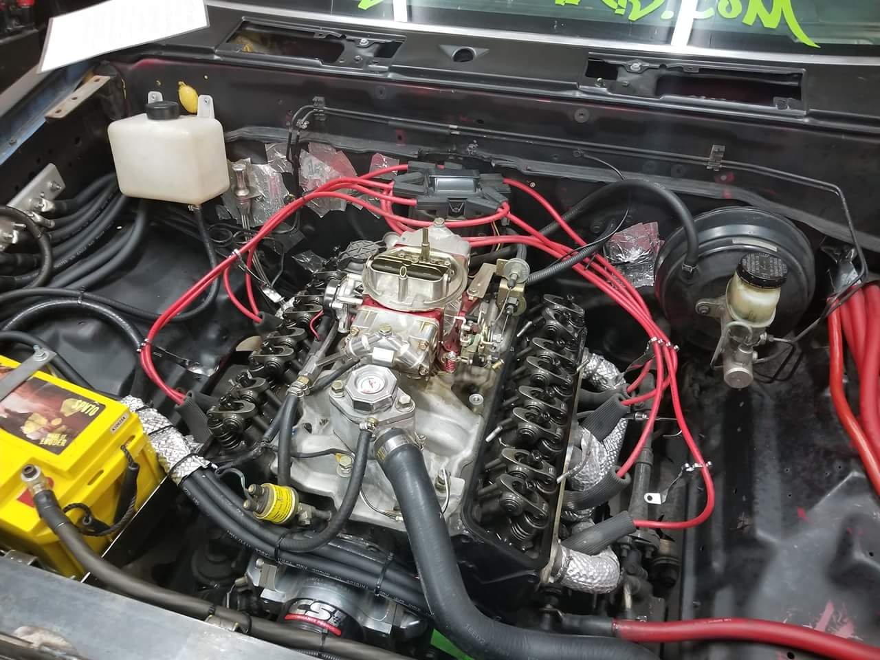

Went through and did a valve adjustment and carb tune up. Runs great again
