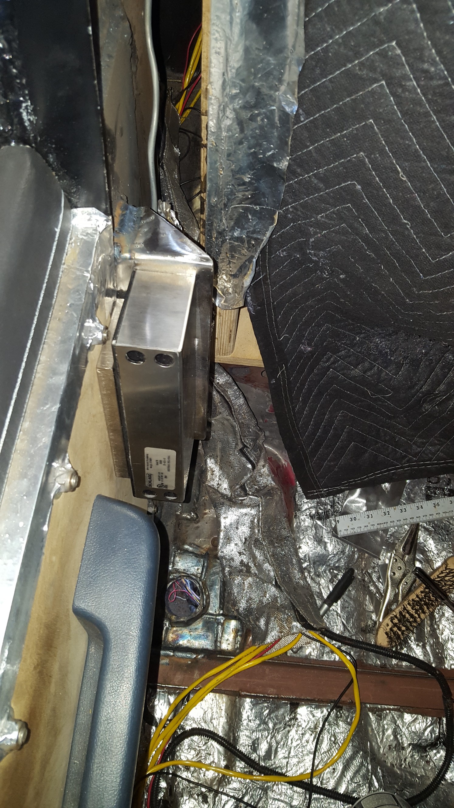

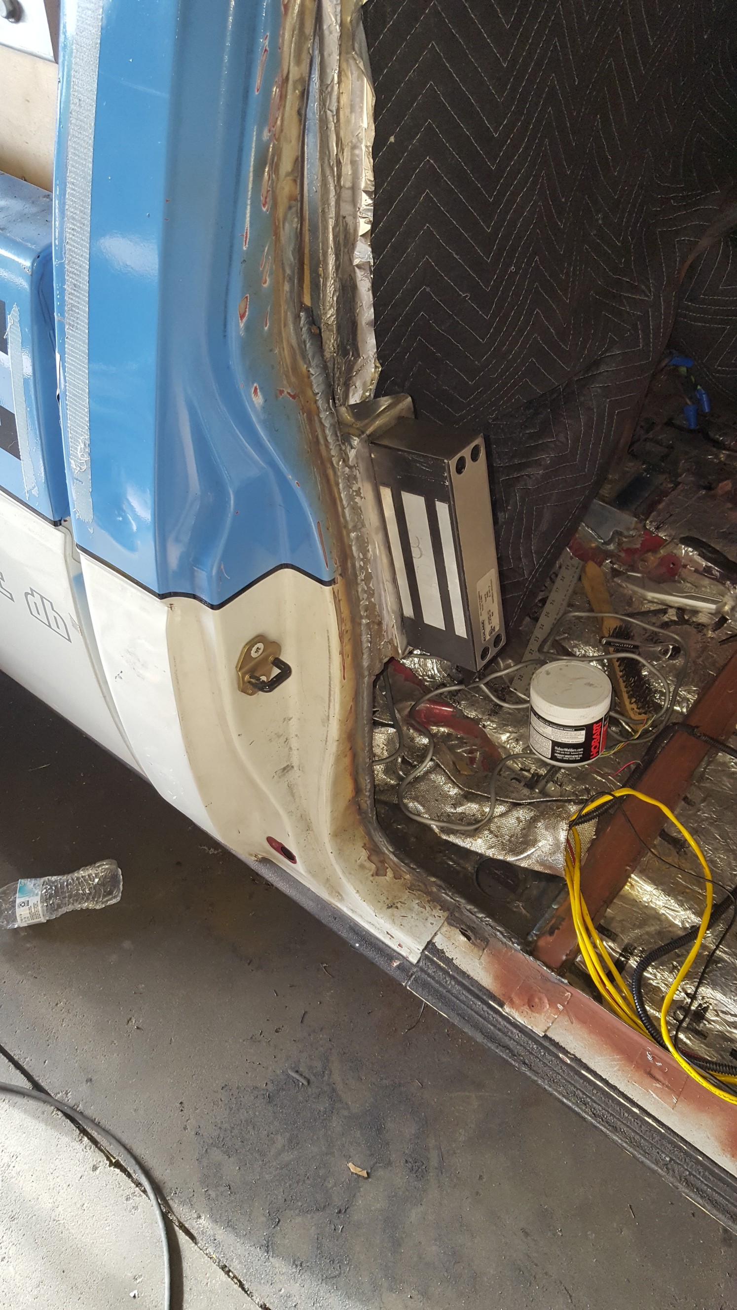

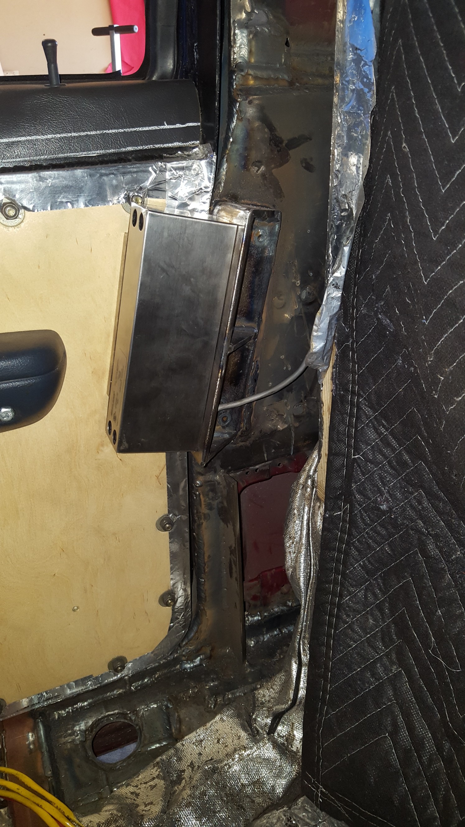

Electromagnetic door lock mounted
Fits like a glove!

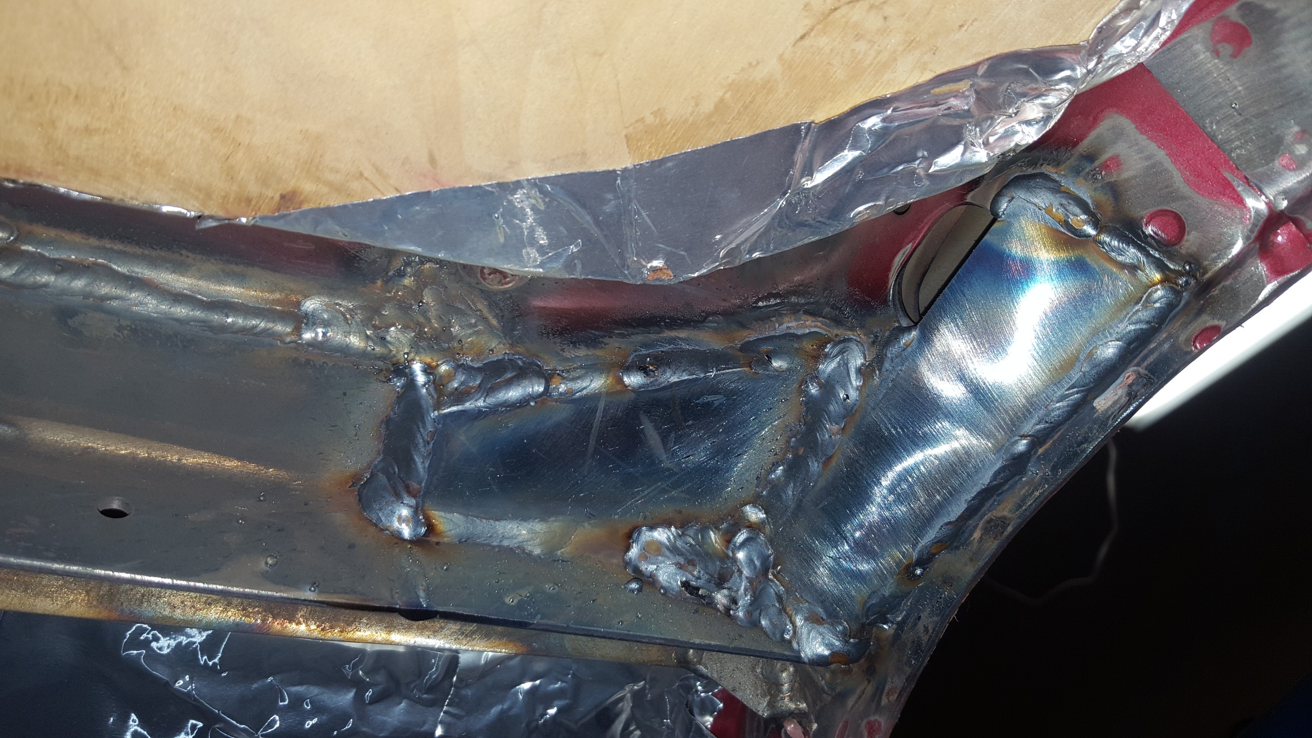

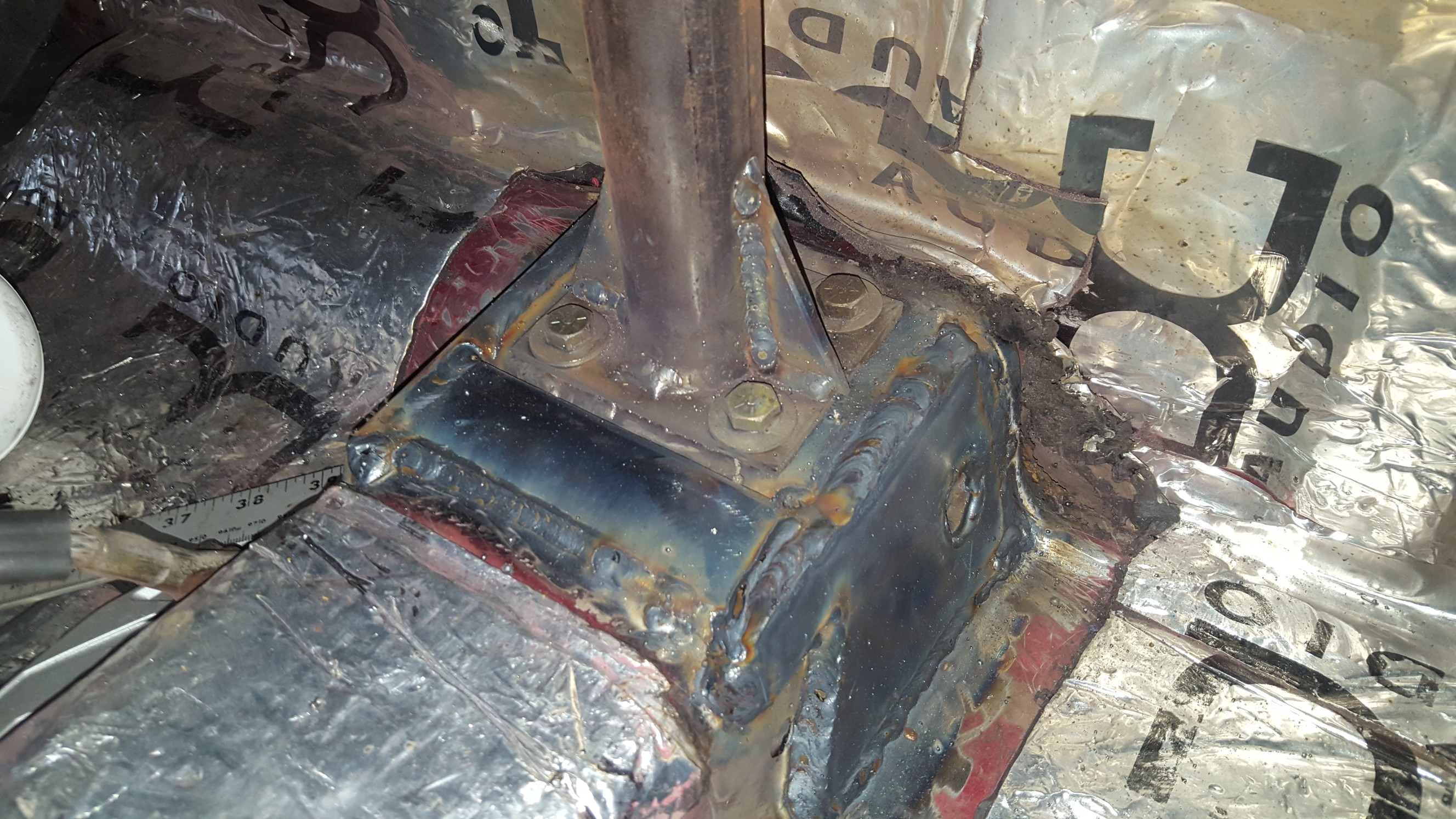

Some more roof bracing on the passenger side

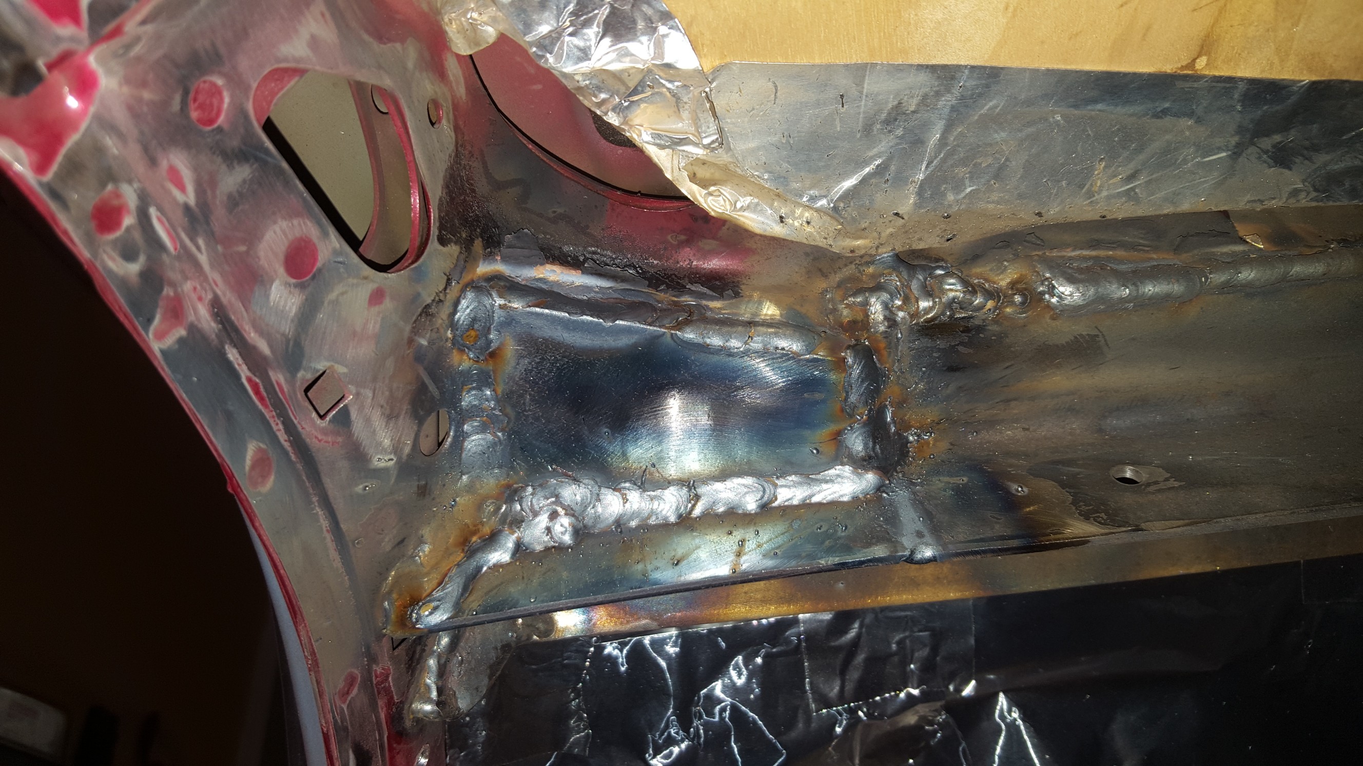

More bracing on the driver side

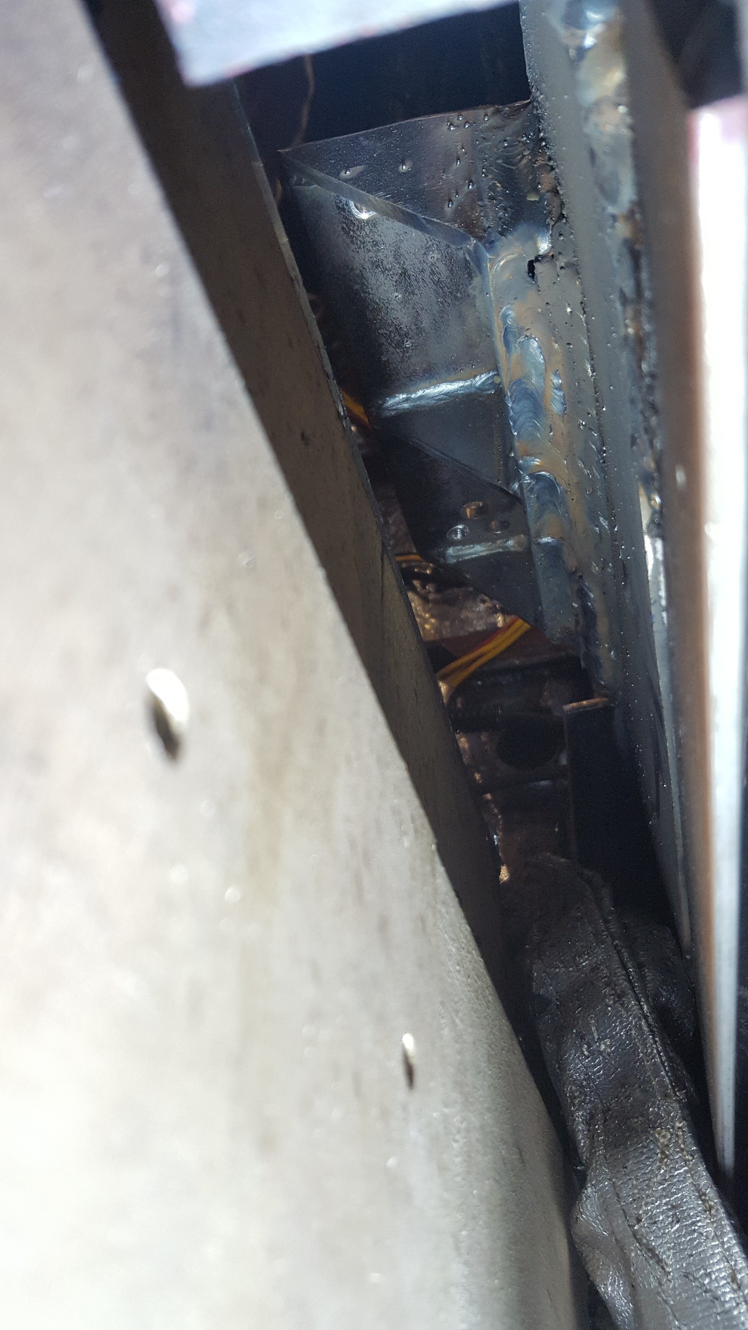

Finished adding more bracing for the lower stripper pole mount
The electromagnetic door lock seems to be a huge success! I'll post videos tomorrow!
I bet that magnet makes a nice clunk when it grabs the door. lol Good stuff!
Pioneer 80PRS
I'm digging the welding in the upper corners near the windshield.  Thats a weak point on my car and I'll probably have to beef it up sometime in the future.
It's actually surprisingly quiet!  The actual magnets are cast in poly urethane (aside from the actual surface) so it seems to absorb a bit of the noise
59 minutes ago, 8ten8 said:
Saw the recent vid this mornin, superman strong...damm. Well done dude

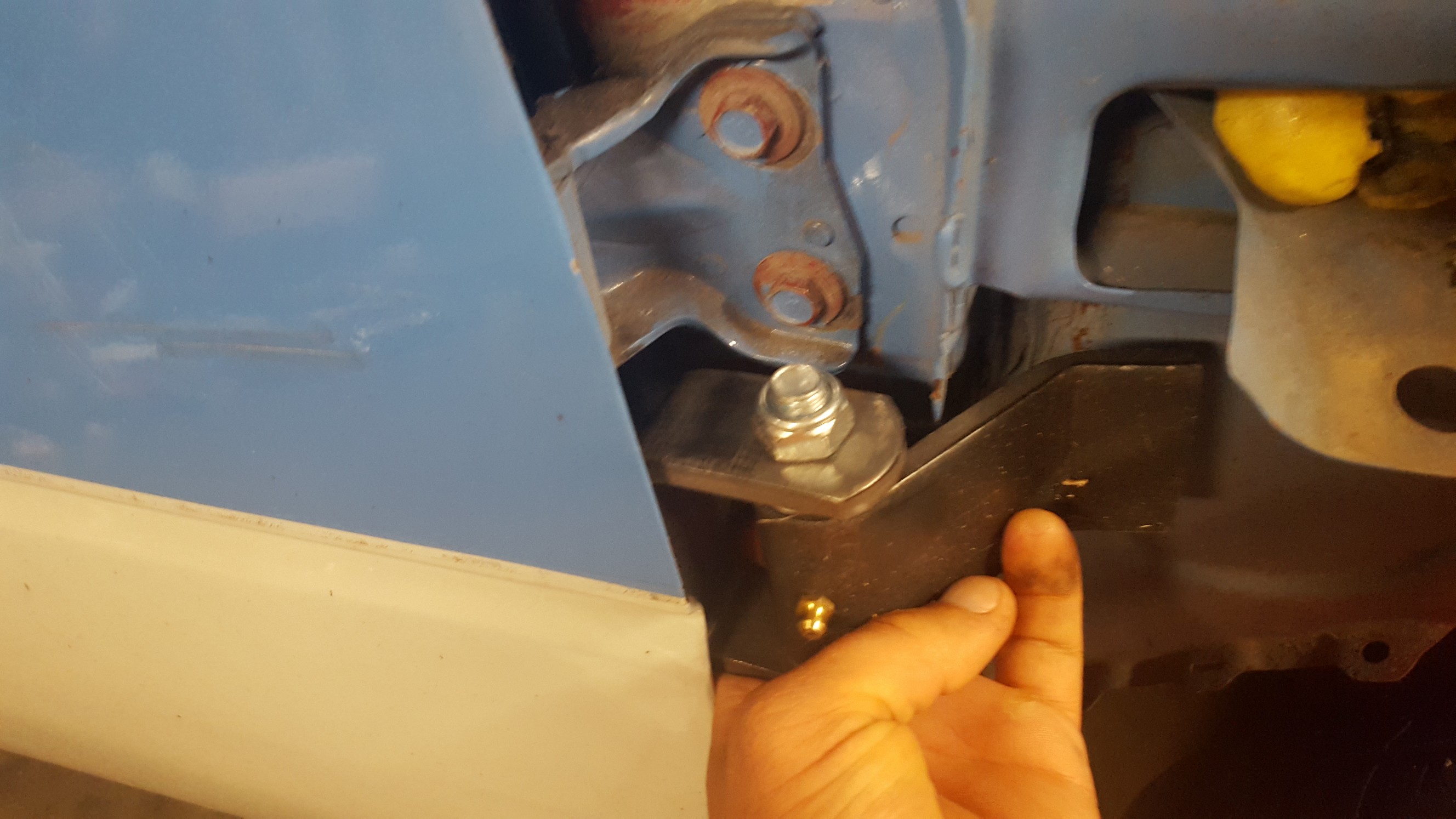

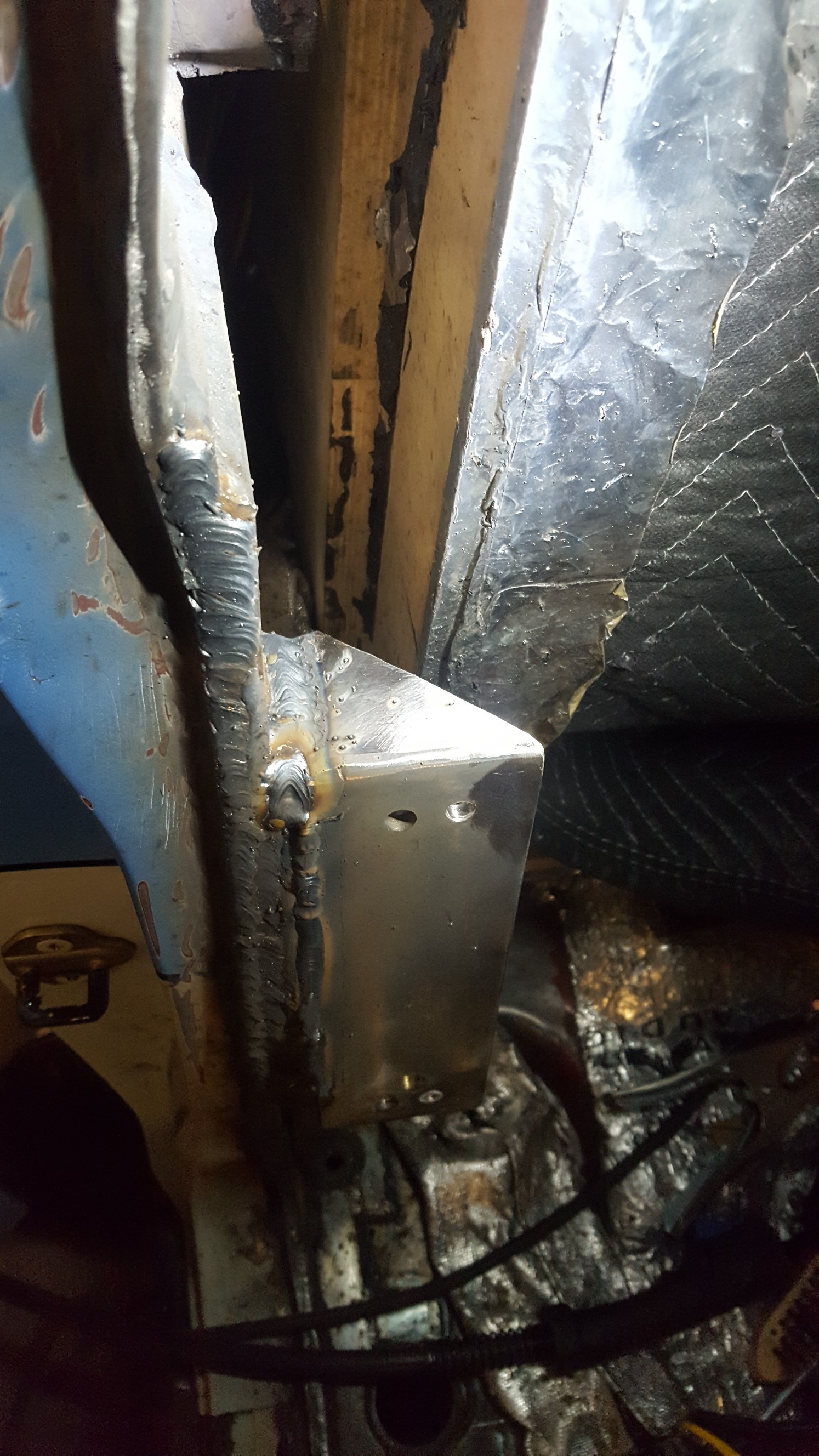

Thanks man!  Only thing I'm worried about is flex from the factory hinges where they mount to the body.  This could potentially create an off-axis force on the magnet which could potentially pry it open.  Although I will be addressing the hinges in the very near future with these bad boys!
thanks man!  I've got some more work to do up there but I'll probably wait until next time I tear into it...I've got to get to work on the rest of the changes so the truck is done for the 3x ISPLL show I'm co-hosting Sept. 3rd lol.
